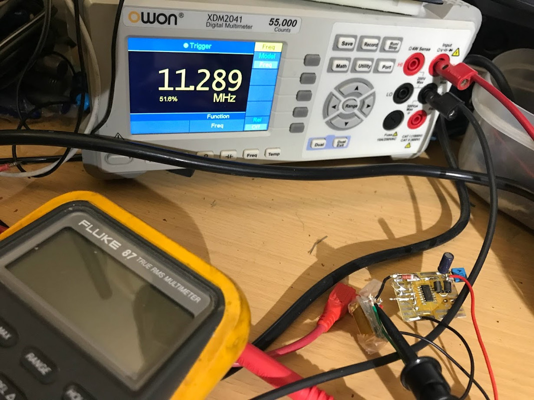

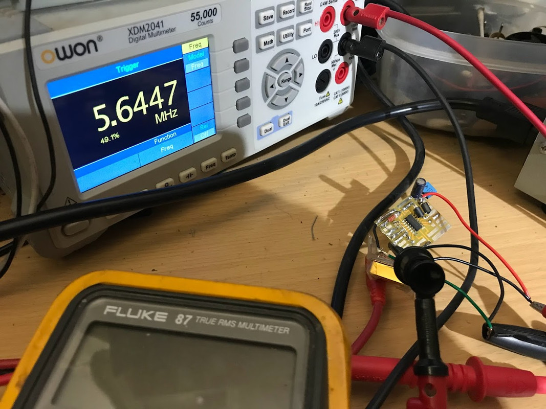

Almost there! Tested the Napier EDN /2 with a Vanguard 11.289 MHZ (5v common psu for both /2 and osc). Working as it was supposed to (properly dividing by 2).

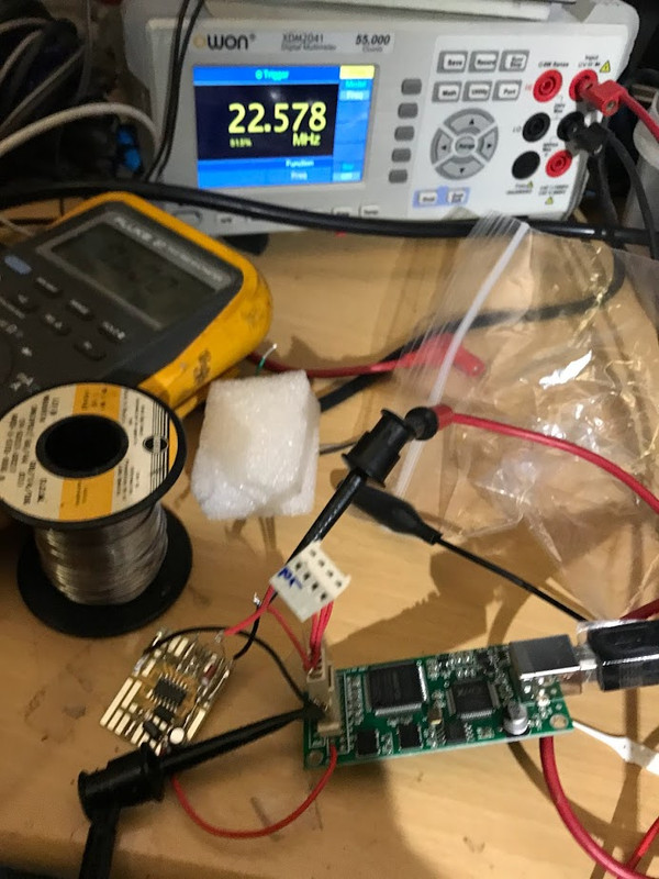

Then with USB-I2S adapter, but with the same 5v psu as on the Chinese 1305 board. All was not well ... weird output "/2" freq around 9.xx Mhz and fluctuating/unstable (input freq to /2 was normal at 22.578Mhz). Something not right; I suspected some sort of grounding issue.

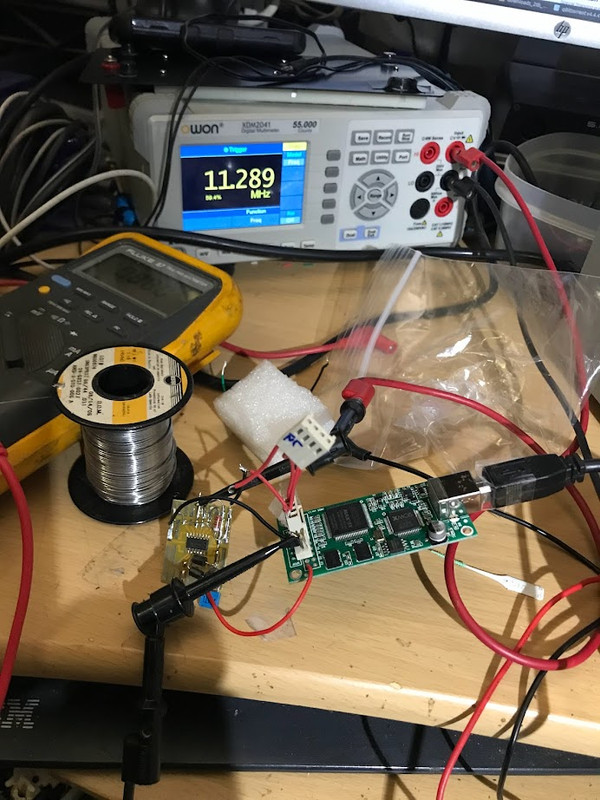

Using only the adapter for power (3.3v), the /2 is working normally. See photos.
But having the adapter powering the /2 is not quite ideal although I have gone to some lengths to decouple the pwr input (caps and ferrite).
