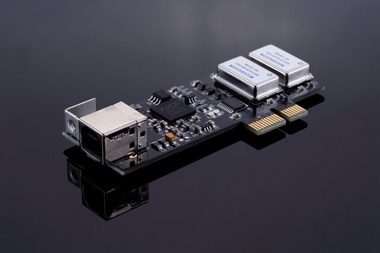

i tried some other DACs at home and i found that my Gustard A20H is nice but other DAC are using better Xmos interfaces, therefore i got higher resolution. i set my resolution at the interface setting in Win10 and let the DAc not oversampling, so the job is done by the laptop cores Core 5i.

now i looked at my A20H and see there is a "old" XMOS U8" interface, other interfaces are faster and can handle better resolution. SQ getting better with all DAC i tested.
is it possible to find a XMOS pcb to just swap my old XMOS interface board and use a newer one? in the pic you will see the pcb which is implemented in my A20H.

Newer XMOS chips do not necessarily provide more 'resolution.' They may have more processing power that can be used for processing more than two channels and or for processing such as MQA unfolding. Depends how they are programmed.
Resolution is related to both sample-rate and bit-depth. Resolution in a dac may be limited by various factors of the design. Usually, its not a limitation of the XMOS chip, although in special cases it might be. More likely it could have to do with design of the DAC clocking system, the stuff on the dac board that clocks the dac chips.
Thank you Mark for your comment. as i understand you right its the parts around the DAC , so you see no change to modifiy my DAC.
your statements are ok for me but we (all tester) can reproduce the better SQ at higher resolution clearly.

DAC sound quality depends on many factors. It turns out that higher resolution tends to work worse, sound worse, when sample rates are too high for the particular DAC technology. For AK4499, the sweet spot seems to be at DSD256 (clocked at 22.5MHz using ultra-lower jitter clocking system). AK4499 can go up to DSD512, but sound quality tends to degrade at that sample rate. I don't bother with 768kHz PCM at all either. The required clocks for that sample rate if using AK4499 have worse phase noise and will degrade dac sound quality as compared to a lower sample rate.

Not sure how you are distinguishing the difference between the two types. DACs are engineered to a price point. There are always engineering trade offs to be made in deciding what features are likely to be most important in the particular price-point market segment. Marketing people may have a lot to say too, depends on the company structure. Also, its cheaper to add software/firmware bells and whistles rather than more perfectly engineered performance. As performance goes up, it costs more and more for smaller and smaller improvements.

Want to change MCK on my XMOS-based adapter to 256fs (which is not default in firmware).
MCK (default on the USB-to-I2S adapter): 22,579 Mhz (512 fs)
MCK (needed): 11.289 Mhz (256 fs)
So the USB-I2S is spitting out MCK at: 512fs (default)
Not sure why the default MCK freq. was programmed in as 512fs and not ,say, more common 384fs ?????

What XMOS based adapter is it? Does it have a JTAG port?

MCLK is usually 22/24MHz or 45/49Mhz for USB boards. If you want 11/12MHz you would probably have to follow the standard MCLK output with a frequency divider. You might also have some issue with the I2S signals too. Depends on how you are using it and what your dac needs. Also good to be aware the some frequency dividers invert phase, so you might need to fix that too.
Otherwise there is at least one USB board on the market with a JTAG connector that you re-flash with firmware using XMOS software tools. However there might be some learning curve involved in that case.
