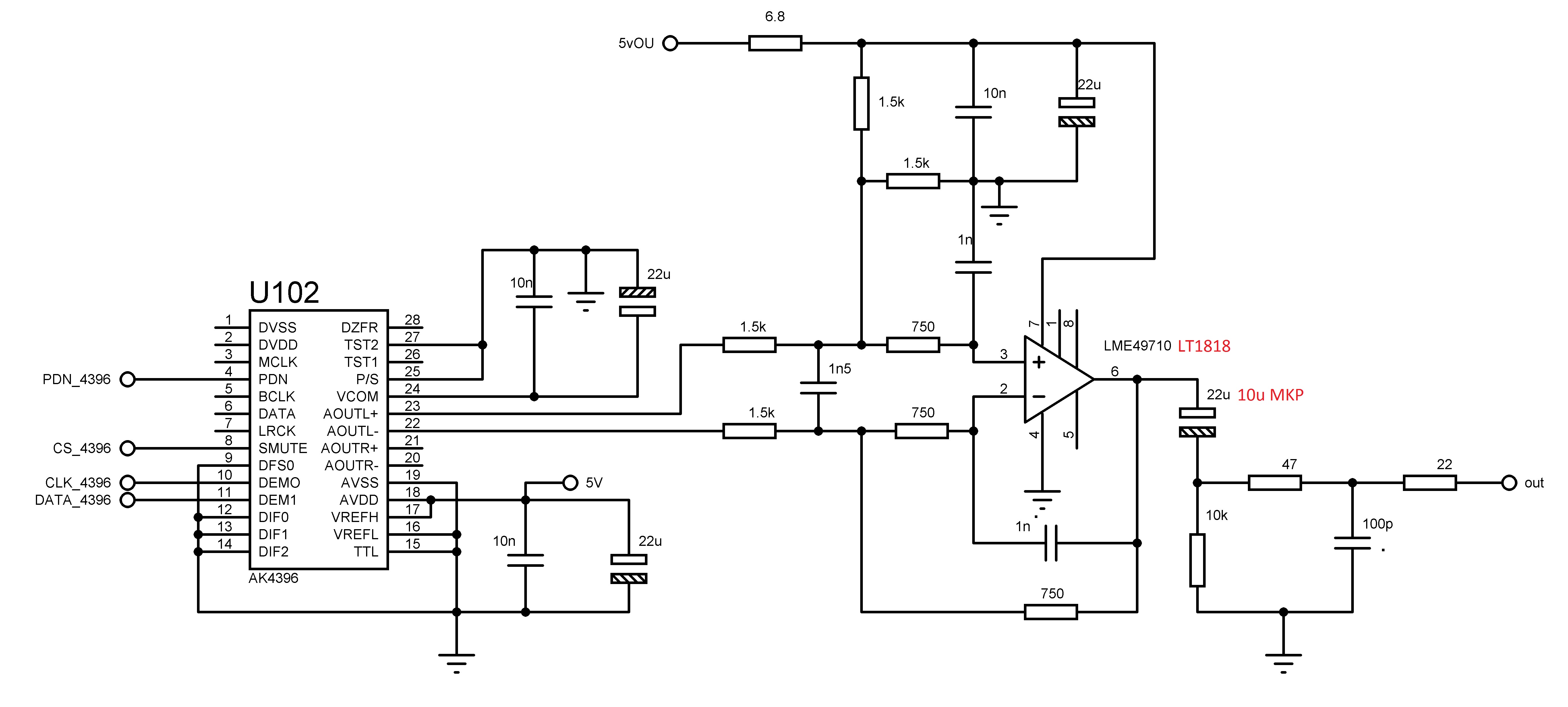

With the LT1818, did you have to change any other parts for stability. Can you also describe other changes?
There is no need to change anything for stability..
I said already, only two things changed, opamps and output capacitors..

Did someone tested what is playing better, sharp or slow roll-off filter..
At first it seemed to me that there is no difference, so I left sharp.. yesterday I changed filters few times and listened more carefully.. now it seems that there are small differences, slow plays better..

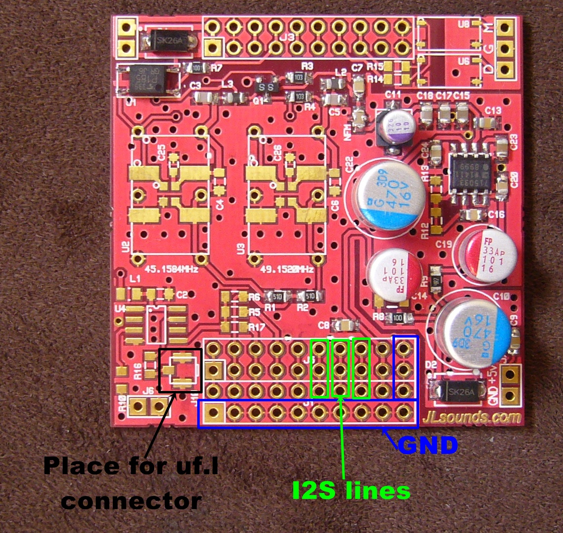

Do you plan with you excellent actual board for some better output layout for the gnd outputs : not only one pin 11 Gnd but one gnd pin near each I2S output pin to allow each I2S signal to have a closest and individual return path= less jitter, better shielving & EMC like uf.l connector allows ?
My understanding after some exchange with JLsounds is you have just a trace on the actual pcb for an uf.l conector for the MCLK signal !
Thanks for your answer about that, I'm sure some could appreciate this little modification for the actual board as some others could consider the board if exist for the TDA1541A as your board is well priced.

I attached a picture of the new oscillator daughter board. There is no option for TI regulator, because according to the tests wasn’t as good as ADM7150. On this board there is uf.l connector, but if one wants to use it, have to solder and a buffer (there is a place for the buffer on the oscillator board).

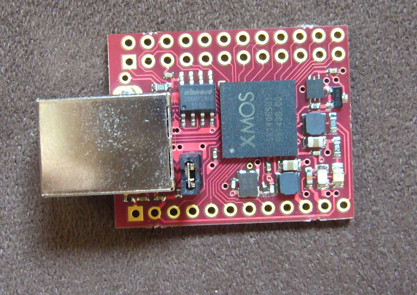

As for advanced diyers, I’ve designed OEM module, based on XMOS U series. As one can see from the attached picture the board is “naked” – without isolation, reclock and oscillators, this would give much more flexibility during the realization of the diyers projects and on this board next to every I2S signal line there is a GND

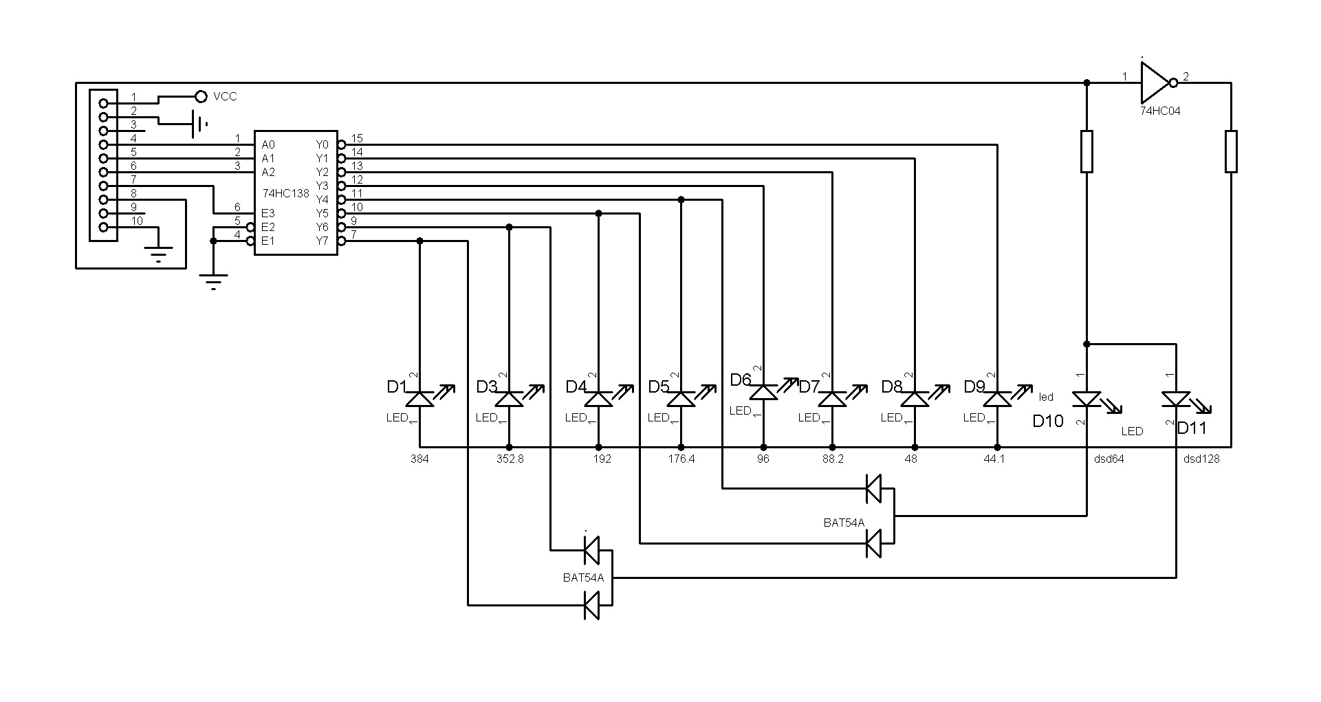

I attached you a scheme for full indication 🙂

I don't know but for myself about the real need of a board for the TDA1541but I surmise some could be interrested if the layout & pricing please them. I suggest here to ask in two threads I opened for beginners like me about the Distinction-1541 coreboards (which have both uf.l I2S inputs connectors as VIAS in a SGSGSGSG -Simultanous mode possible- layout for its input data signals. May you agree I ask them and link to this thread for showing their interrest by asking boards (interrest grup buy) ?
It could give you pragmatic to see if it's enough to continue or not on the TDA1541 path ! I believe a pricing of the boards could allow them to decide more easily.
Wow.... the clock board and oem XMos photographs look great. My understanding is the clock board is maid for the OEM module : am I right ?
Do they allow simultanous mode or the advanced diyer has to programm the Xmos ?
If there is a plan to stack the clock board and the actual JLSounds simultanous USBoverPCM clock board (simultanous mode for AD186x & PCM dac chip family) how is solved the I2S layout output connection to the clock board ? (how are they connected together ? Any photograph ?)
According to me the good actual board seems good enough but this problem of gnd layout to connect it with most dac boards who have GndSignalGSGS I2S connector and not just GSSS as the actual JLSounds board, also because RF signal works better with a close signal return path for each RF signal... btw this is my understandings as a beginner when reading some entries on Diyaudio 😱)
Thanks again Joro for those nice exchanges with you and JLSounds, let me know about the links here if wanted.

Look at the photograph with the little uf.l connector board stacked on the Joro I2StoPCM board : exactly what I need if JLSounds don't want to increase the quality of the output layout with GSGSGSG grounding arrengement : NOS 384 AD1865 with built in LDR : it don't resolve the unique output gnd pin of the board but help to provide bigger length with coax uf.l wires....
Anybody knows where this little board can be sourced ? A diyer work ?
