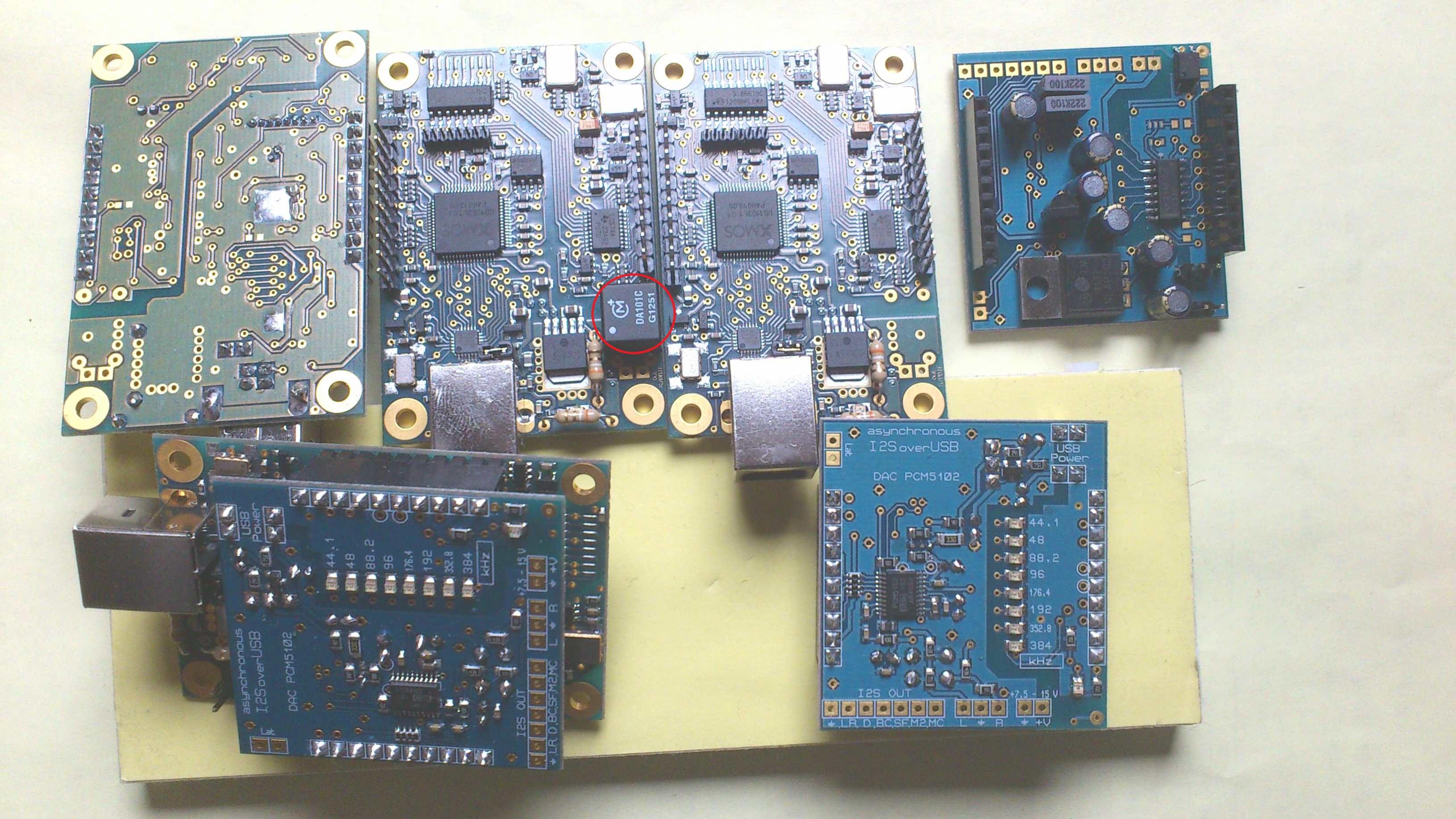

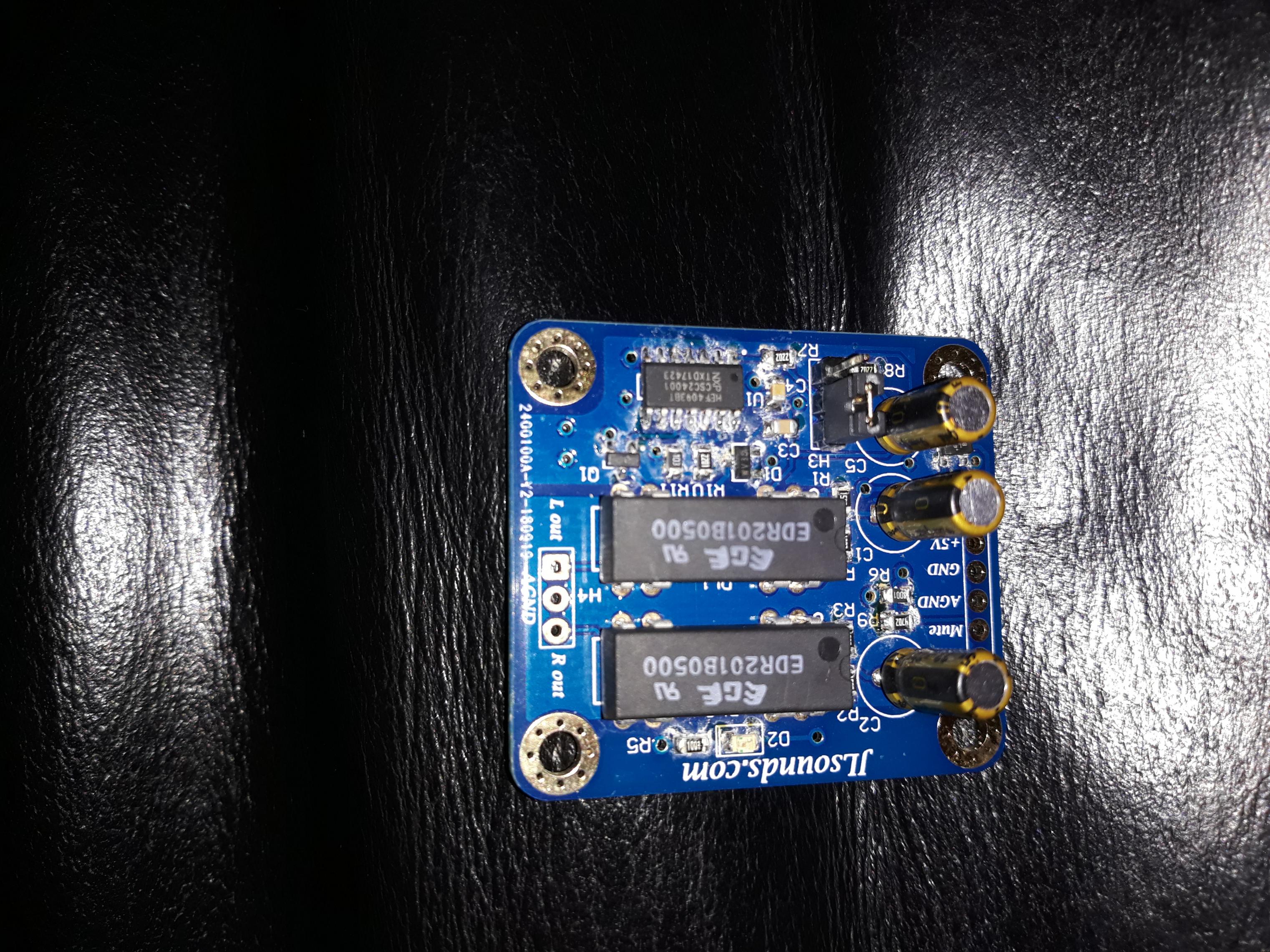

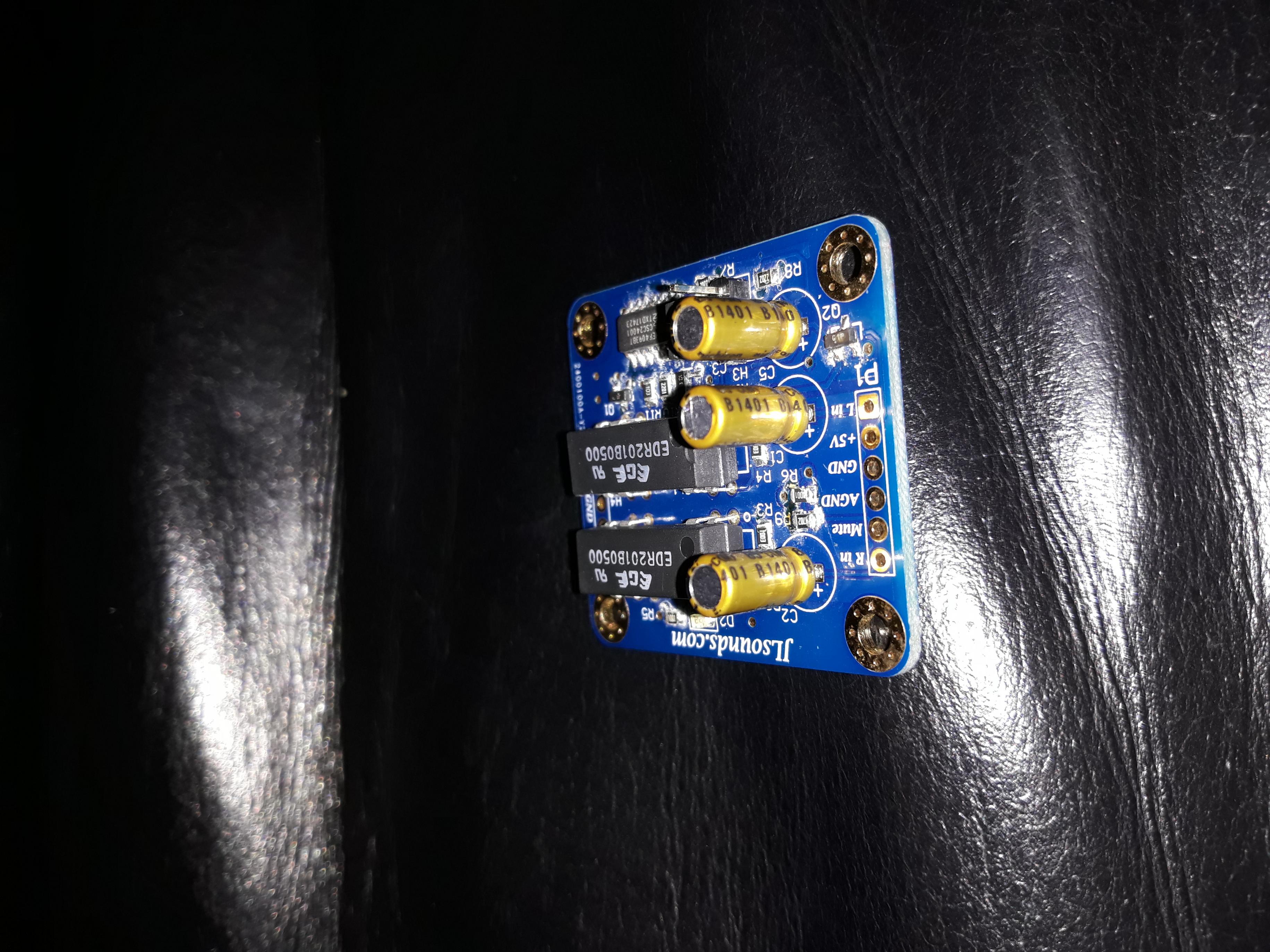

Looks like input signal goes between legs of C1 and C2 directly to the relays..
I might be wrong, however looking at these pictures it looks like Rin goes to + of C2, then from - of C2 it goes to the relay. Symmetrically, Lin goes to + of C1, then from - of C1 to the relay. I tried with an Ohmmeter and this seems to be confirmed.
This is double-sided or multi-layer pcb..
Yes
There is layer for analog signal, another for power..
In fact Rin and Lin are respectively left and right input signals, and ... they go to C2 and C1 caps. Then from caps to relays. The two pictures are very high res. You can enlarge and double check yourself.
Opamp board have relays without signal caps, there is no reason for using them on this.
I agree. However, this is it.
In any case, no point continuing arguing on this without a schema. 🙂

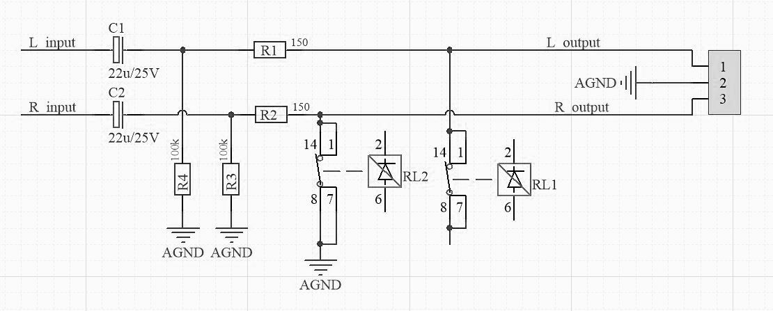

I have info that those caps are on signal path. They are for safety a guess - i think that Mute circuit connects the output with ground when i2soverusb detects change in sampling rate to avoid pops and clicks. Some output stages do not have output capacitors and it is possible that there would be problems when connected directly to the GND.
I think this could be solved in another way, without those capacitors.
Hi fellows,
It's been a long time since I wrote in forum, sorry about that.All questions asked by mail are answered by Lyuben.
Regarding mute scheme - for C1 and C2 caps - they are put for preventing, if previous stage has DC signal on the output and the stage after mute board works on amplifying 0V DC (i.e. DC amplifier), in order not to get in trouble.
If from the stage before mute, there is no offset, then C1 and C2 caps can be shortened. The mute signal path is parallel on output signal, i.e. AC signal doesn't come through relay. The output signal is shortened in order not to overload the relay also the stage before mute board, there is 150ohm resistor on signal path. This means that even 15Vp-p signal won't overload the relay. There is no interruption on signal path - I did this on purpose. cause I think (and hear) that every one relay on signal path adds its' mark.
I publish the scheme here to be more clear.

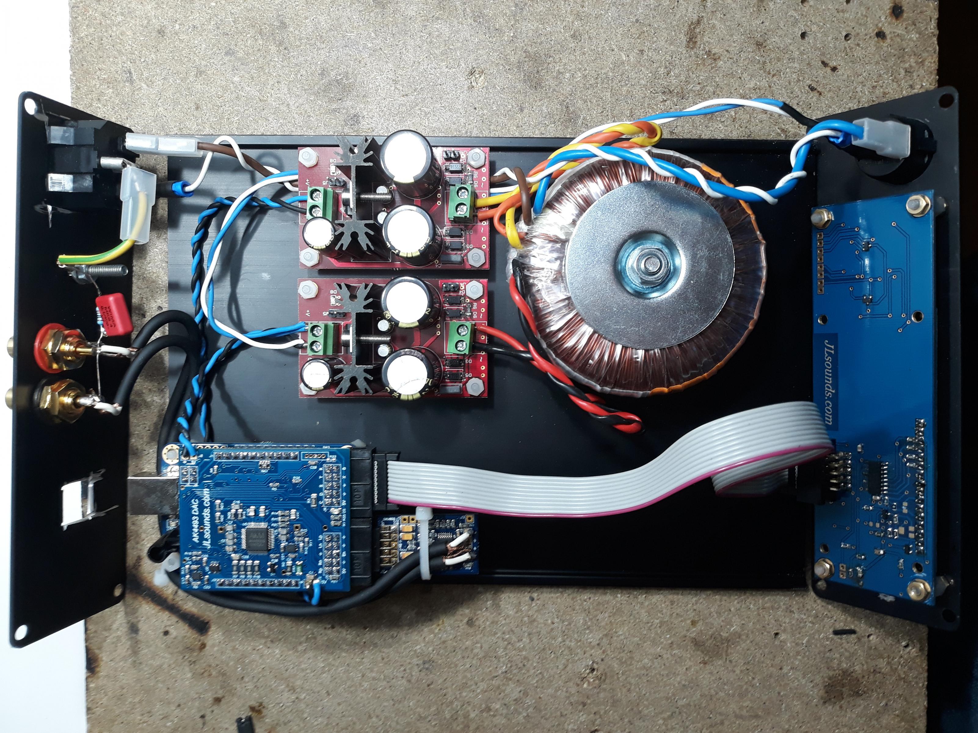

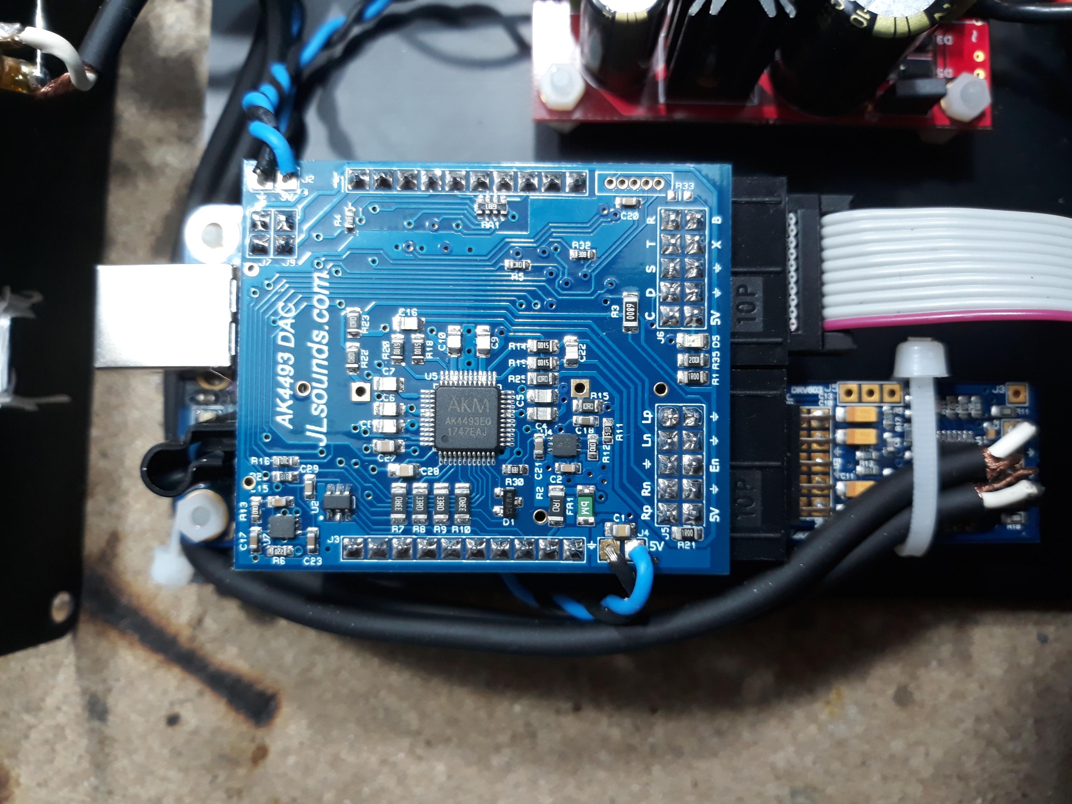

I finally finished my build as well.
It has I2SoverUSB v.III, AK4493 board, DRV603 Filter, OLED control, and dedicated external power supply for USB, and oscillators/reclock/AK4493/filter.
I believe its audio quality is impressive 😱.
