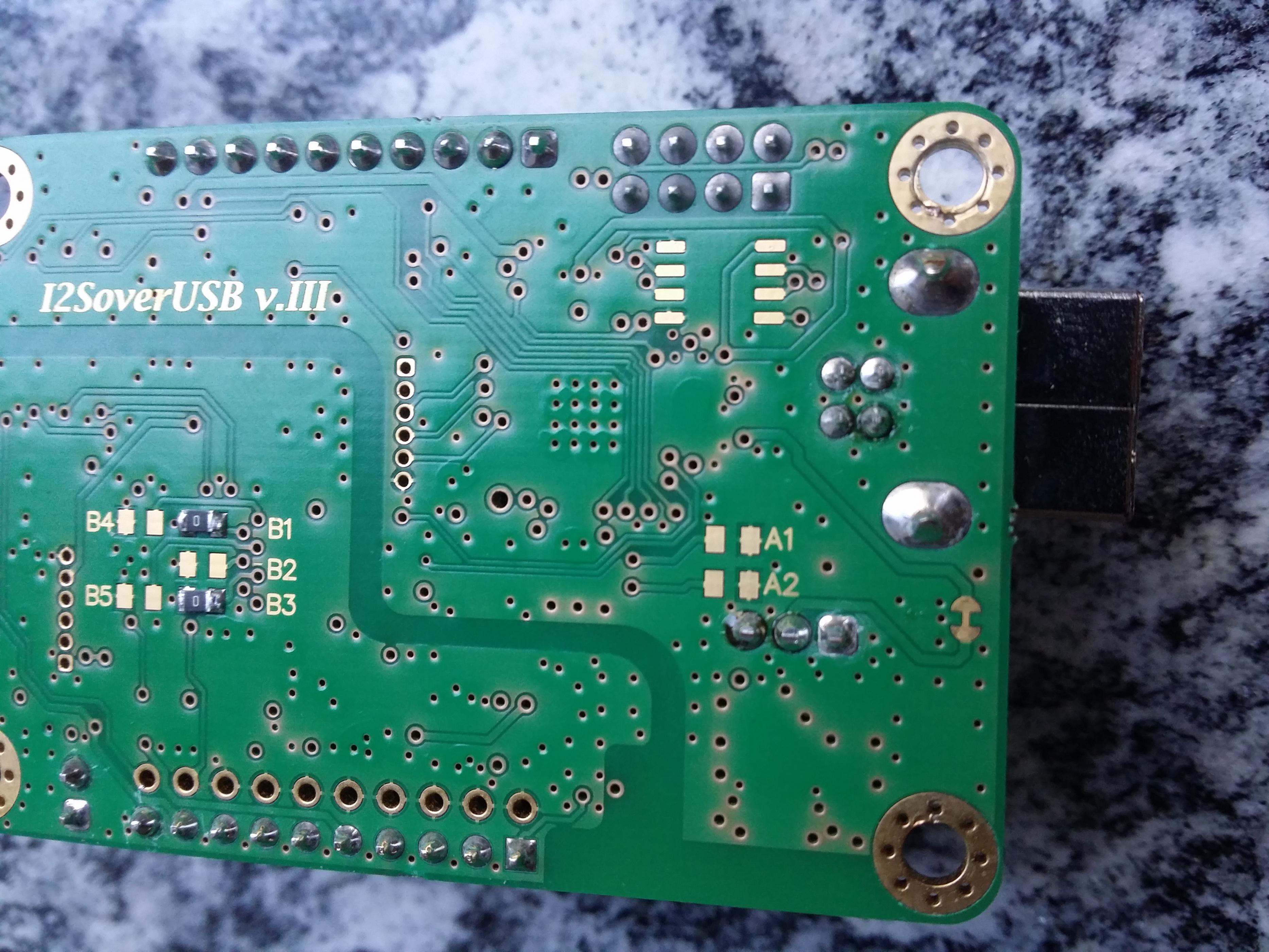

I bought I2SoverUSB and it worked nice. Today it stops playback every 2-4 seconds. Any ideas?
It looks like there is something burnt on the bottom of I2SoverUSB
attachment.php
Still I'm not sure why it works but only for some seconds. Play/pause makes it work again for some seconds.
It is connected as following: USB connection from pc to I2SoverUSB, AK4490 Board on top with Power supply connected to J6. The power supply is fed by 8x 1.5v AA Batteries. Then LCD board and DRV603 board to AK4490.
Did I break it? How?
