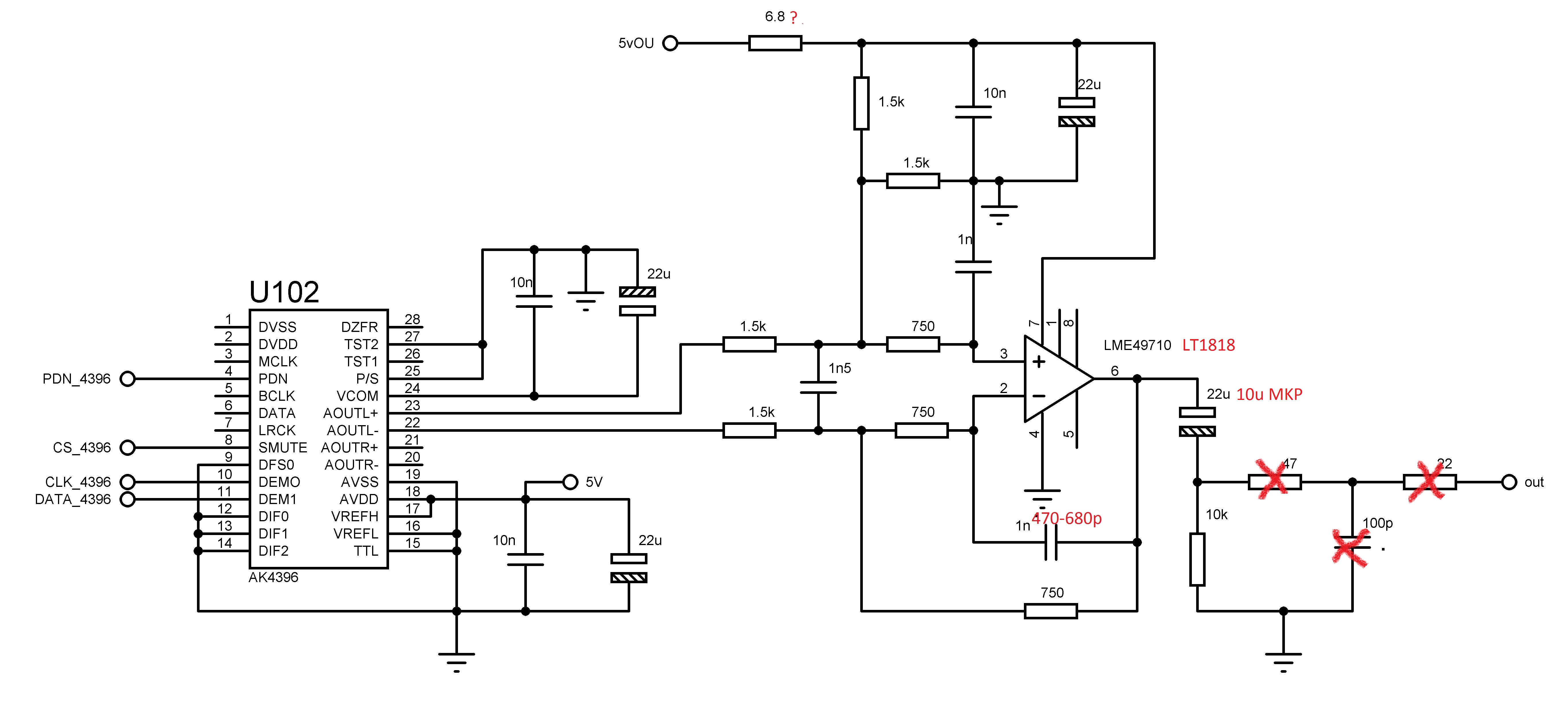

Two days ago I received the AK4396 board.. I am generally satisfied, great device compared with various Chinese stupidities that is offering and praise here..
I changed output from the opamp.. took out electrolyte and RC filter, now in output is only 10u polypropylene.. sound is little better than original..
I was wondering if anyone else changed something around the analog part..
My idea is to change LME49710, thinking to put LT1363 or LT1818, second one seems more appropriate.. I would also reduce the capacitor in the feedback loop, instead 1n I'd try 470-680p.. also, the resistor 6R8 seems completely unnecessary, except that further drops already low voltage..

Replaced opamps couple days ago .. as expected, works better..
I was quite pleased how it sounds with LME49710, but I had to try LT1818..
Practically, only two changes was another opamp and output capacitor..
I am so pleased with sound and do not plan any more changes..

With the LT1818, did you have to change any other parts for stability. Can you also describe other changes?
