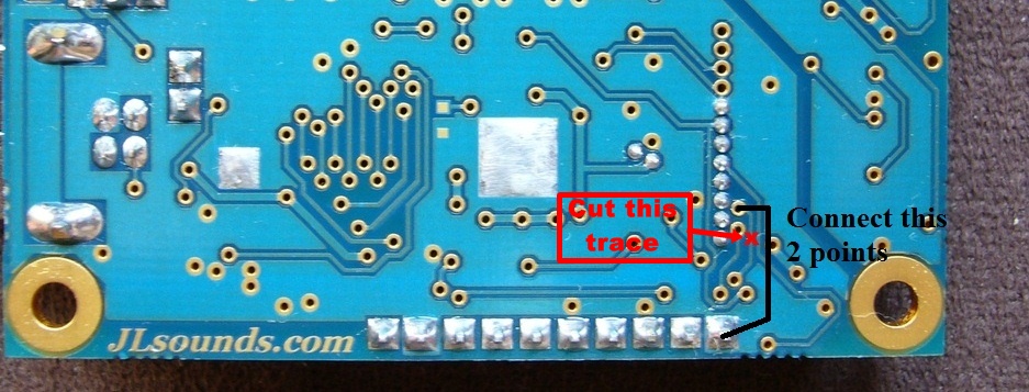

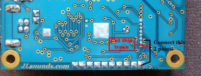

Several people using WaveIO have reported a SQ-improvement when disabling SpDif on their boards. Sincs i am using I2S only, what are the otions disabling SpDif on your board?

You can disable S/PDIF, you have to cut the trace marked with red “X” and connect shown points, please see the attached pic. You have to know that the additional firmwares for DACs, which are configured with pin3, won’t be working, because this channel is used for Data R.
The intervention is before the galvanic isolation, i.e. there is no S/PDIF signal at/around the oscillators and reclock.

I use your XMOS-board in combination with the PCM5102-board, each fed by a separate linear powersupply. With your S/PDIF-'fix' i hear a small improvement, like the music sounds more free than before.

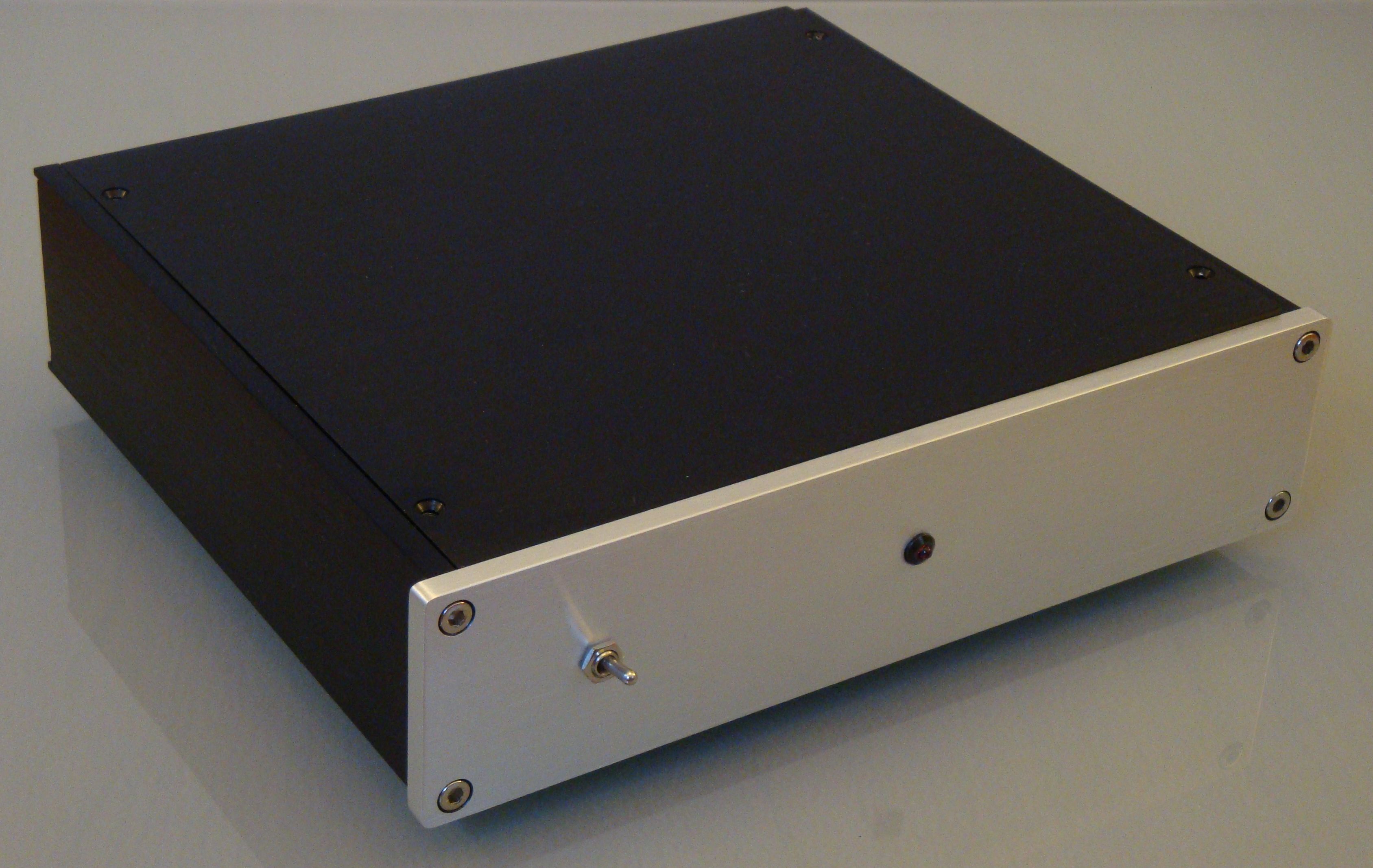

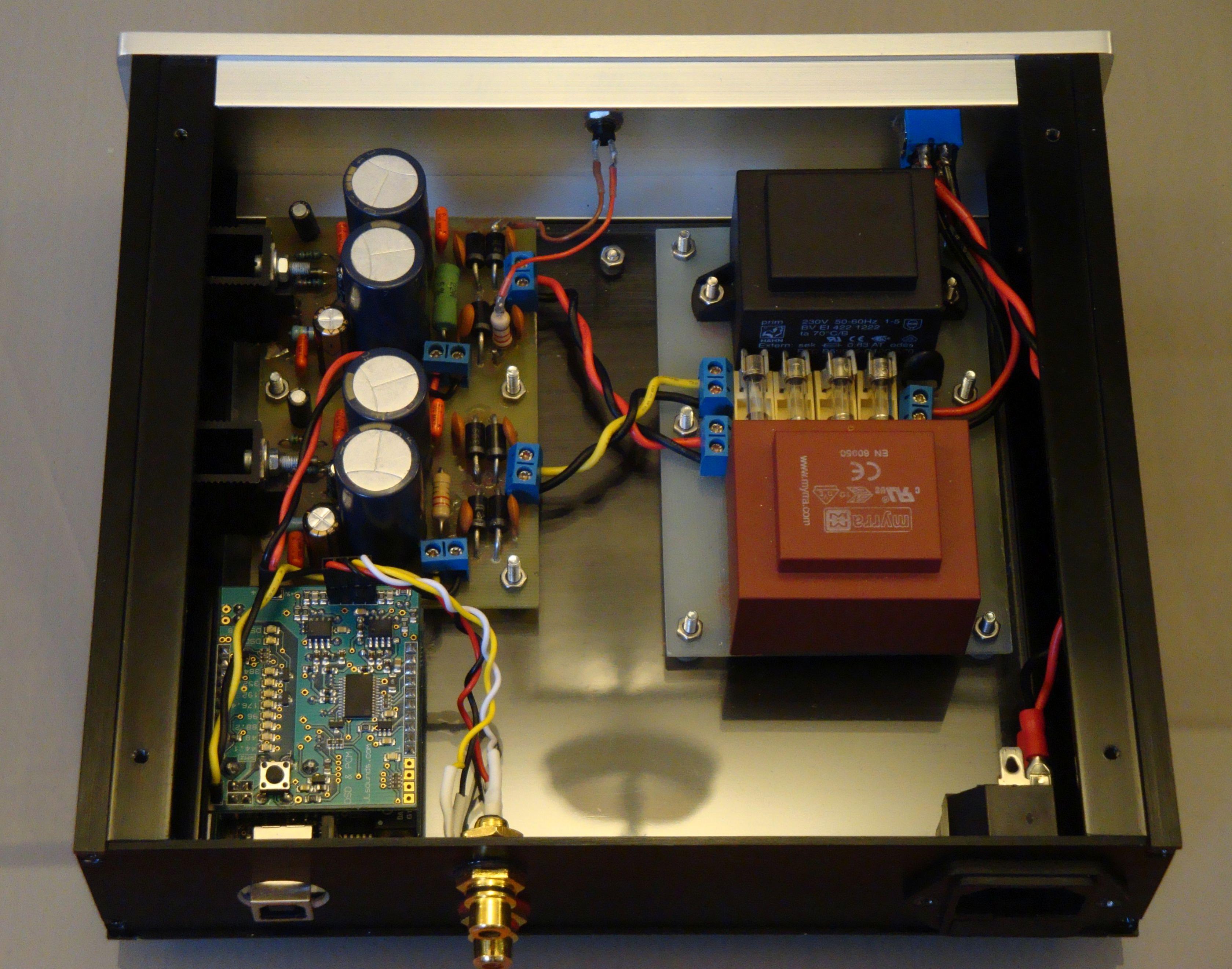

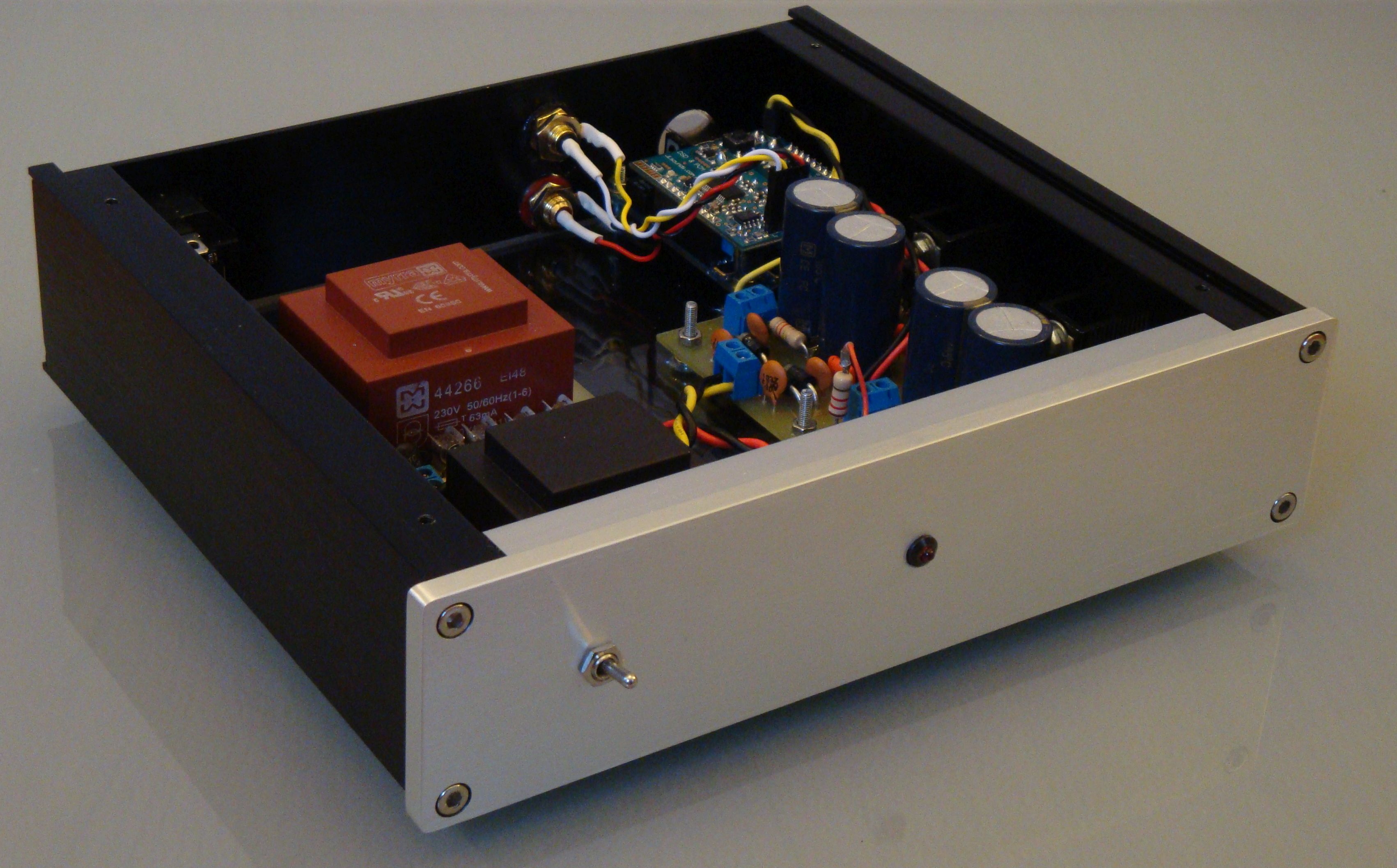

Nice implementation dioklecijan.
What case are you using?
I bought on ebay from sellers doukmall with warehouses in Germany. Dimensions 220 x 52 x 191 mm.
Thx. Found it.
I'm glad that my son helped you. Your implementation looks very well 🙂

Thank you for your feedback. There is no problem the S/PDIF to be turned off by software.With your S/PDIF-'fix' i hear a small improvement, like the music sounds more free than before.
This is my by implementation of this excellent device. All the following instructions are displayed on the JLsounds website. Sounds great! Thanks Lyuben.
