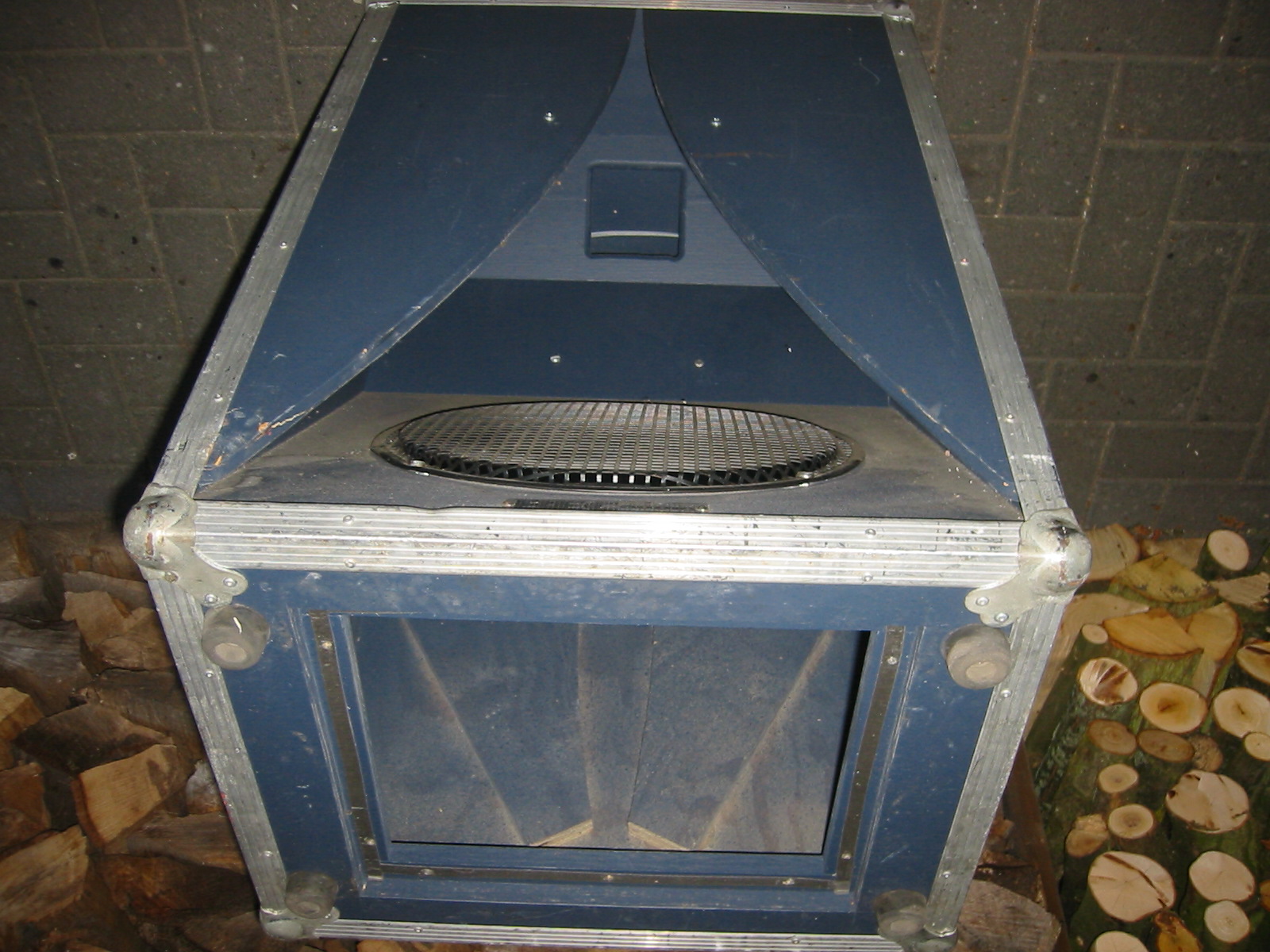

rear mounting was how KK-Audio, Acoustic Control, Transylvania Power, Westwood, and others built the X15 size bass cabinet.
I think the one below was a "BEC2" by the late Ernst Beck under license from Transylvania Power. Although made of 18mm Russian birch plywood, it was necessary to brace the aperture's wings with 3/8" steel allthread bolts which run from the back through the port panel then through the wings to minimize modulation effects from wings' movement.
This cabinet's internal vent is much smaller than that of Acoustic's 115BK, whose vent was around 3 " high by 9 inches wide. I suspect tuning is simiilar
as the front chamber's aperture (being narrow at the top) has a major effect on system tuning.
These are excellent little cabinets to use in place of midbass horns.

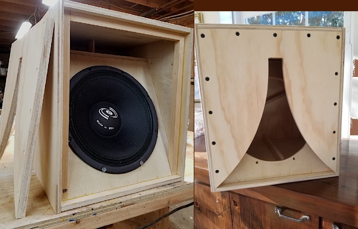

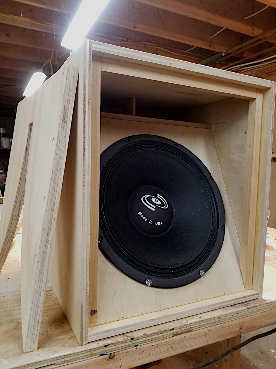

I had an alternative in my mind for venting the above mSK8 at the stub's apex, like your 12" Kube, but the aperture was not set in stone, it would have been a provision to tune the stub in this case.
I think I was on a similar path that led xrk971 to the XKi with that one.
What are the specs on that 12" Pyle?

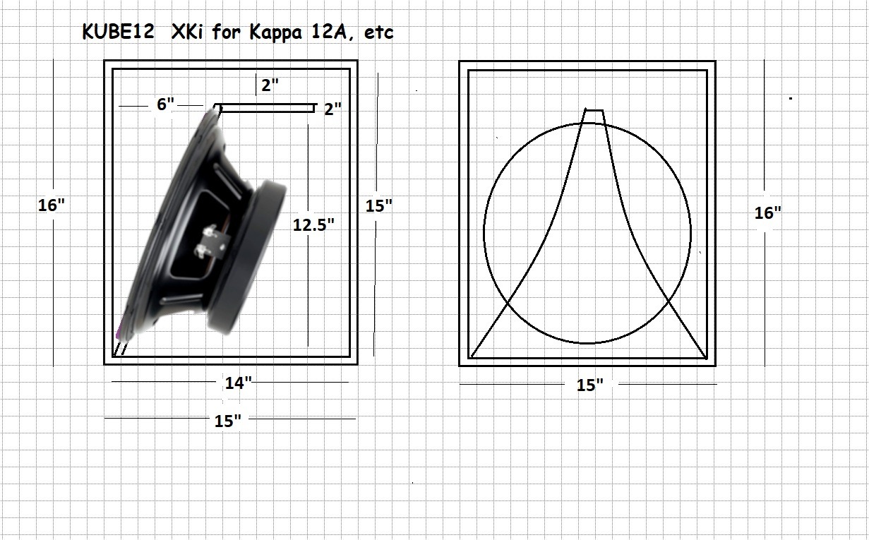

hi X--tis not in my sweaty little hands yet---hoping it has some energy at 70Hz (?)
hi IG81 -- love that stub as it comprises a good chunk of the front chamber volume plus can null a cavity peak. Since you have brains and skill to make intelligible plans, might you sometime draw one for this KUBE12? It would be cool to have more K-ish plans and perhaps consolidate them from varoujs threads and the"compendium".
probably due to my terribly poor drawing, the aperture gap appears to be wider (?) than the one inch draw. That may be helpful in learning and seeing where it tunes, plus could be a "best" aperture.

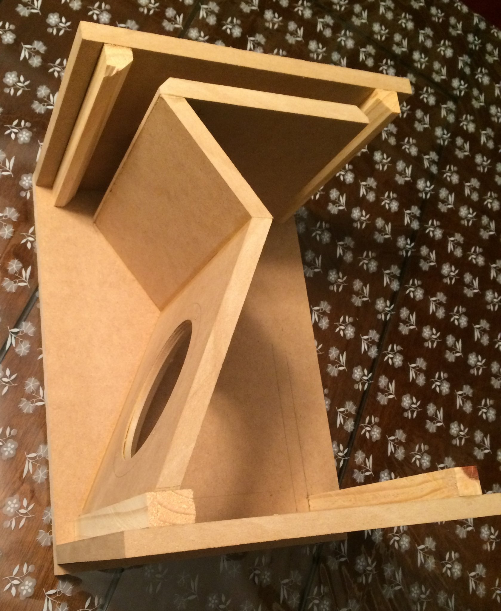

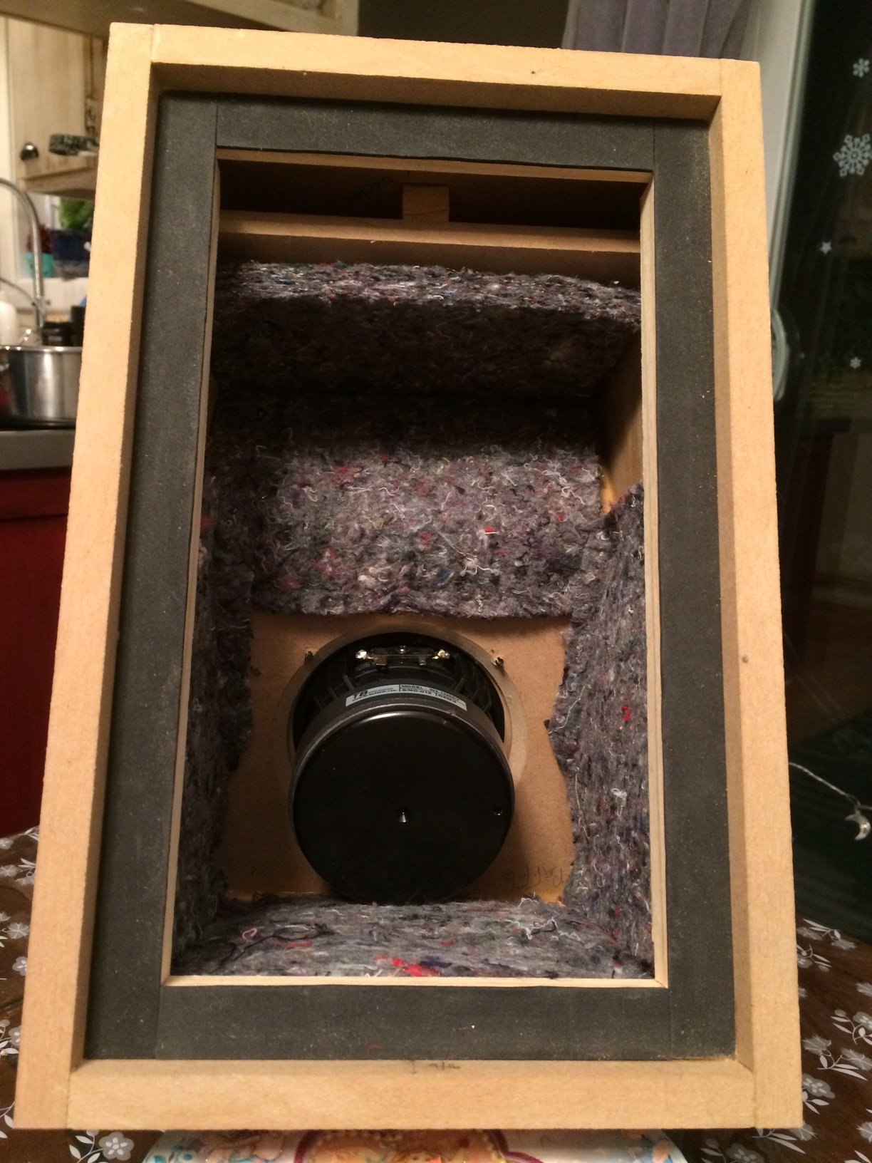

Here's a little something I'm putting together for fun, as well as to have something different from my TK6, for purpose of comparative analysis.

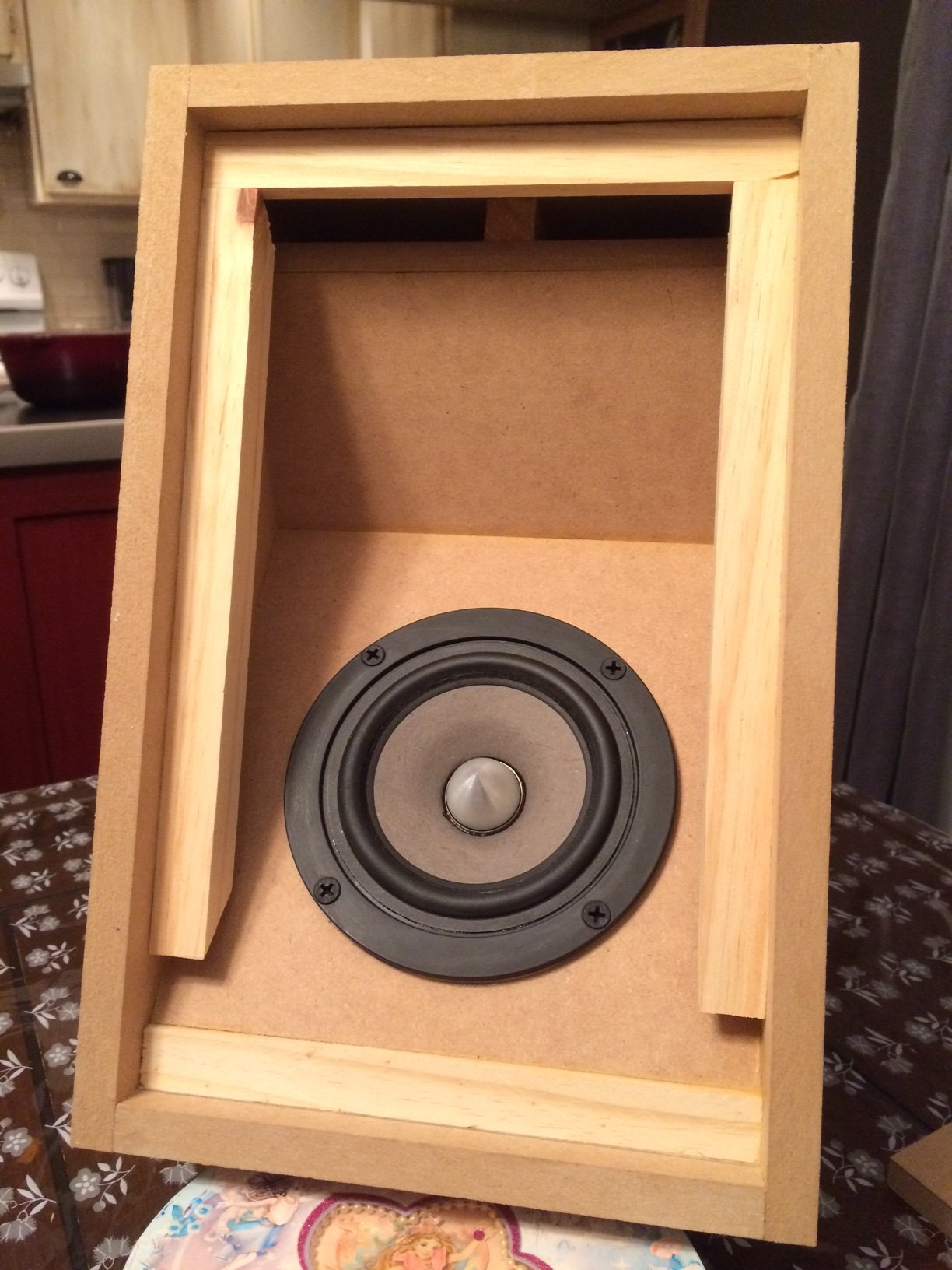

I designed it as per the method described in the first post of this thread, for the Tang Band W4-1320SIF. I employed the Advanced Online Speaker Box Calculator to do the series BP6 design, using the T/S parameters I recently measured for them. Rear and front volumes are approximately 8L and 2L, which is a bit on the large side for this driver, but so is the DCR (6L + 3L) they`re currently in and doing well. I haven`t checked the simulation yet, but I'm fairly certain the Fostex FF125K (currently in the TK6) could do well in this XKi with little or no modification, as I regularly use them in a 8L reflex enclosures, albeit with an assumed ~2 Ohm of drive impedance. Both driver can also fit the 4" hole.

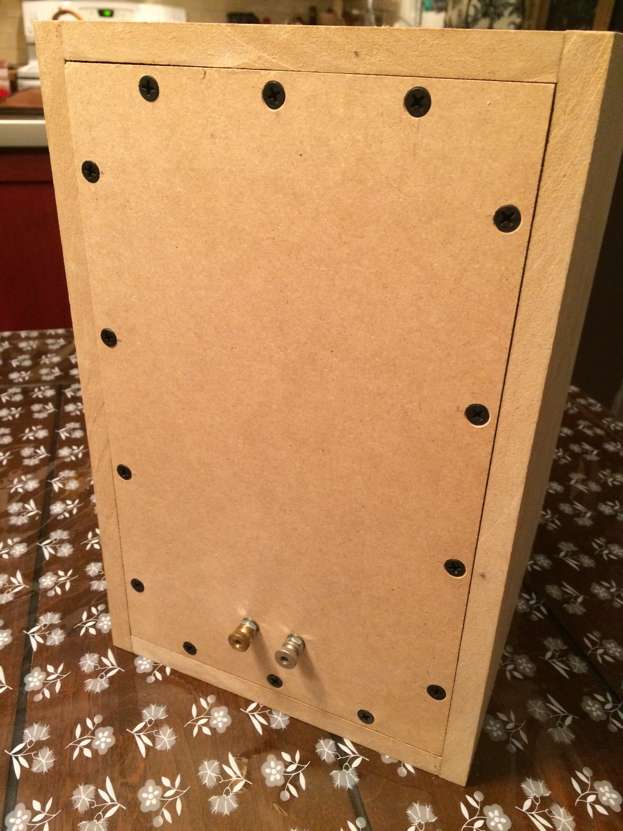

Construction is 0.5" MDF, much cheaper than BB-ply these days. The rear panel will be removable to allow the addition of a vertical vent panel if tuning corrections are required. I had to bevel the top cleats and vent panel edges to avoid restriction. The vent panel also has a longitudinal cleat bracing the top. External dimensions are about 12" high, 8" wide and 9" deep. It`s also my first time doing a "sideways assembly" for a Karlson. I would usually glue-up the sides, top and bottom and then install cleats and internal panels.
I have yet tot cut the wing panel and even to decide on the slot profile. I may start with a simple radial arc and will likely make a second set with a more open K-slot to compare.
I`ll follow-up with pictures as well as measurements.
Some build progress. In fact, it's all done save for the aperture.

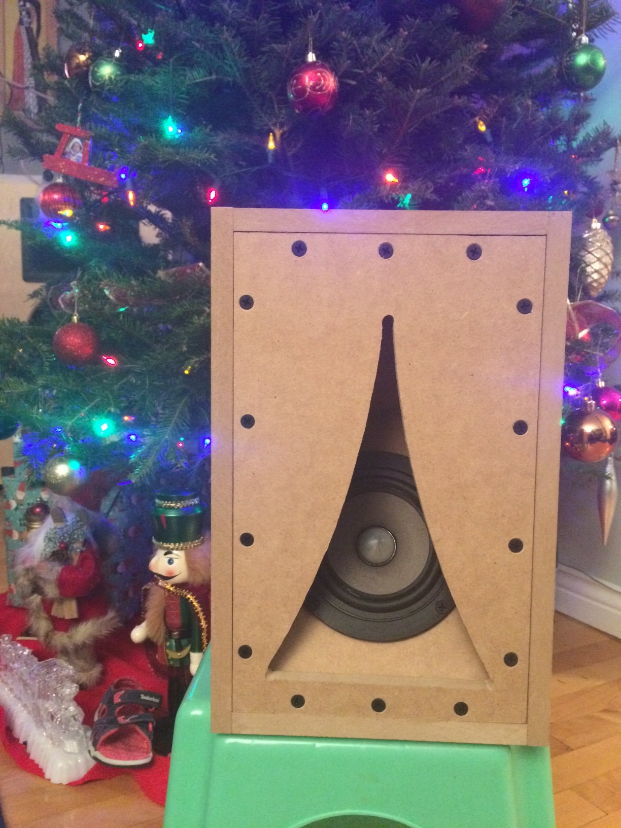

I will attempt a one-piece aperture panel, leaving a small strip of woof at the bottom. A radial arc of r=13.5" looks like a good fit for a standard K-slot, while r=27" will be good for a faster and more open profile.
Finished one aperture. I made a bit of a notch in the r=13.5" panel and this one is supposed to be the r=27", but I think I messed up and re-used the same spacing hole on my jig because it looks the same. I'll take some measurements soon.
