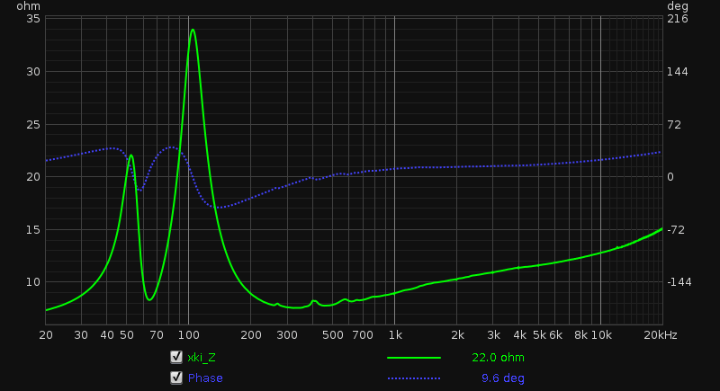

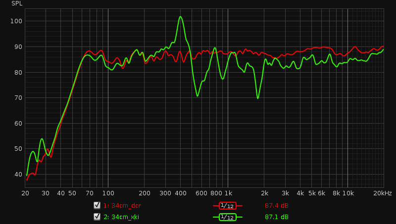

I got to take some measurements. I have two W4-1320SIF, with very closely matched T/S parameters, one in the XKi, the other in a 9L net Vb Double-Chamber Reflex (DCR). Here is their frequency response at 34cm, where the mic could be on-axis for both enclosure configurations.
The bass hump below 100Hz shows that both enclosures are on the large side for this driver. I knew this going into the XKi, but had assumed factory specs when making the DCR, whereas my drivers actually exhibit a lower Vas and higher Qts. They still do well in the DCR, so I still went for the large Vb on the XKi to help reach a bit lower. I think I should have gone smaller and tune higher. The XKi does have good bass, but its efficiency over the band-pass bandwidth is no higher than the DCR, save for the sharp cavity peak at 400Hz and has the midrange warts and associated colouration.
The XKi's response above 2kHz isn't bad at all. The on-axis output is lower than the DCR, but I believe that would be the K-slot diffraction spreading out the energy for a broader power response. The effect isn't as prominent around 15kHz and above, where the K-slot gets wider than the wavelength on the driver's axis intercept. The K-slot can thus somewhat help with baffle-step. Note that there hardly is any step on the DCR, where it should be around 515Hz and IMO measurable 34cm away.

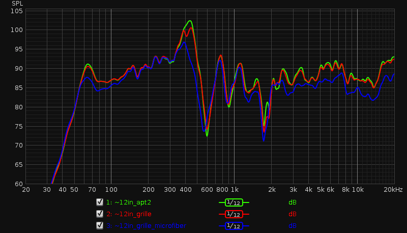

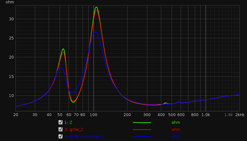

I tried a simple thin fabric to start, think Dynaco A25, which I did use to restore a pair several years back. I then went a bit more extreme to a microfiber cloth, thicker and towel-like. Here are impedance and SPL response plot, taken 12" away for the latter. Green is no grille, red the simple fabric, blue microfiber.
There is a significant damping of the front chamber resonance peak. While I expected some reduction of LF SPL since the aperture is the final vent of the system, it went down more than I though it would.

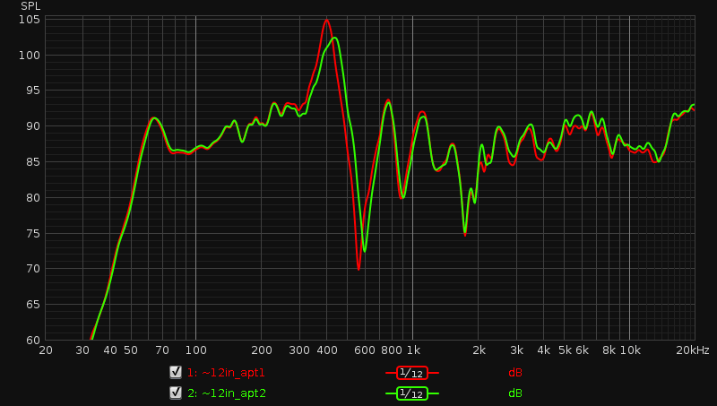

I also made a new aperture, which starts a bit higher and has a more open profile, radius of 27". This increased the frequency of the front chamber peak, see the below graph.

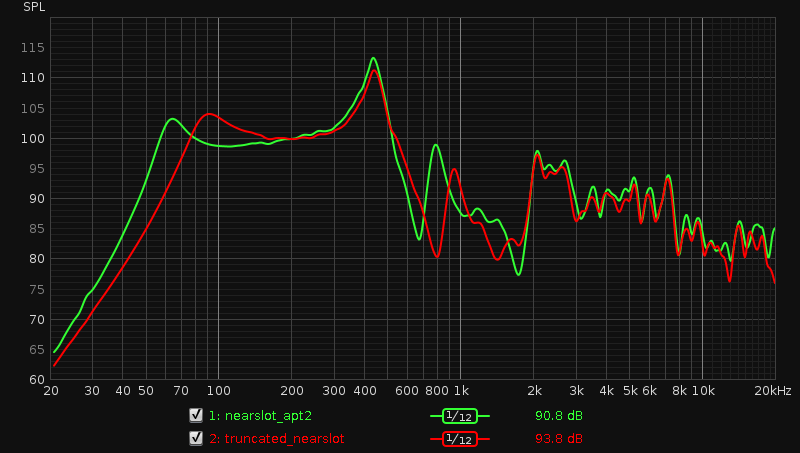

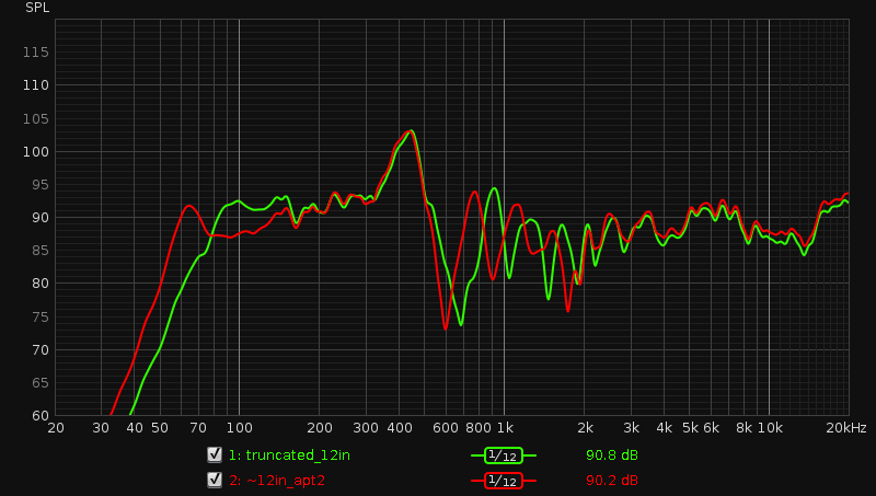

I went ahead and truncated the XKi rear chamber, cutting-off 2" of the back chamber, bringing its volume from ~8L to 5.5L. That was easy enough on the table saw. I first cut off the rear-most section with back-panel cleats and glued it back on. The vent was now really restricted at the back so i just took off about 0.375" with the router. It turned out to tune at 85Hz, pretty much what I was going for, good guesstimating!
Here a nearslot and ~12" away responses for the 8L back versus 5.5L back, with the newest r=27" aperture. Green is 5.5L, red 8L. I played with and 'lost' my VC setting on my amp in-between, so normalized the two traces at 200Hz.
The smaller Vb and higher tuning make for a smoother LF response and provides more power in the ~100Hz region, where a 4" driver can probably do better compared to trying to extract much below 70Hz. The front cavity peak remains unchanged, but the null and peaks from 500Hz to 2kHz are shifted up. There is little effect above 2kHz.

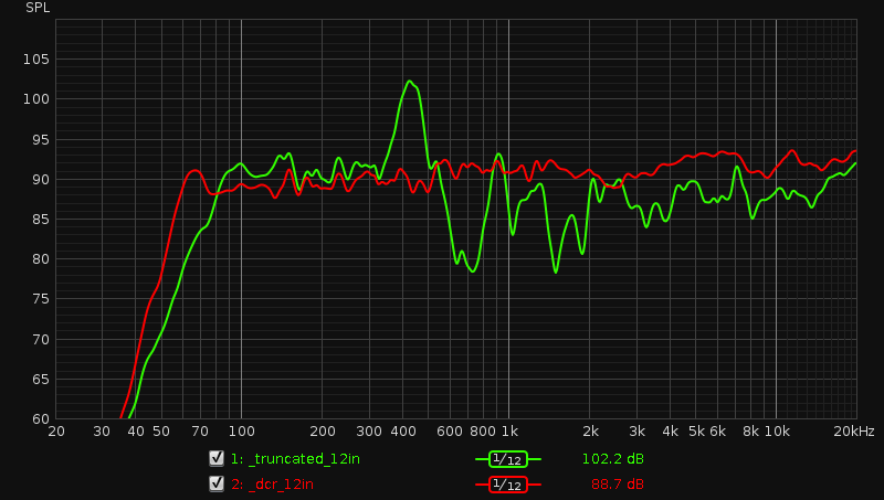

Here is the compared response of the 5.5L XKi and DCR, with sister driver.
I now have a bit of gain from 80Hz to 500Hz, though it might be questionable to count the 12dB peak at 425Hz. This is IMO better than my original XKi build, whose comparative measurement can be found in post #1327.

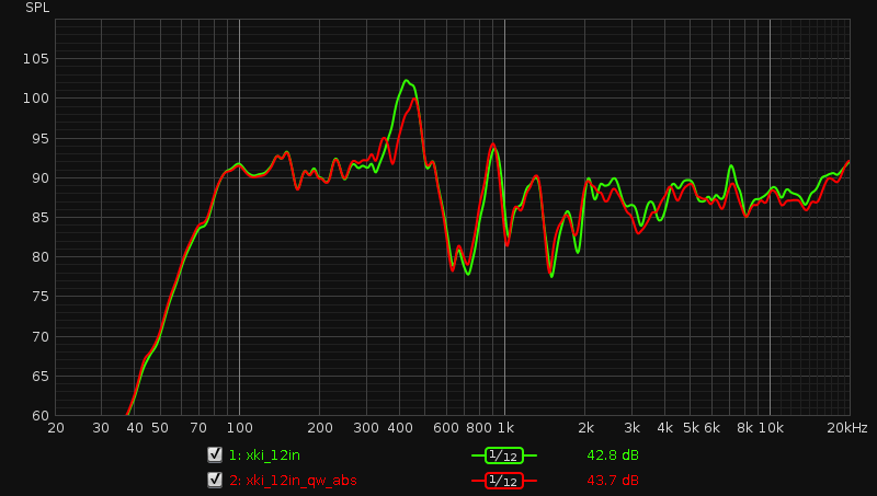

Here's something I have never tried on a Karlson, an absorber for troublesome peaks. Here it is at 425Hz, so I've rolled up an 8" length of thin cardboard around a 1" dowel, held with tape and caped-off one end. I simply placed it "freestanding" in the front chamber, with the open end at the top of the chamber.
The red trace is with absorber in place.
There is some measurable effect, not bad. I suppose a larger diameter tube placed more strategically might have a worthwhile effect.
