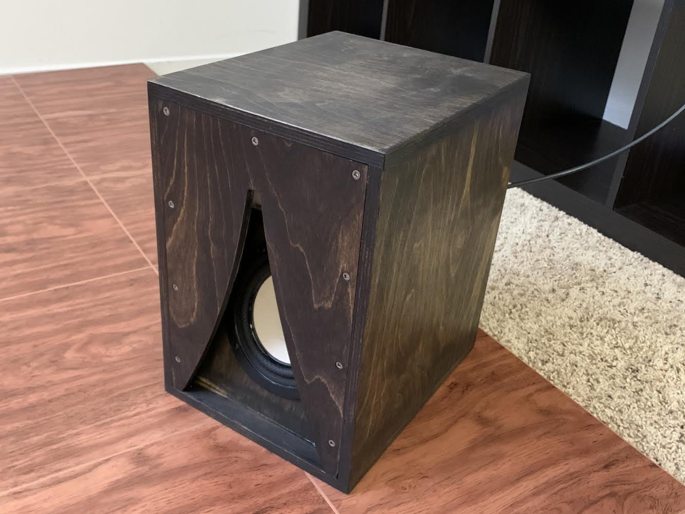

It turned out beaultiful on that finish.View attachment 1017428

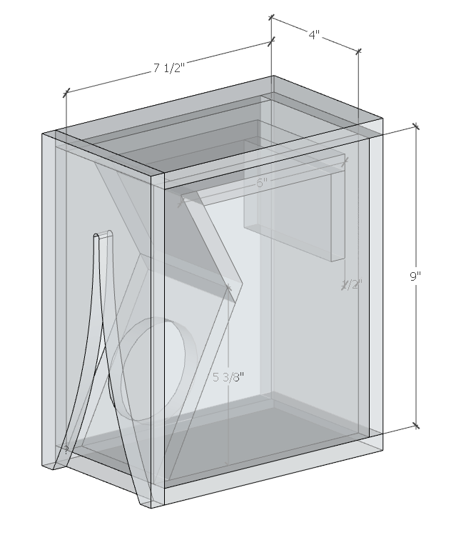

That looks about right. Maybe round over the sharp corner where the vent is.
Are the mesurments better than the foamcore version?
How low is it getting on your room?
I'm really going for it, and make the vent corners all rounded. Maybe today ordering the drivers, and when it arrives, will get the cut plans to the local shop to do it on plywood 15mm.

The aperture can be hand drawn/cut based on dimensions shown (about 2in from top is a 1/4in notch slowly cunrving downwards to a 1/4in to 1/2in wide flat at the bottom of the aperture.
One thing that captured my attention here is about the K aperture. As per the Karlson papers I'm reading, the exponencial aperture is the key for getting a flat response. I saw that the aperture recommended on the XKi has a different size and something like an open format to draw the curved line, and that is the point of my questions here:
1. I believe the 2" top offset for starting the aperture has something to do with blocking the back wave coming from the duct, correct?
2. The end format is different from the K Aperture of the original Karson design, as the recommendation for the XKi is the curved line goes down until reach the base of the speaker 1" away from the side wall, while the Karlson design has the exponential aperture finishing on the side wall, almost 1 inch (20mm) above the base of the speaker. Is there a reason for it?
3. I'm thinking about making a prototype first, using foam core, so I can make 2 different apertures and play with than, but I don't have anything but a cellphone to take any measurements... Would this be useful?
4. On my final cabinet, I'm planning to use 12mm ply, or maybe 18mm hardwood. Is there any benefit of cutting the aperture with 45 degrees angle? I don't know if the thickness of the aperture plays any role on the diffraction / distortion / resonant forms here. But definitely a 5mm cardboard or ply aperture will sound different from a 18mm thick aperture.
How high the aperture begins and its width will affect the tuning of the front chamber. Higher and wider will both raise that frequency.
The end (bottom) of the aperture isn't critical or even much important in itself IMO. How tight or open the profile is in front of the driver will have a greater effect, which might then determine what the end of the aperture is like. Tighter/narrower will be more colored and will give broader MF/HF dispersion, effectively producing a BSC-like effect. I would recommend a fairly open aperture with the driver you intend to use.

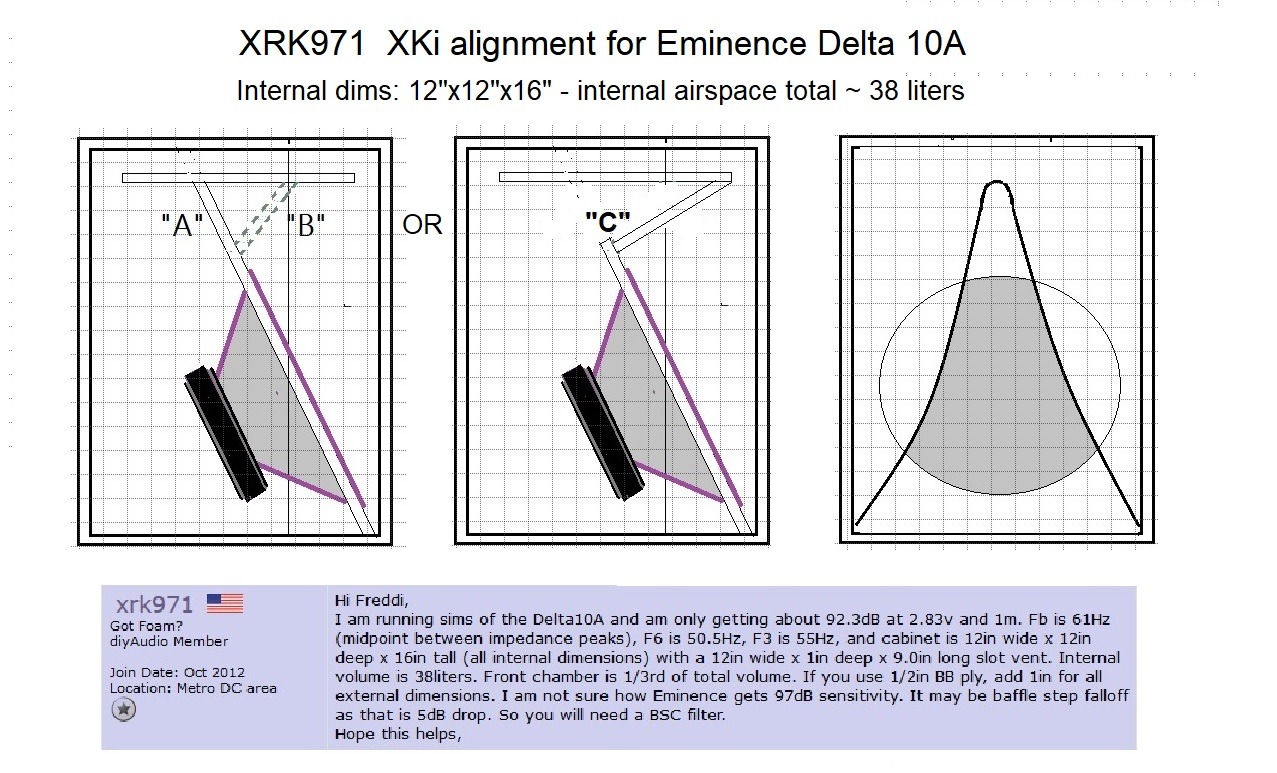

lets say I want to make a "K of sorts" for Eminence's Delta 10A. Which if any A/B/or C ways of connecting the vent to the chamber would you choose ?
Would you attempt to further squash the 16" height? I would use a K-tube on top.
At the other extreme, what height, etc. do you think might work well for a K10, including option (if useful to SQ) of curved or approximated curved reflector ?
A retake of a K12 might make more sense but I'm stuck on seeing what might be done with 10 inch drivers.
A smoothing stub could be employed. I'd like to retain some "hit".
Eminence's first B102 was a great driver for Ks. When they dropped magnet strength, they lost midrange output and HF extension -that said, I think the current B102 is workable for Karlson type.
A test box with variable baffle angle - removable reflector, vent panel, etc. sure would help sort matters - 'maybe " --]there's so much which could be adjusted via aperture - vent location - vent type (distributed vs single /dual) -shelf vent may benefit with a V notch per Nexo's vent patent, lowpass gap too.

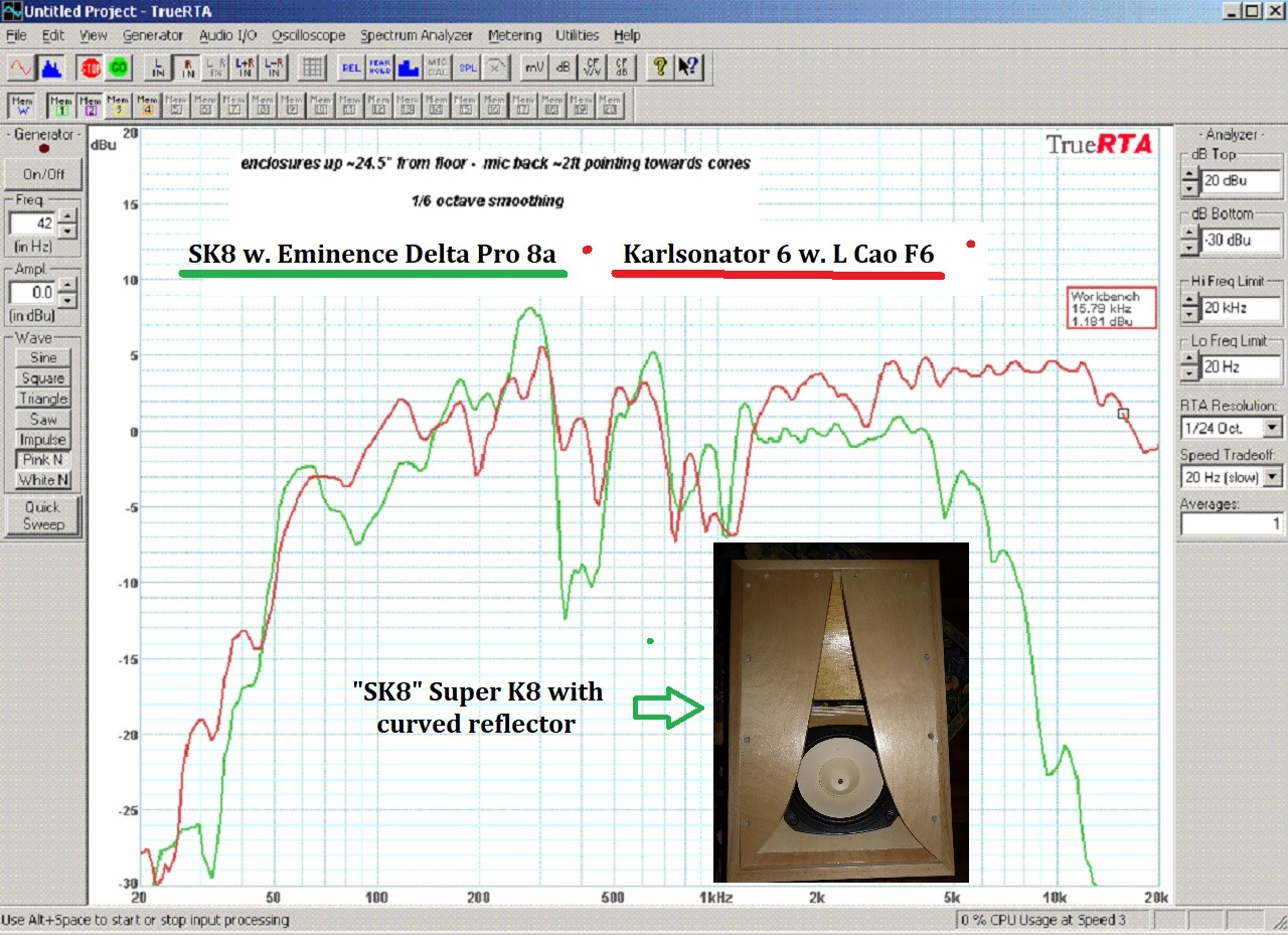

Hard to say, I'm not sure how each would behave, though B and C are fairly similar. Honestly, the SK8 is already pretty much a K10 and should work well, perhaps with Vb and Fb accommodations for a given driver. It measured fairly well and was well-behaved in its gain-BW.
My thinking as of late - as far as using a Karlson into the midrange and treble regions - is more focused on just making it worthwhile despite the response anomalies and subjective coloration. That means tuning for actual mid/upper-bass gain over the same driver as a direct radiator, usually in the 80Hz-300Hz region or so. This will often be tuning the rear higher so as to blend the response to the upper chamber gain, which is often more of a peak by itself, think sealed back response. Low bass will have to be traded-off naturally. Front chamber design should be about making this peak of lower Q, somehow. The aperture should take the driver's response into account, in which a rising response is IMO better - not that this is news to you. 🙂
