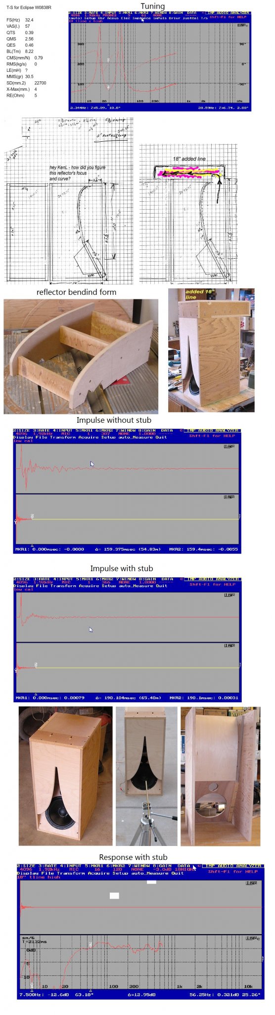

wish a sizeable damped stub, response should improve. Look at Ken Lehman's
"K8" RE with polycone 8" before and after the stub/cavity. was added.
Well the response without the stub is lost forever - it was rougher and Ken said the stub got rid of some "echoes" (high Q holes i think) besides cleaning up the impulse response.. The way the stub was done below adds volume to the front chamber so it should not be made too large. With 15" and 18" it might be good to try to get a front chamber reosnce of around 110Hz (K15 is ~ 'there" I think)
The stubs are great for suppressing a peak. They can’t do much for a dip. But to suppress a peak, find the frequency using a microphone and sweep or FFT program.
Calculate the 1/4-wave length of that frequency and make a stub of same length. Typically about 1in H x width of cabinet x depth of stub length. Fill with fiberglass wool etc.
For example, assume you see a 500Hz peak you want to smooth. 500Hz / 342m/sec = 1.46m. 1/4 of 1.46m is about 37cm or about 14.4in long stub.

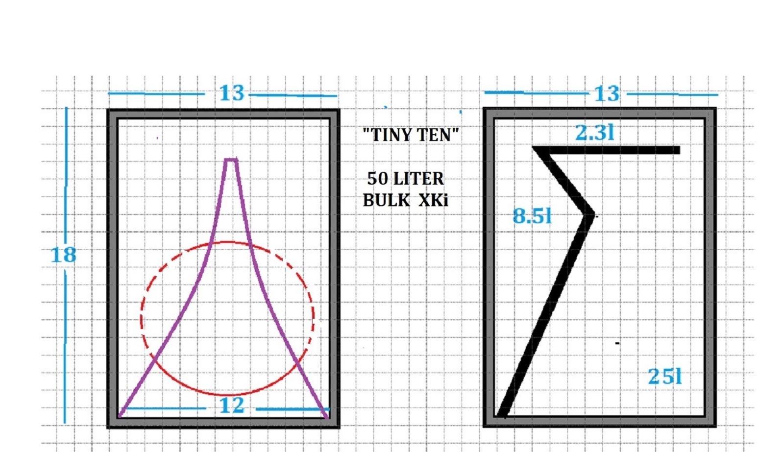

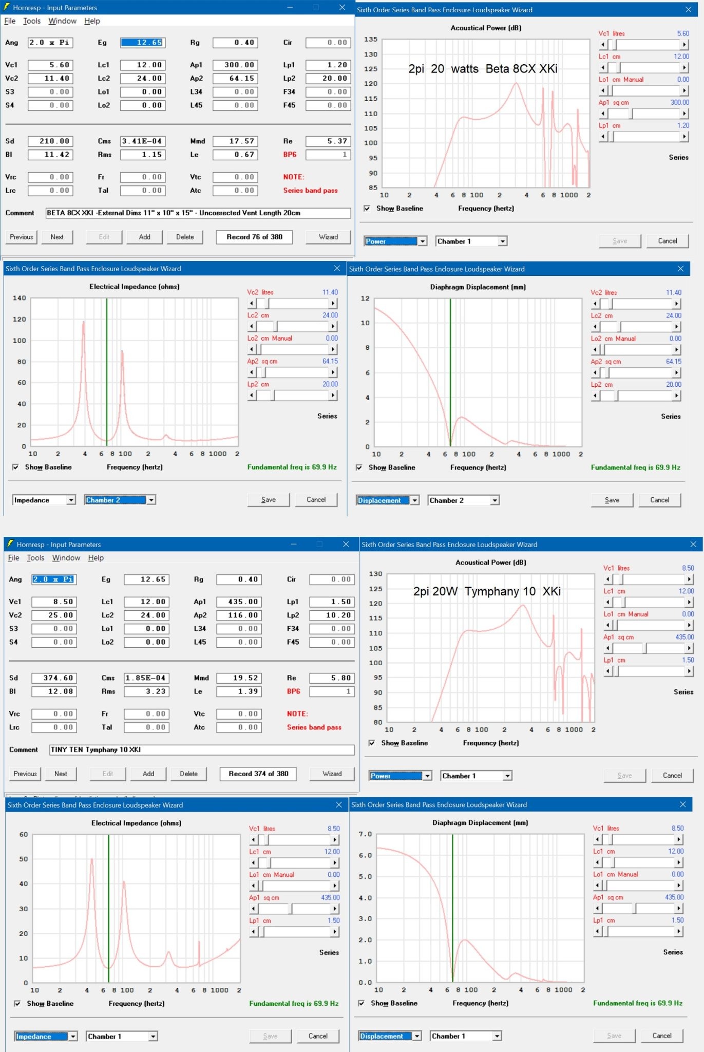

- I need q quick decision - like in an hour - choosing between 8" driver XKi and 10" driver XKi
The 8 inch version would be XRK971's build for Beta 8cx and the 10 inch a Tymphany "Pro" woofer.
8" cabinet size - 11" x9" x 15" - - - - 10" cabinet size - 13" x 13" x 18"
Both tuned ~70Hz.
which would you choose ? Due to not knowing if I have 2-10cx anymore, the Tymphany 10 with a K-tube on top would be "it", while I probably do have a pair of Beta 8cx. Michael Chua gave good marks for the Tymphany 10 in the vocal range. I'd like it to sound decent by itself (without helper woofer/sub woofer) with drumkit.
I think the 10" will do better with drum transients but Beta 8cx might not be too weak.

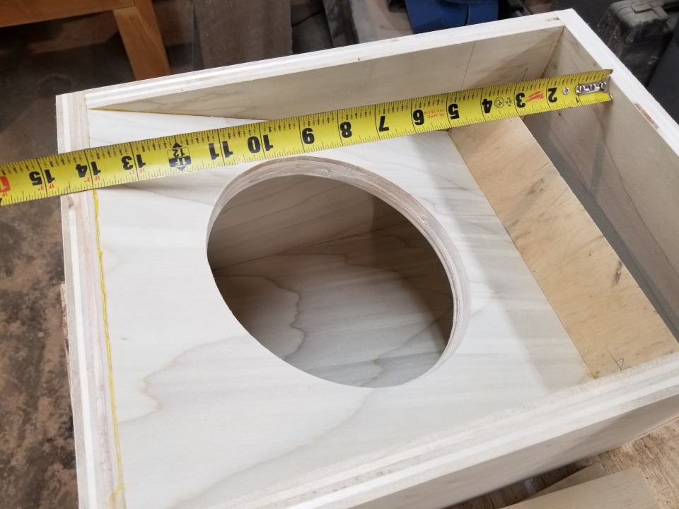

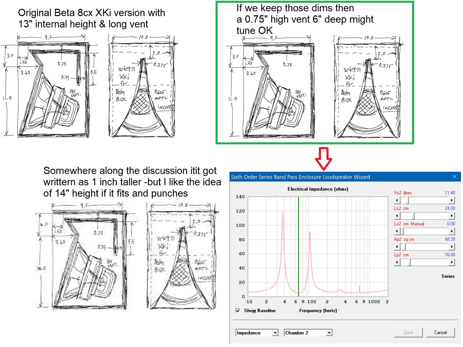

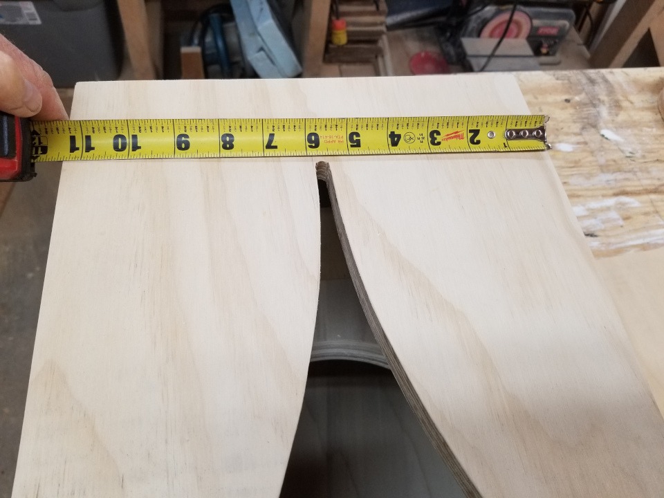

hey X - will it all fit with the original 13 inch internal height of the sketch ? 14" height would be awesome.
I get for a 10" x 0.75" high vent around 16cm length to tune to ~70Hz and that in practice could be around 15% shorter so around 6.3 inch vent length
If you add 1in height you can adjust the depth to keep volume constant. Or make vent a bit shorter. The vent takes some manual hand adjustment. I would find some way to adjust vent before permanent glue.
thanks - did you front mount the speaker ? - I can't locate the original pictures of the build anymore.
