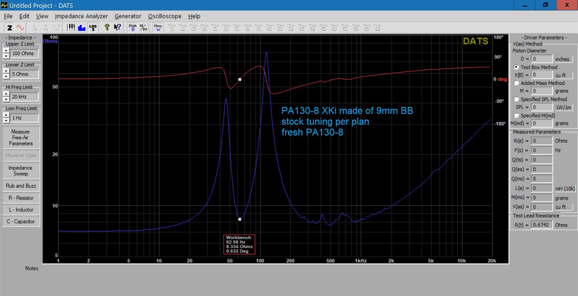

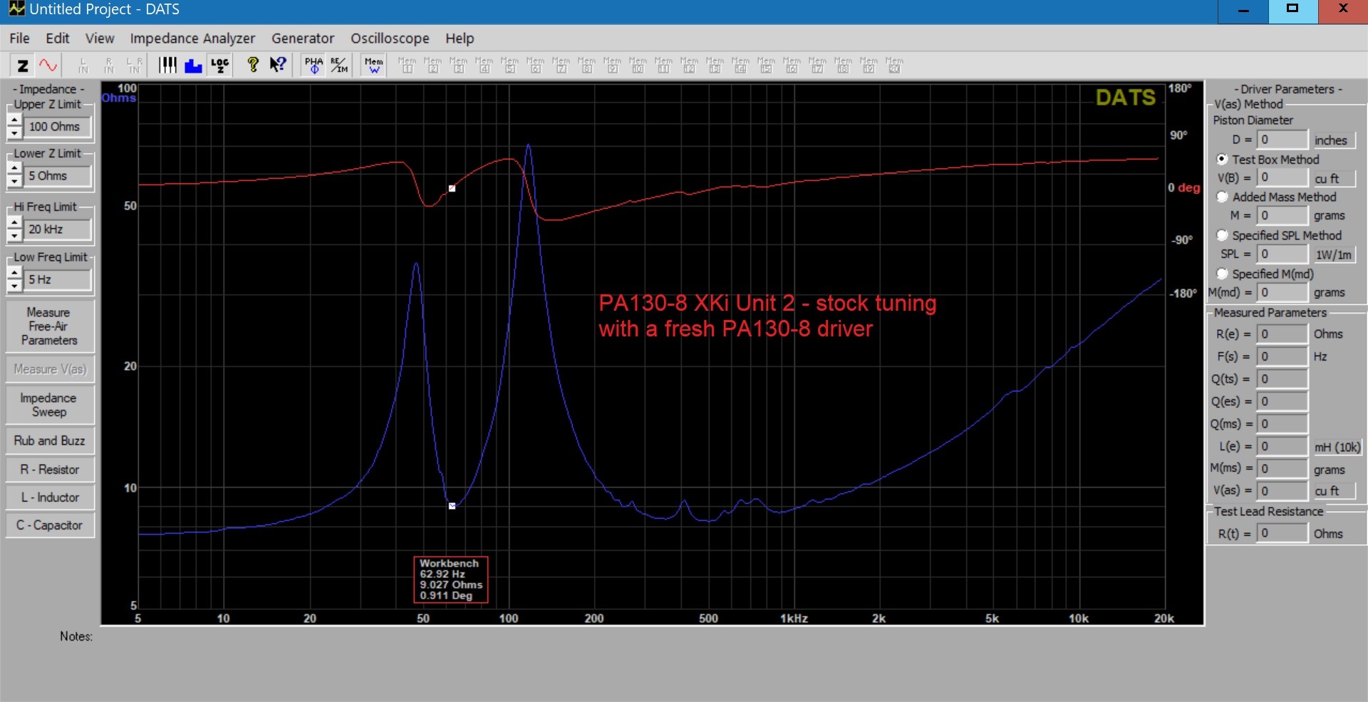

Here's tuning for XRK971's single PA130-8 XKi when made of 9mm plywood:

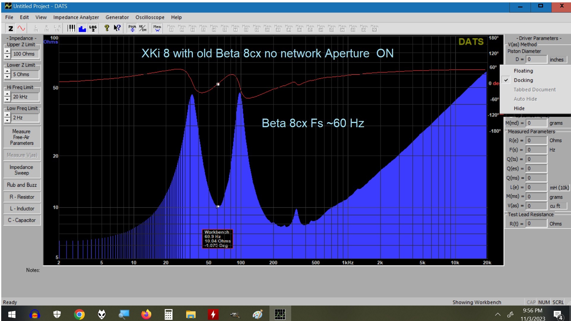

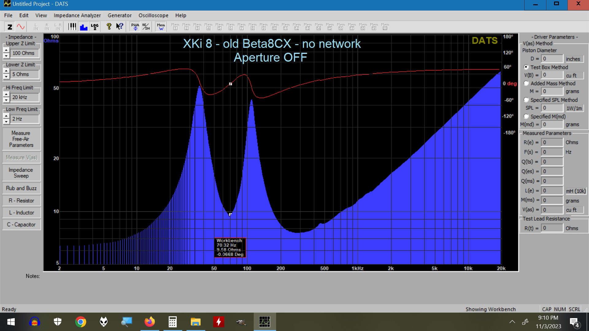

Hey X - What was your Beta8cx XKi's tuning ? I'm worried mine are tubed too low and can't be modified. As built by my friend with a long tunnel vent and tight aperture comes in @ ~60Hz - which is well below a target of around 70Hz - then again that may be acceptable as GregB's Karlsonator 8 tuned around 41Hz.

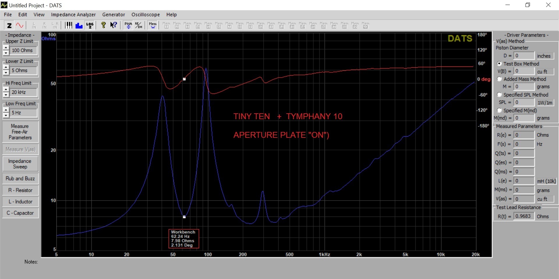

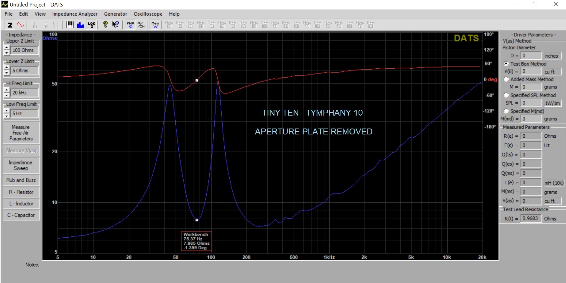

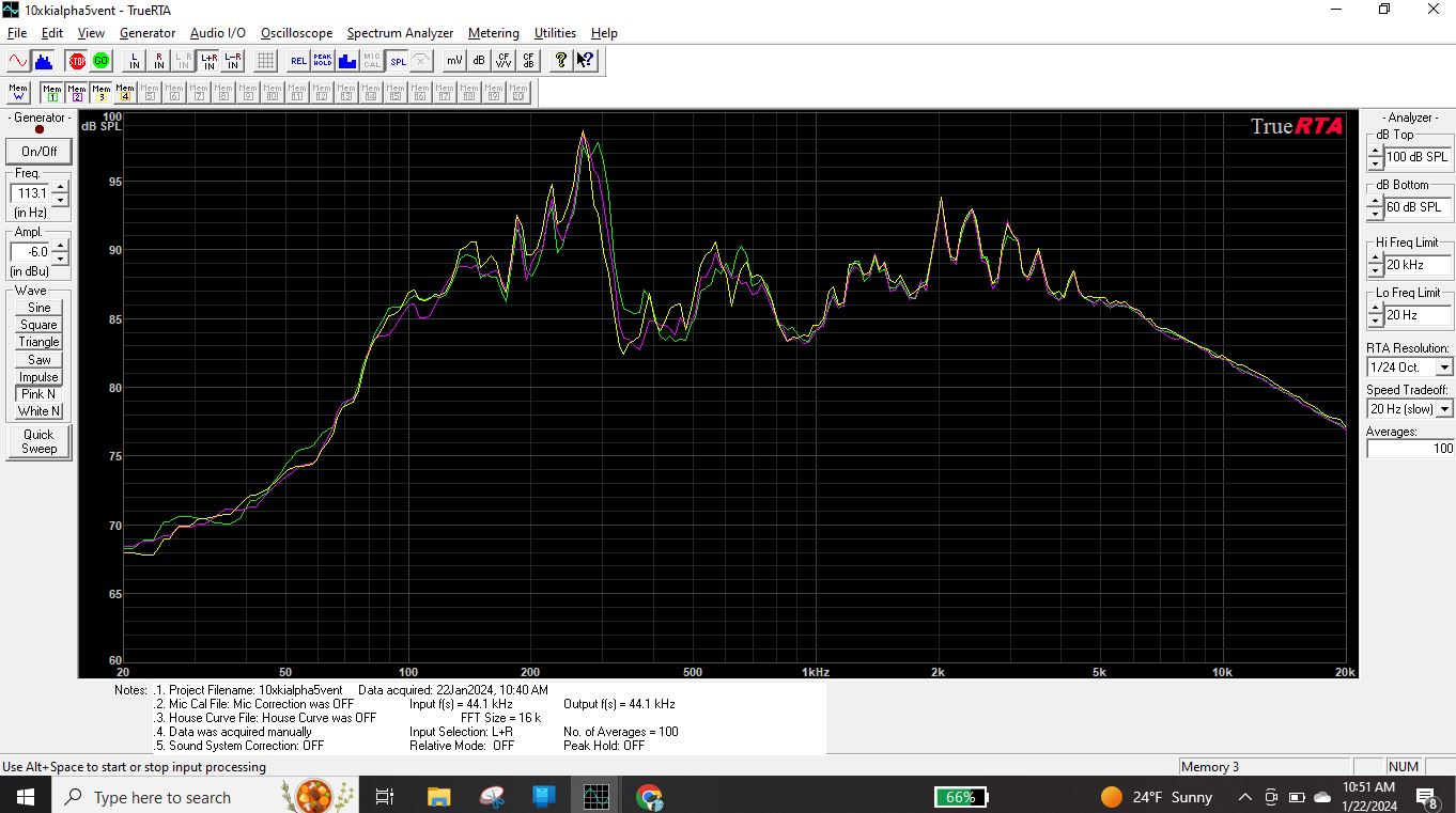

I'd like to add my "boombox" made of two PA130 XKi that sit on a carrier has very good sound with a $20 or so Kinter 3118 12 volt supply amp and its tone controls are useful (plus can bypass). It was a total success.

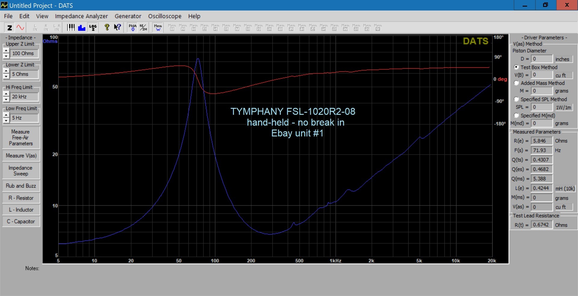

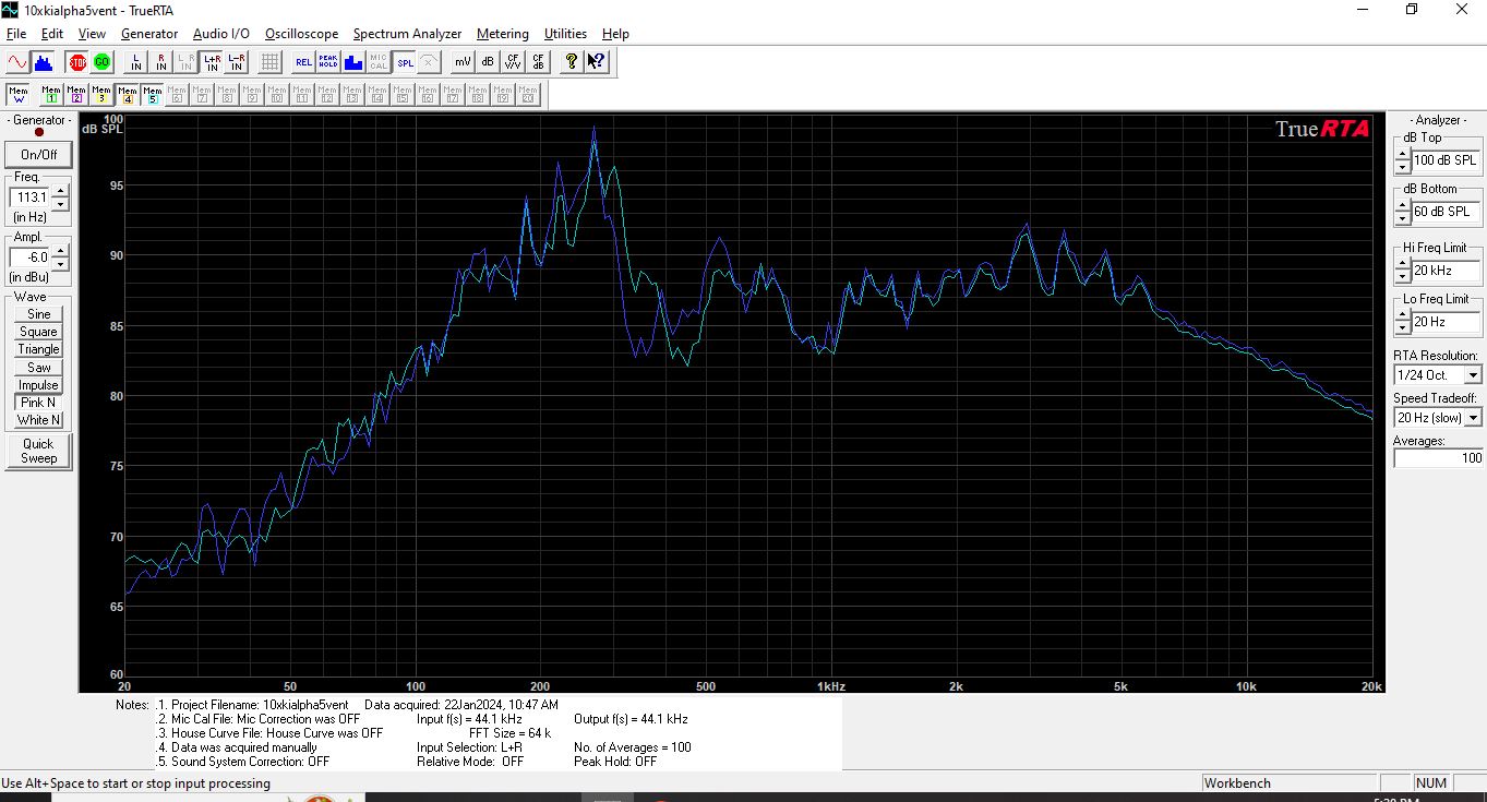

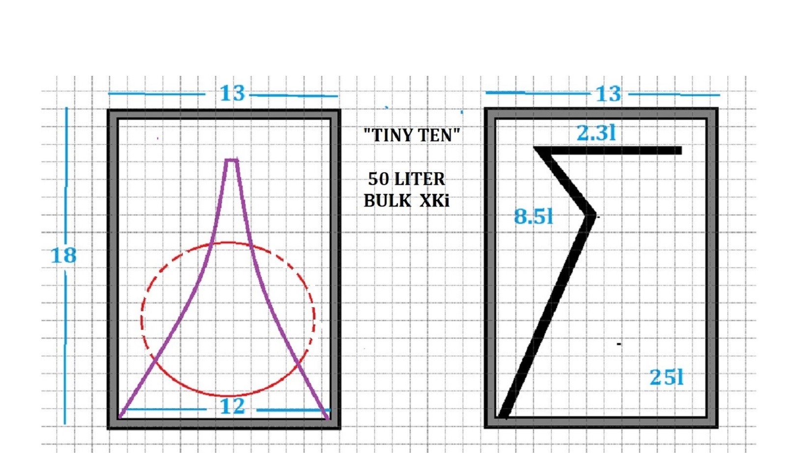

A 10 inch XKi ("Tiny 10") built by a friend has not proven itself yet. Loaded with a Tymphany "pro" 10" woofer, its pink noise graph doesn't even reach 100Hz - and is beaten by an Alpha 10A. The rear chamber is only about 25 liters - but that should be sufficient - with some 10" speakers such as Delta 10A.
Bandpass sim were too optimistic for LF extension - dunno about those pink noise graphs .
If I get this cabinet then will try a couple of different 10 speakers and bass guitar.

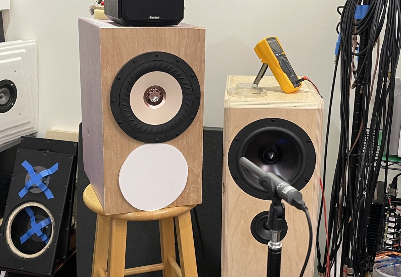

This was made in my usual spot inside my lab on top of a 30in tall stool about 3.5ft away from back wall. Mix was about 36in high off the floor. So there are walls for sure but mix is 0.5m away so helps to reduce ceiling and floor bounce.
It’s been a while but I think the above is with EQ applied. Here is difference between raw (red) with high pass filter (green) and with EQ (blue):
Here is typical photos of the setup (different speaker but similar setup).

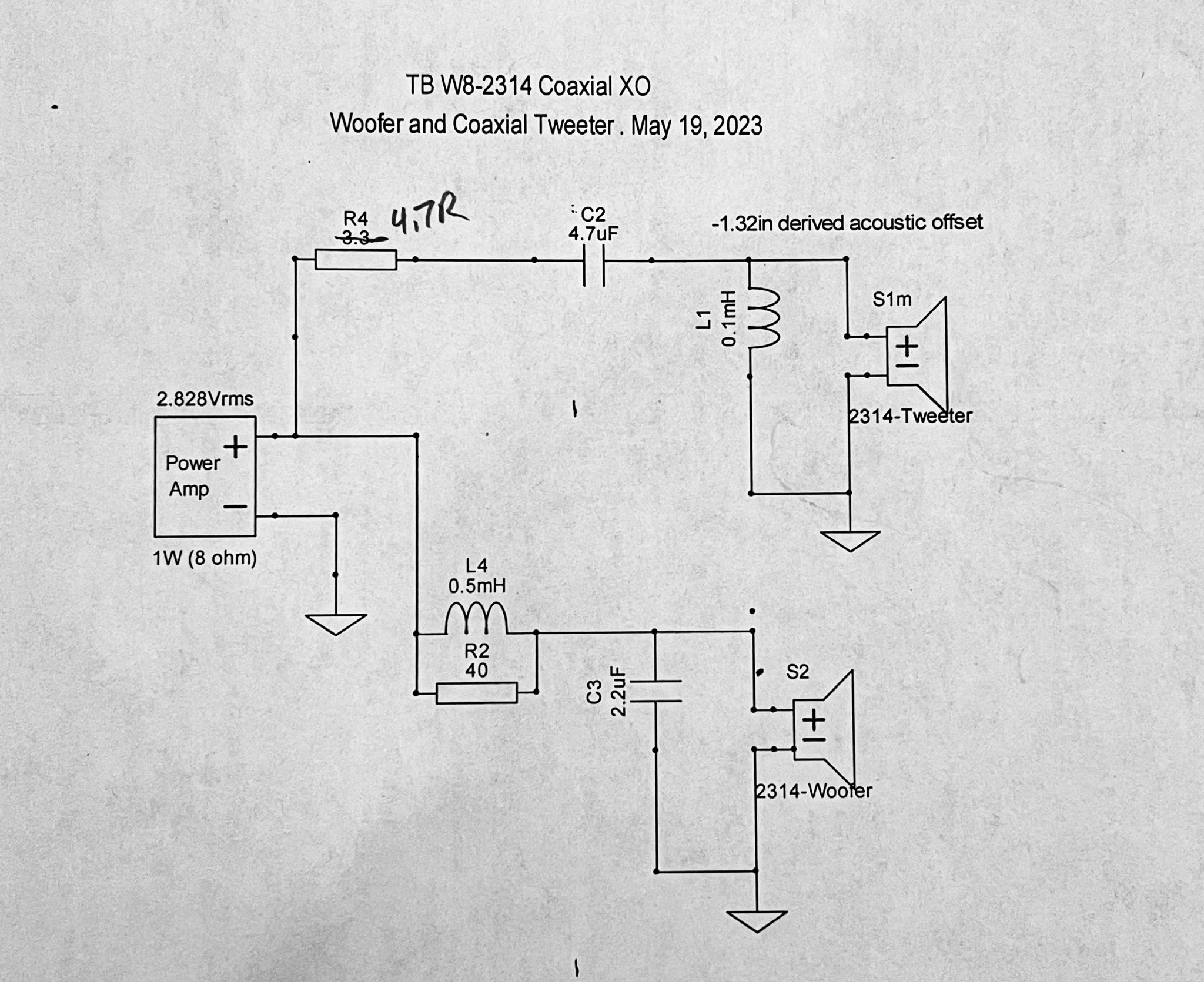

Here you're showing the Tang Band 8" Coax. (Parts Express lists it but you need to buy 50 of them before they'll order it in. )
Got to ask... How would the Tang Band Coax do in this box? I forget the specs but if memory serves. 38Hz to 40kHz.
You'd have to put in an XO ... something around 1.1kHz???
PE recommends a vented cabinet of ~1cubic ft or ~28L
Thoughts?

I haven't made a single PA130 so can't compare. I think the doubles I made were tuned a little deep. I had to get rid of them when I moved country so am looking at building another pair. If I recall correctly, the Akabak simulation did not account for the right angle bend in the duct and the end effect at one end of the duct (maybe both ends). Both of these serve to increase the effective length of the duct, making it tune too deeply. There was a dip in bass response at about 80 Hz, which picked up below 60 Hz. On some music they sounded amazingly clear and deep.
I have some XKi8 - target tuning was around 70Hz" but shelf vent effect plus front aperture plate which effectively lengthens the duct gave tuning at 60Hz- with Eminence Beta8a it plays into the 40's - a good octave deeper than a K12.

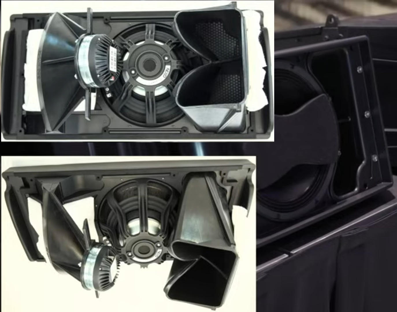

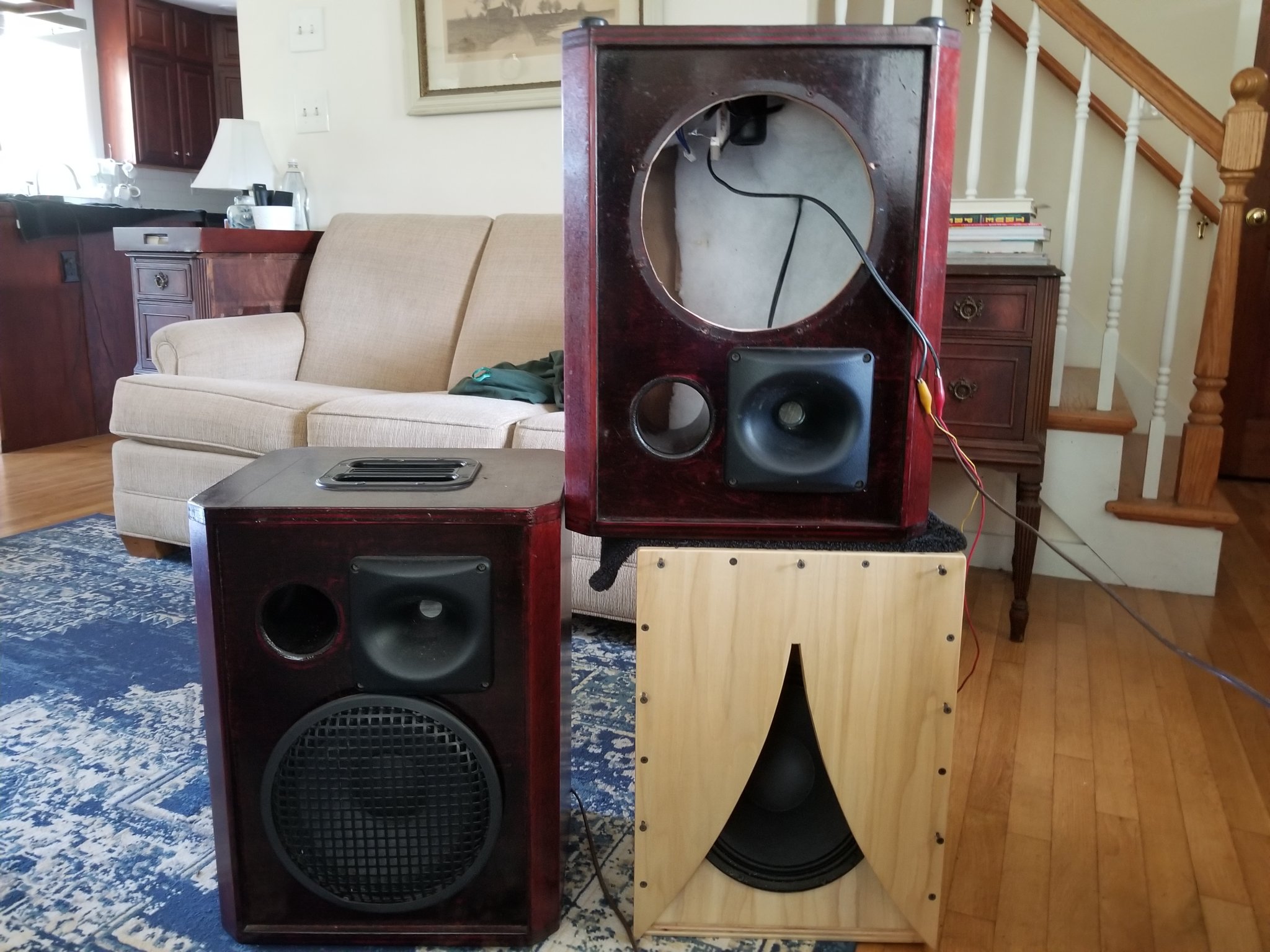

It would be interesting to see if NEXO's K-slotted shelf vent concept would work in some XKi which use a relatively long shelf vent. "Gridnstone" posted a picture of a NEXO cabinet
XKi8 with 9 inch long K-tube

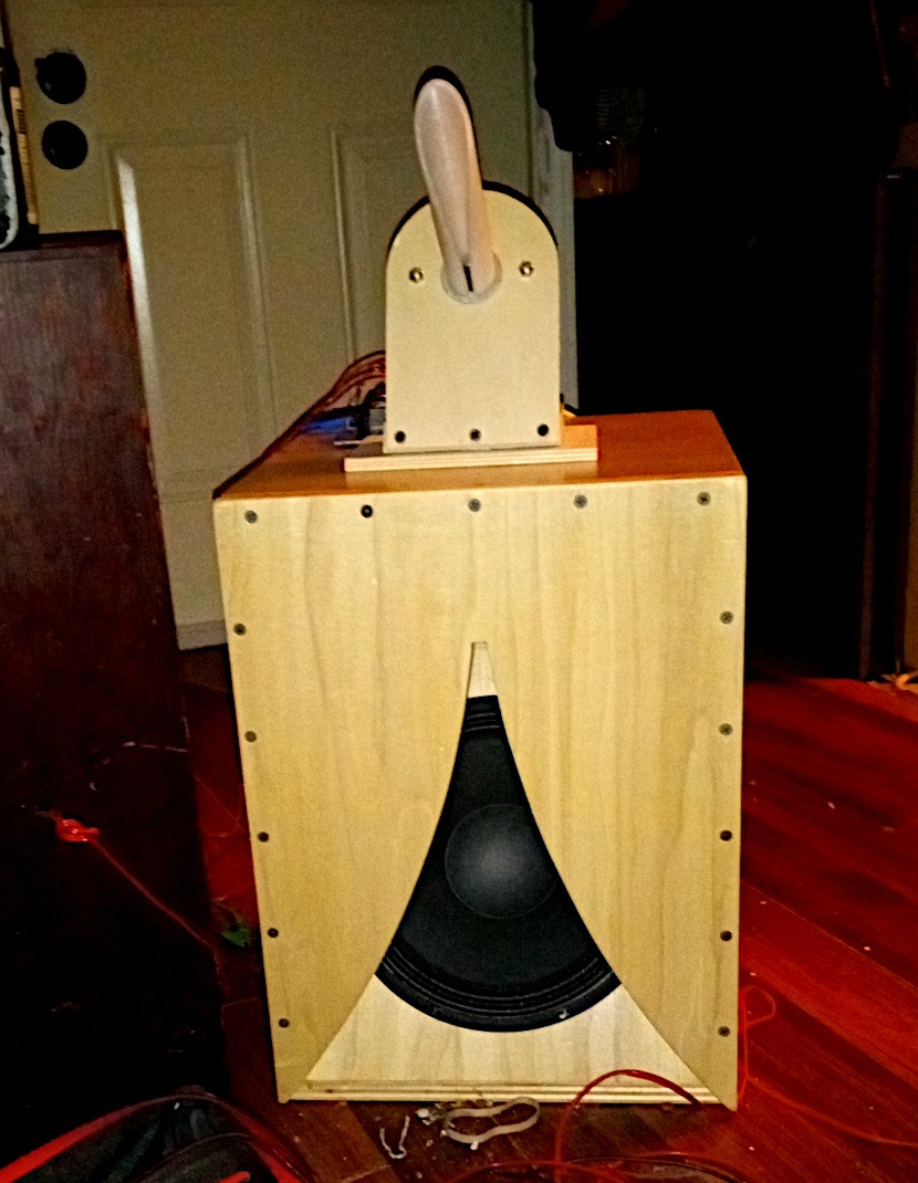

not sure how low- - it sounded strong on sine sweeps - beautiful on handbell recordings with a PRV D260 ring radiator compression driver. It was printed for me by Pelanj - so the file may be in one of his folders - if not- I'm sure he could provide it.
Here's a 10 inch XKi - with Peerless Tymphany 10 woofer topped with a PRV 260 ring radiator on a 9 inch long K-tube - too bad the MOTO-G phone can't capture the purity of the highs
It tuned way lower than target - even without the aperture plate in place.

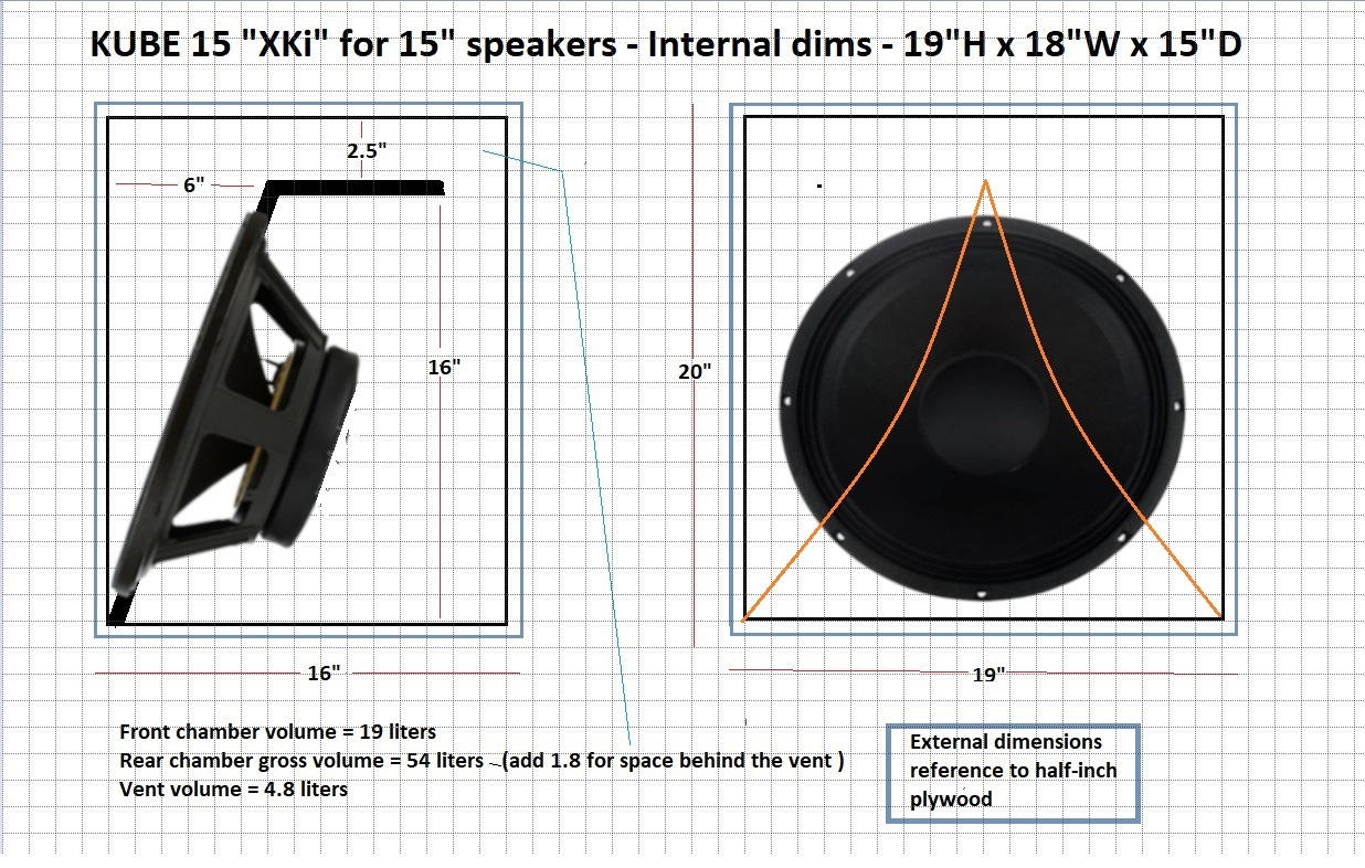

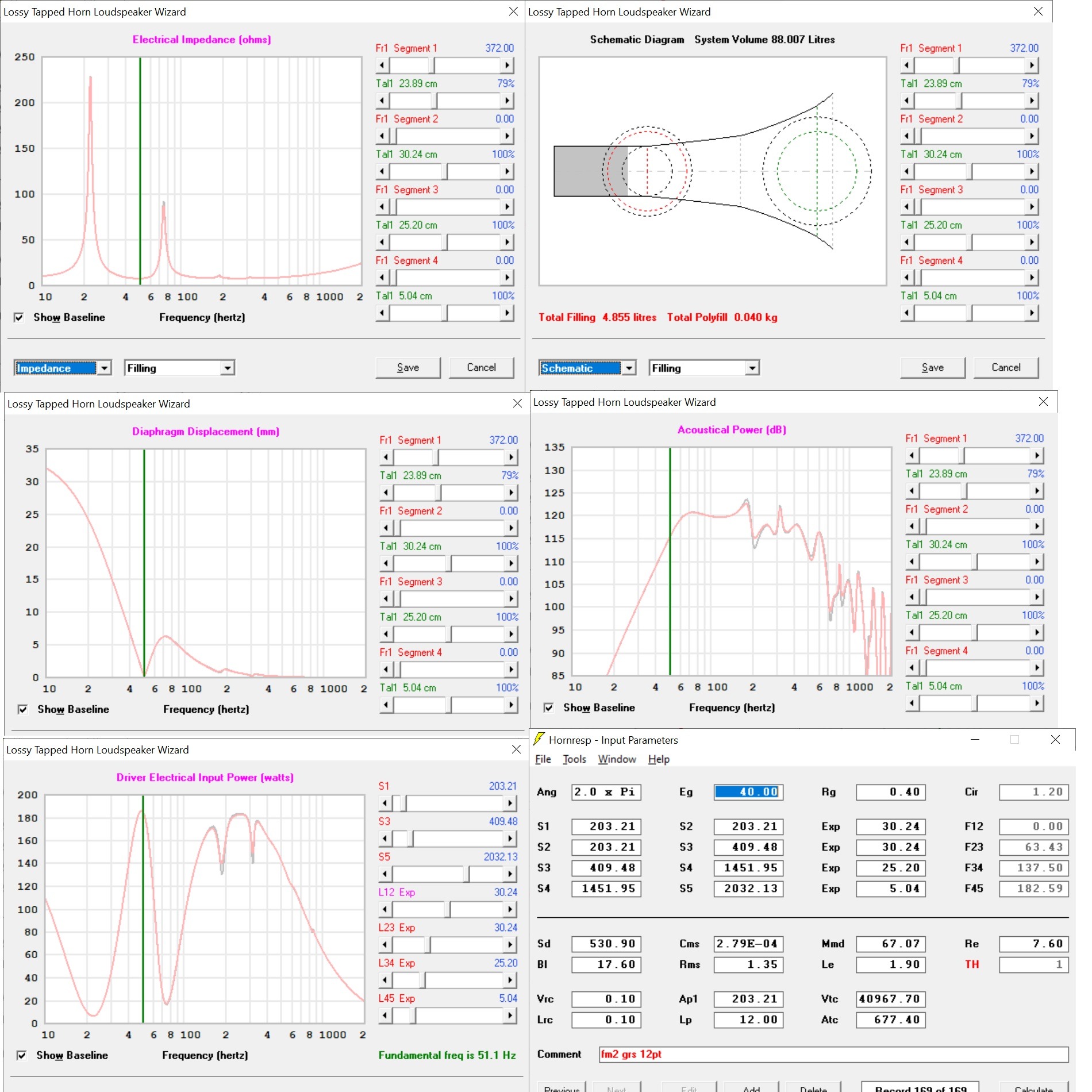

How about a 12" driver XKi with damping stub above its vent to calm the cavity peak, smooth response, and absorb reflections ? Maybe a 40 liter rear chamber and 12" long duct for the smoothing stub? I think overall bulk would be smoother than my guesstimate sim.
It could be a 3-way using a K6 or K8 midrange module with smoothing stub, and the midrange module topped with a K-tube. Below 50Hz a subwoofer could take over.
12PT isn't the most sensitive driver but still might do 120dB peaks and at $50 on sale, a pretty powerful driver.
