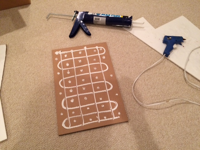

I made some good progress on the Beta 8cx XKi. I was going to make it out of wood because this driver seems like it might put out quite a bit of SPL and the motor is pretty heavy once the CD is mounted on. However, Freddi reminded me that making something out of wood at this point would ruin my reputation as a foam core speaker builder. So I decided to go with laminated foam core and cardboard CLD sandwich construction. Plus, it is very clean, lightweight, and easy to work with.
I started by cutting all the panels and pieces in triplicate (2 foam core and 1 cardboard). I am using heavy duty 2 ply cardboard and sandwiching the cardboard between two foam core panels held together by latex caulking and dabs of hot melt glue.
Here is a photo of the CLD composite panel construction:
It took over an hour just to glue the panels after making the 3-ply sandwiches. I am using houselhold bathroom latex caulking for the CLD. Here are all the pieces:

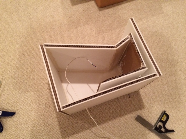

Here is the speaker starting to take shape:
Note the bracing in the vent to keep the vent gap accurate and to reduce vibrations on the vent panels.

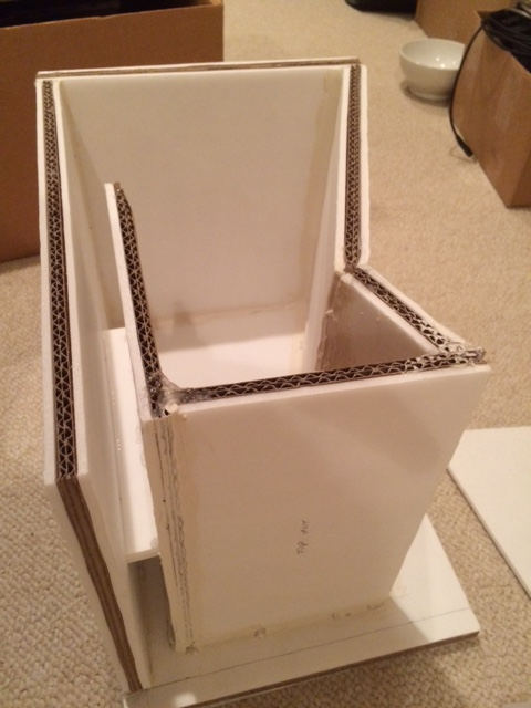

More progress...
Final capping operation with second side piece laid on top:
I used mostly non-VOC Liquid Nails to glue the panels together and used hot melt glue sparingly in dabs to tack the pieces together.
I think I need to wait 24 hours before it is strong enough (and dry enough to take on the weight of a Beta 8cx and PRC D280Ti compression driver.
