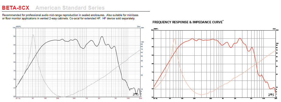

Was curious seeing driver build in HF roll off and did find two different datasheets responses funny enough they share both have a build in "W".

assuming Eminence's own data is to be trusted, its not too bad in its present state. I'm pretty sure there have been diy and commercial speakers touted as high-end with just as much variation 😀
You guys are right for pointing out that the driver has a natural 6dB dip, maybe that is then made worse by both the vent resonance freq and the box width frequency which all conspire to eek out a 20dB dip? I may be dealing with a trifecta here and tough to ever get rid of them all. 8cx is just not the flattest driver to start with.

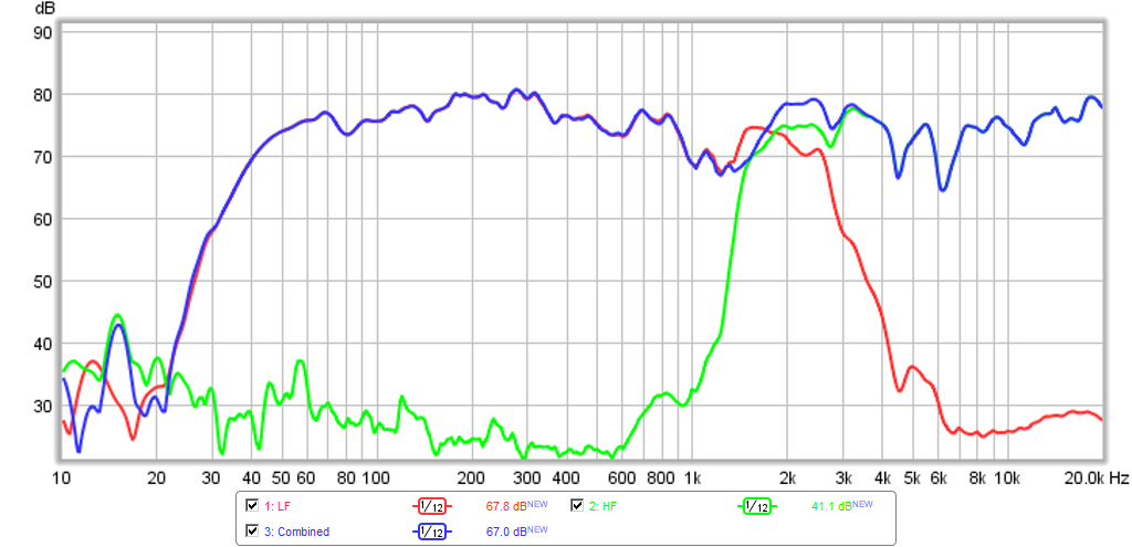

Here is the XO measurrement (2kHz 24dB BW on both) - it can be optimized some more later:

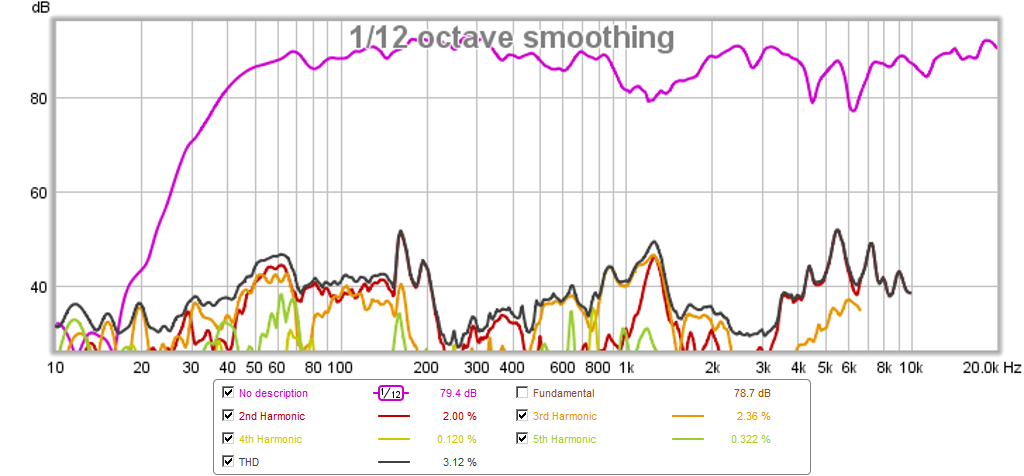

Here is the harmonic distortion, not the dip at 1.2kHz is now equivalent to the natural dip inherent in the driver:

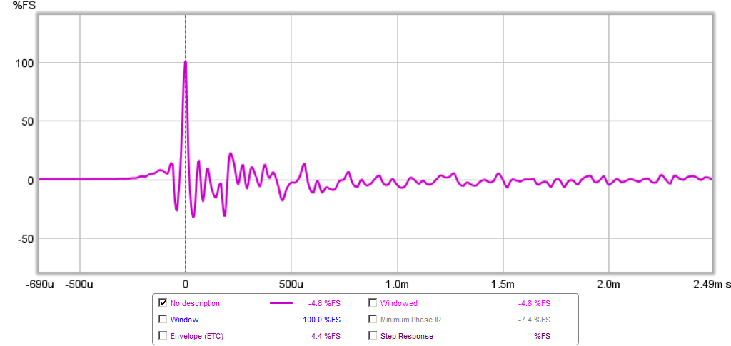

Here is the Impulse response:
