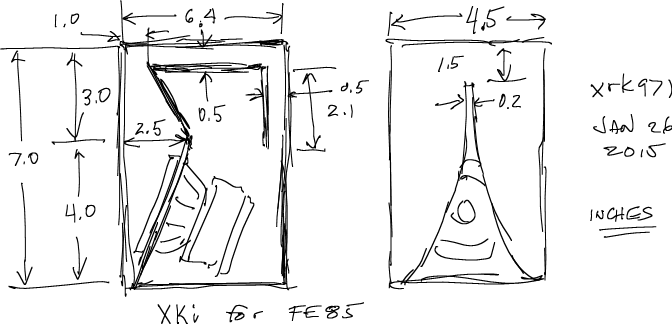

XKi - FE85
Here is the plan:
Good luck and let me know how it goes.

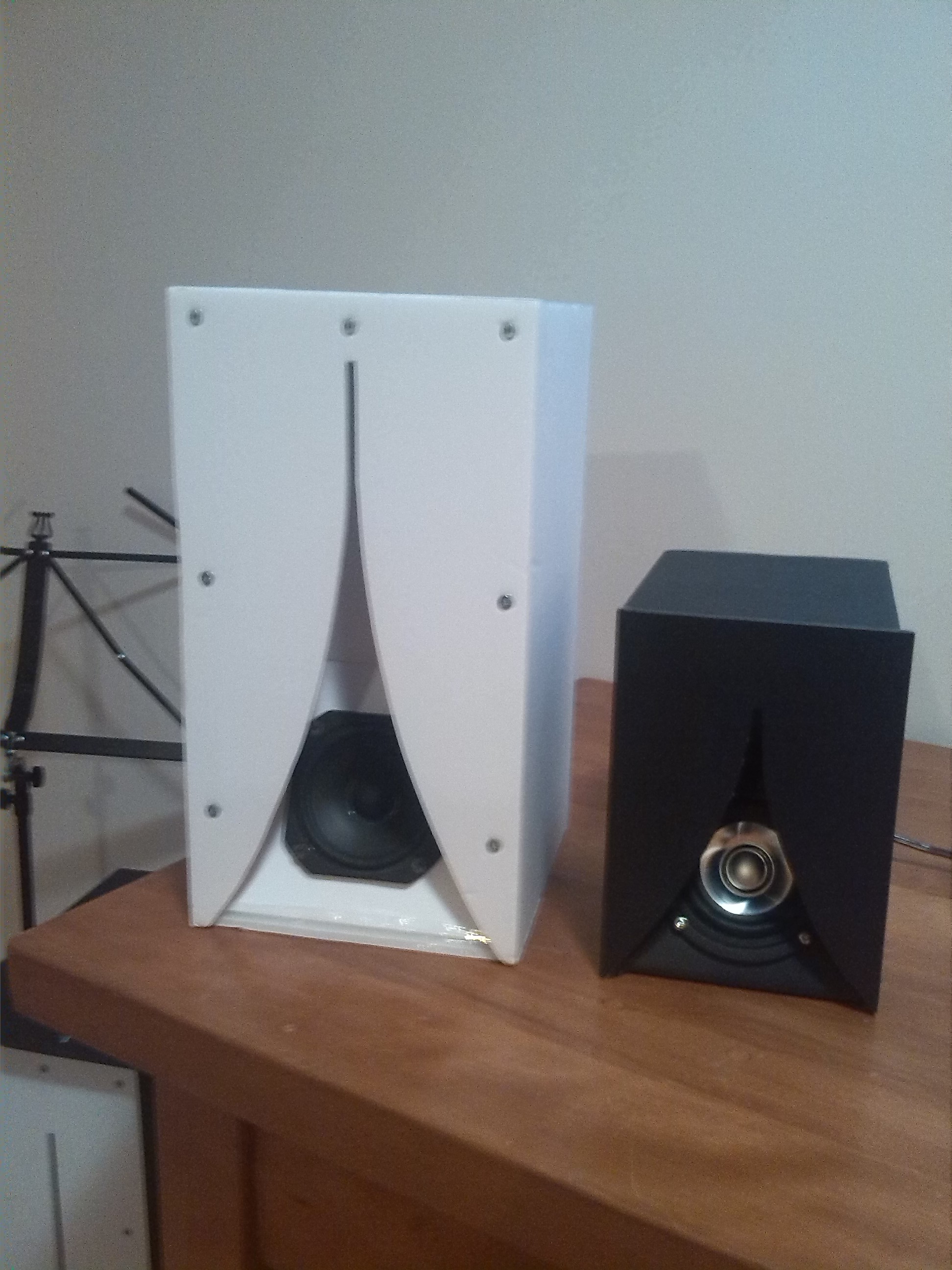

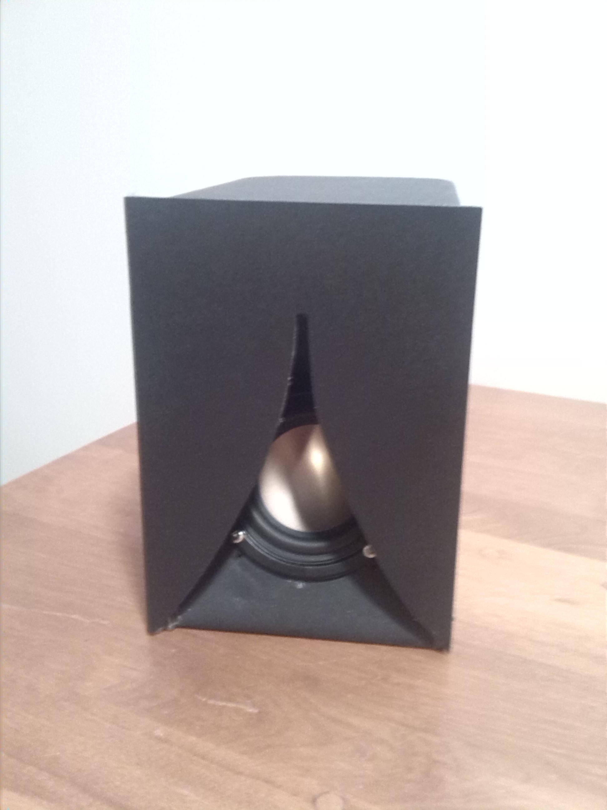

X, Finally got around to putting these together. In the end a very simple build with 2 pieces scored and folded (plus the aperture) per box. And quite a cute look.
The sound unfortunately is not so good. Running full range with no sub assistance near-field there is a real lack of bass and therefore balance - to the point of being unlistenable for me. I listen regularly to 0.4x Vifa Karlsonators and they sound enormous in comparison. As per the photo, there is a obviously a significant physical size difference, but the sonic difference seems even greater.
I tried them crossed 1st order at 150 Hz to a small sub and while this improved things, it seemed to highlight harshness in the top end. It think it might take some clever use of a dsp, which I don't have yet, to get these things sounding good.
The HiVi B3N hole pattern is the same as the FE85 and so I did a swap with one box. The difference compared to the FE85 was stunning - much fuller and balanced sound. While the "XKi B3N" was not as quite as good as the Karlsonator, certainly listenable, near-field without a helper sub.
So, overall a little disappointing as far as the FE85 goes, but I wouldn't mind pursuing the B3N further. Should it be suited to a XKi alignment? and what would be optimum enclosure dimensions?
Cheers!
Cheers!
Sorry about how it's not working out. I think we can safely say that the Fountek FE8x is not compatible with XKi. Thanks for trying it out though.
