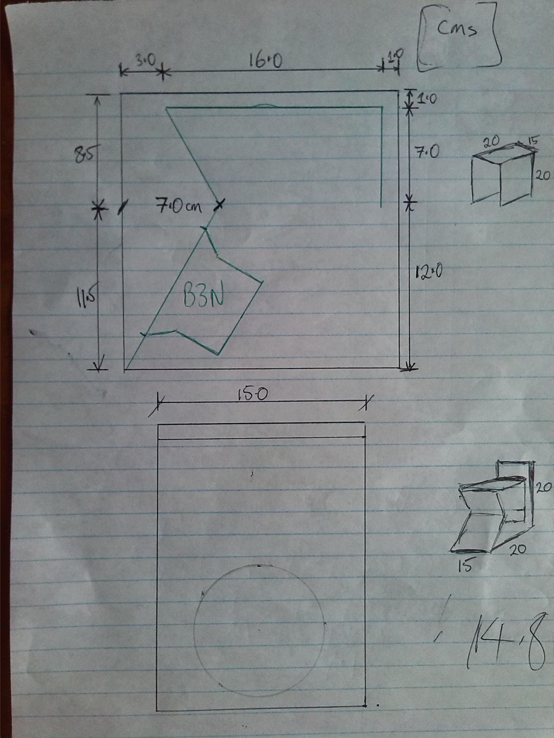

To first order approximation use a bass reflex calc to get volume and set equal to front and back chamber and vent set cSA and length for rear chamber but reduce length 15%. Set ratio of volume at 4:1 for rear to front. Better than nothing.
Excellent - thanks. I've worked out a box to try and will put it together tomorrow.

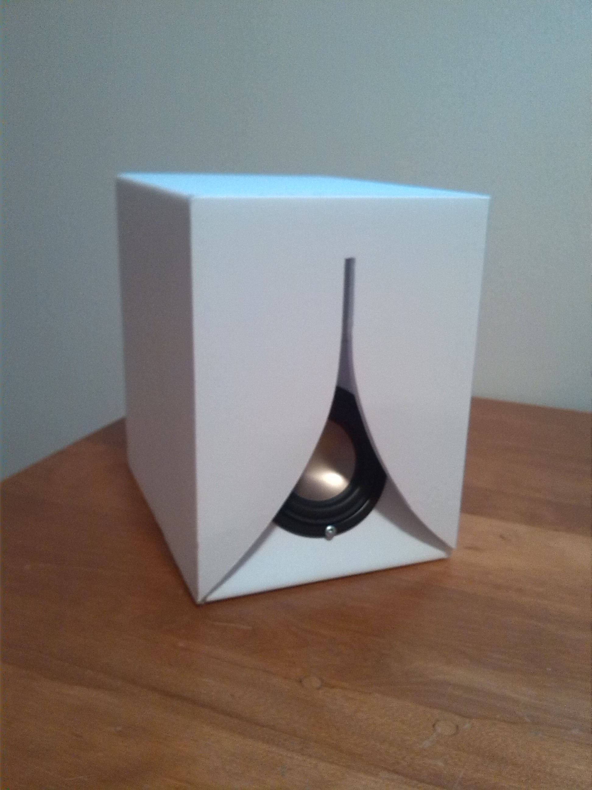

XKi-B3N
I put together one XKi-B3N box based on your guidelines and after a brief listen alongside the 0.4X Vifa Karlsonator I think it sounds pretty good. While it can't reach the overall loudness of the Karlsonator it seems to have about the same level of bass extension. Certainly good enough for me to use near-field without a sub. I'll go ahead and put the other box together and I'll try to take some measurements.
Would be very interesting to see how it sims and if I got anywhere near optimum dimensions?
Grandcalmar,
Very nice looking cabinet there! Glad it worked out better than Fountek. The 0.4x Karlsonator is a special box with amazingly big sound that is tough to beat.
