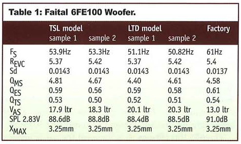

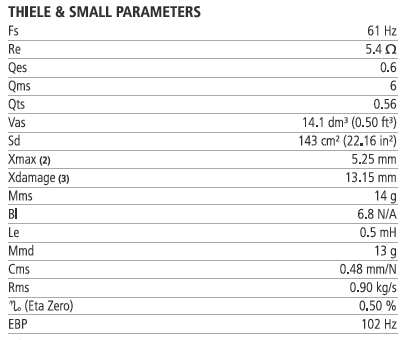

I wonder if my off-spec Faital Pro 6FE100 would do alright in a foam-core mSK8/XKi type? It has lower Cms, so Fs and Qt are naturally way up... I blasted them with some 20Hz for hours on end to no avail; I could have cooked an egg in that nice inverted dustcap. 🙂 A quick sim doesn't look promising, but a lossy cab material might help things with the high Qt as mentioned previously in this thread.
Factory spec:
Vance Dickason in Voice Coil magazine:
My measured specs (very close on both drivers):
