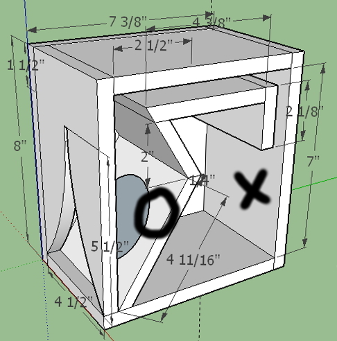

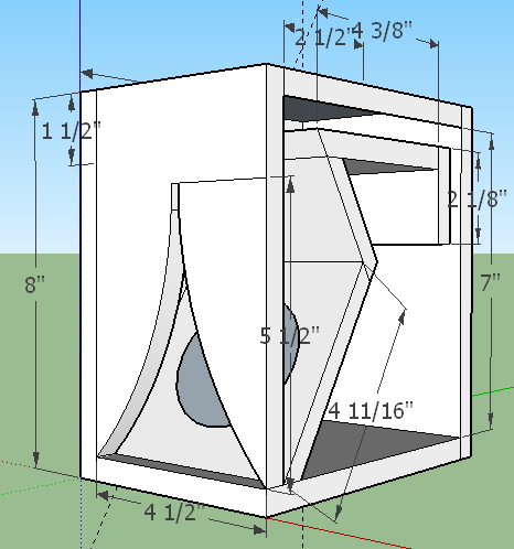

xrk971: does this look about right for Fountek FE83?. Does the cabinet make the speaker more sensitive?, increase SPL?, if yes, would be a good thing... I plan to use 1/2" plywood, any recommendation on stuffing?
Nice 3d drawing! Yes, the 6th order bandpass with a K aperture improves the max SPL by helping to control cone excursion so it will get louder than a bass reflex. It produces more bass that is directed to the front than a simple round bass reflex or slot port so in a way it is more efficient. The amount of bass is really the same but it will sound "bigger" than an equivalent MLTL or bass reflex box.
Add a layer of felt or open cell acoustic foam to the bottom and back behind the driver and add a small ball (uncompressed 6in dia) of polyyfill in the main chamber to help reduce the back reflections from coming through the driver and causing cancellation dips.
Nice 3d drawing!
was done in sketchup, let me get off my butt and cut some wood...

Add a layer of felt or open cell acoustic foam to the bottom and back behind the driver and add a small ball (uncompressed 6in dia) of polyyfill ....
layer of felt to backside of O or on frontside of X?
X - we are trying to stop the back cone emission from reflecting off the box Nd coming back to the cone.
On the inside of the K aperture panel, it may sound better with felt lining it. Some people prefer without. YMMV.

this is backside of O?
thanks,
