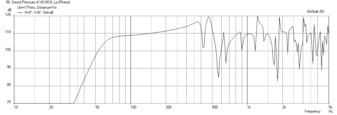

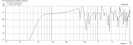

It's not too bad - the active volume is only 14 liters and 10in x 1.0in x 15in long vent, so the cabinet is internally 15in high, x 10in wide x 7.5in deep - with 0.5in ply the external volume is 0.85 cu ft. The fb is 62Hz and f3 of 60Hz with max SPL of about 108dB at 17 volts drive.
it would be almost the same size - a bit smaller than Karlson's Eight/"K8" and about an octave better on the low end.
Well, that's good to know that it performs better than a scaled down K15 or a K8. 😀 The K8 probably had better power handling and higher max SPL - although, if I tuned the XKi to 100Hz, it would probably be pretty high too.

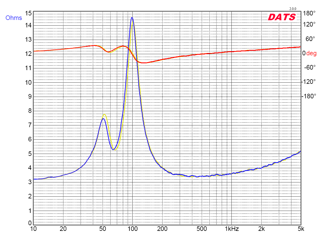

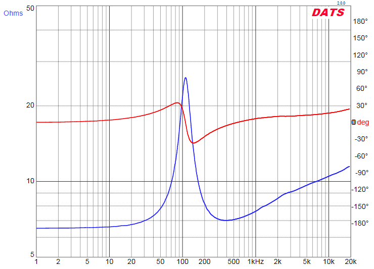

Did you sweep impedance RS100P sitting in there, or is the pressure not to be seen in such plot.

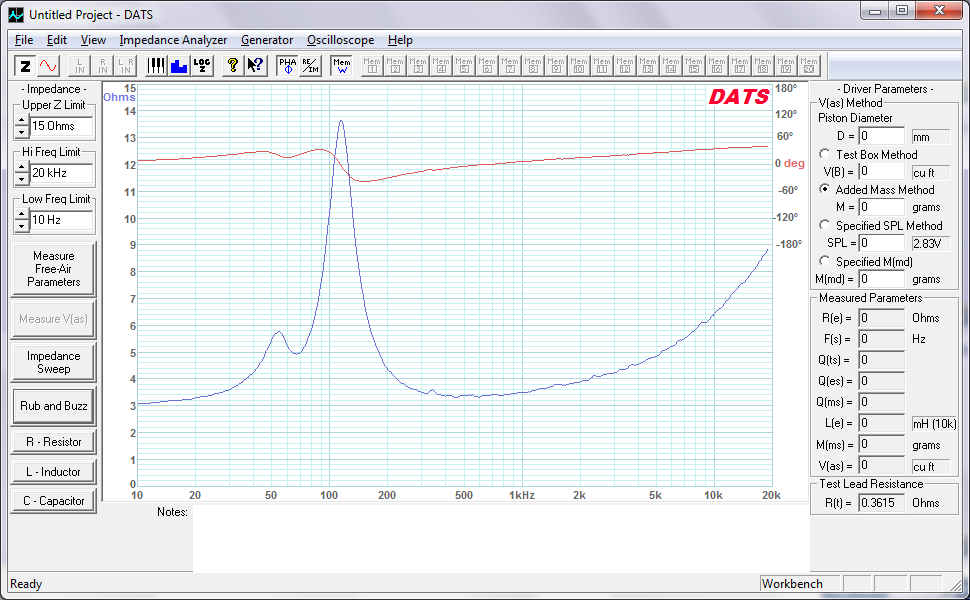

Yes, I sure did make a sweep with my brand new DATS woofer tester that I got for Xmas 🙂
I am just speculating about cone collapse but I do know that there is serious air volume pumping out of the narrow K-aperture.
Here is the RS100P-4 impedance measurement in the little XKi:
Thanks plot XKi/RS100P, at resonances area stroke looks strait and normal but from 320Hz and all up stroke has very small saw-toot form, could this be the pressure sign or inherent the driver also at free air. Example my A10.2 also have tooth but only 6 from 200-10kHz not those micro tooth all the way.Yes, I sure did make a sweep with my brand new DATS woofer tester that I got for Xmas 🙂

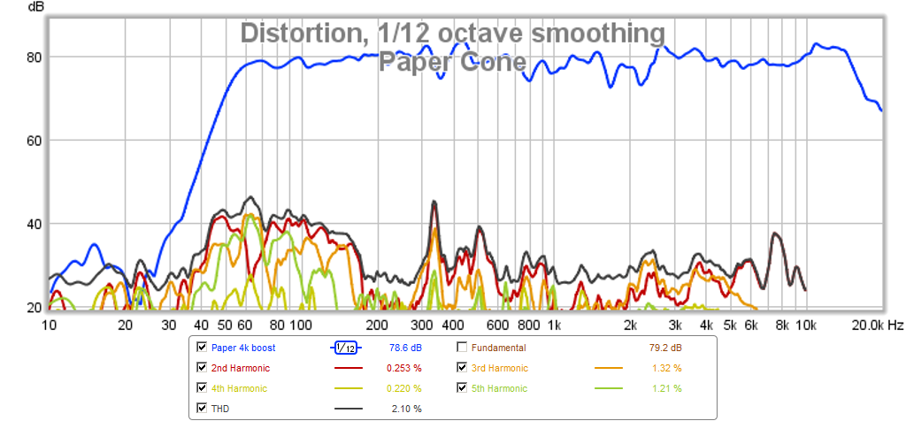

Effect of EQ boost on HF's to improve "Air"

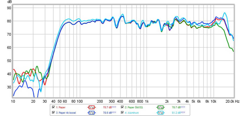

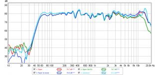

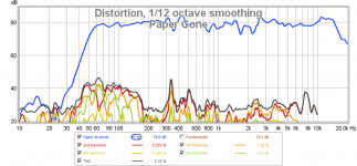

I tried increasing the boost in the upper frequencies to see if the sense of "air" or openess could be improved. I applied a +10dB high shelf starting at 12kHz with a Q=0.8. You can see the effect in the plots (dark green is the base, red is boost in 12kHz and up, blue is additional boost at 4kHz +2dB Q=0.9). The following clips represent the green (baseline case) and full EQ boost (dark blue). I also swapped out the paper driver with the aluminum cone and noticed that the aluminum cone has about 2dB more bass and the HD plot is cleaner. But all this comes at the expense of a ringing impulse response. See the IR's for the paper and alumimum cone below:

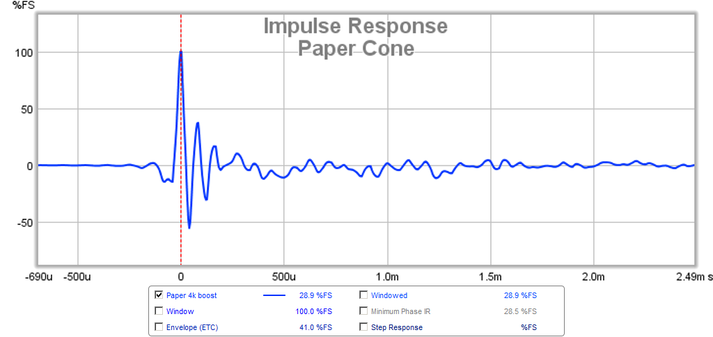

Paper IR (with EQ boost):

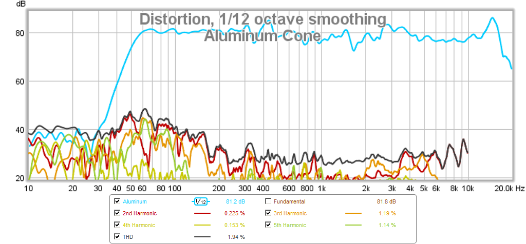

Harmonic Distortion (paper):
Harmonic Distortion (aluminum):

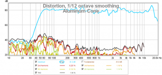

And here is what the aluminum cone sounds like, I think there is sibillance: http://www.diyaudio.com/forums/attachments/full-range/461450d1422175098-xki-xs-ab-initio-karlson-6th-order-bandpass-xki-rs100p-4-rp-alum-eq-boost.zip

yeah - sibilant - can you apply maybe 3 thin and small strips of cellophane tape to the cone? the bass is remarkably good
Neat idea Freddi - cone treatments - never thought of that. Pretty reversible too. I will give it a try and report back. Maybe this may be the saving trick.
Yeah, the bass is remarkable - cleaner and lower HD than the big 5in Tang Band in a sealed Hypercube.
I suspect the HD of the Al cone is better than paper when I swapped drivers I noticed two driver screws were undersized and a bit loose. I swapped for bigger ones and tightened. Must be basket or baffle vibration.
I am going to have to revise this design based on practical consideration of how big the magnet and rear side mounted compression driver is - it won't fit in this small of a box. As a result the volume will be larger with more bass extension but probably less power handling. I have a Beta 8CX and PRV 280Ti ordered and on the way. Hopefully will be able to test this out.

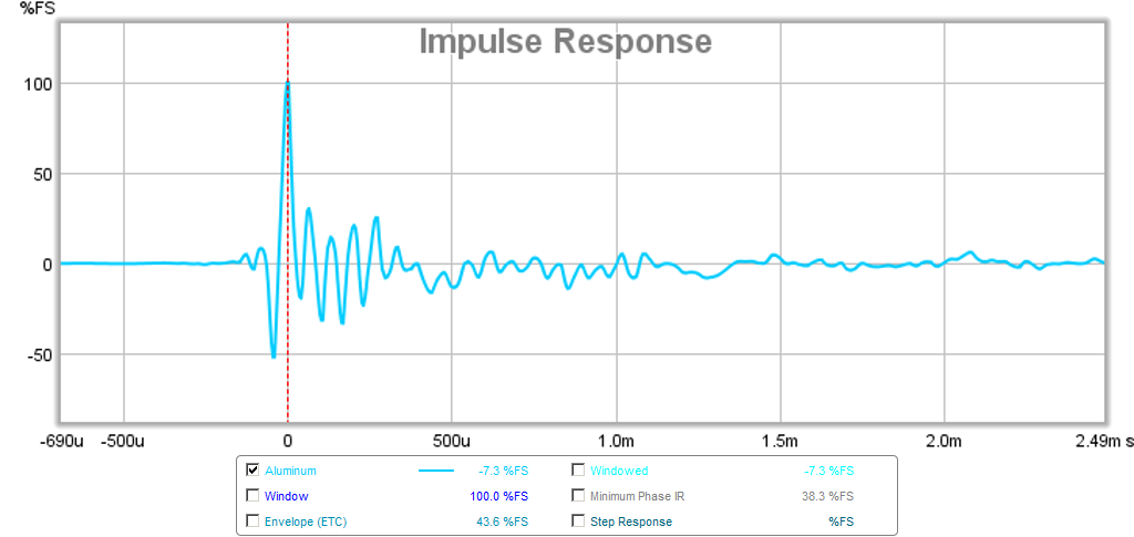

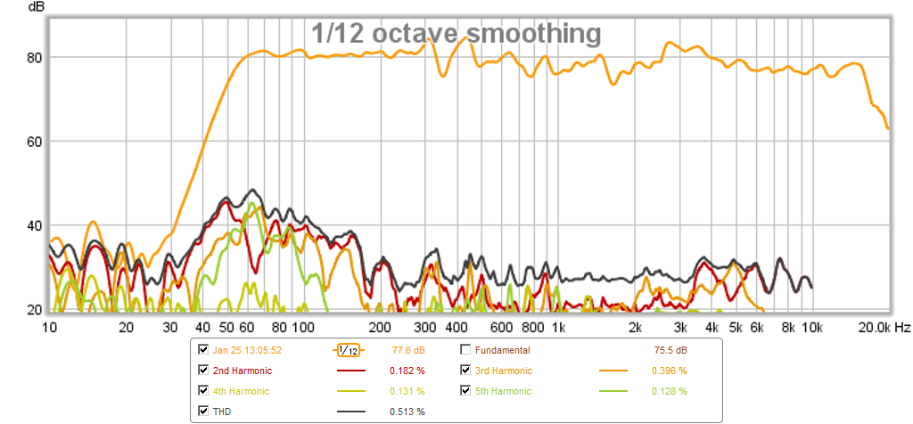

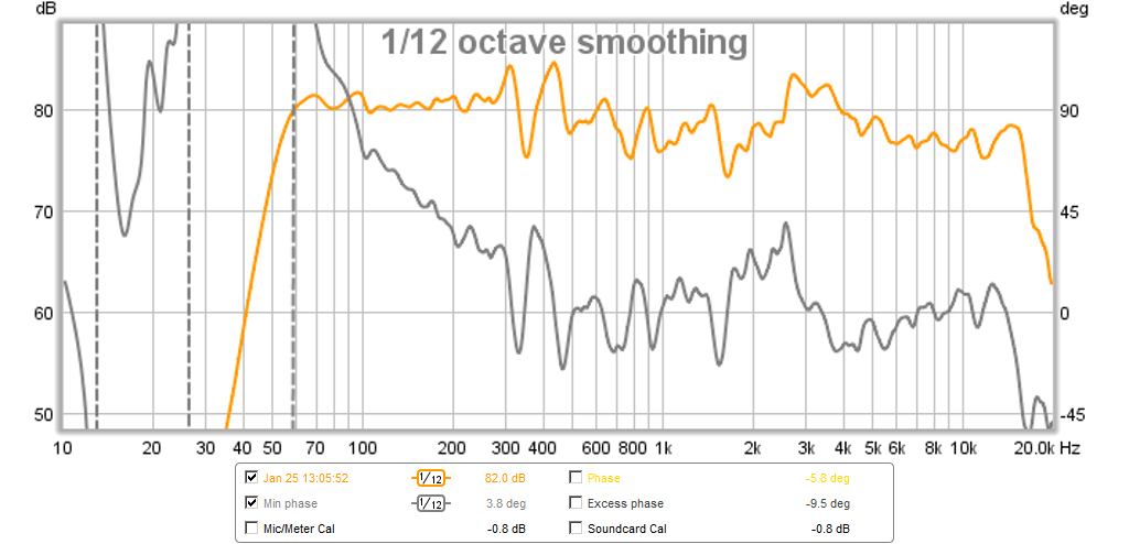

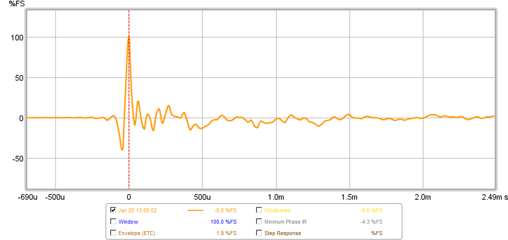

Added 3 little strips of smooth scotch tape in a radial pattern on the aluminum cone, plus reduced the "air" EQ boost and it seems to have cleaned up the ringing considerably.
Here is new response and harmonic distortion:
Impulse response:
Minimum phase:
Sound clips to come but I don't detect the sibilant sounds anymore.
Impulse response:
Minimum phase:
nice distortion figures - - re: calculator - it takes the preloaded data such as Beta8cx and does something when the "calculate" button is pushed -its difficult for me to see - I'm not sure how to work it in the simplest mode muchless other. If no port diameter is entered, does that shut off the respective port? - if you can run DOS programs and I still have them (?) there were a private versions of Bob White and Bob Bullock's BOXMODEL called DCBOXMODEL (dual chamber reflex) and BPBPBOXMODEL the latter, which IIRC could model BP6a and BP6b. It had a couple of bugs where data had to sometimes be entered twice to get the correct plots but was cool. I think it also may have handled some passive EQ cases besides active and the front chamber could be deleted to do direct radiator sealed and vented. There was a commercial program (expensive} - maybe "SpeakEasy" which did series and parallel bandpass boxes. What are the car audio guys using for BP?

Prefer the sound from the paper one without EQ verse EQed and the alu one.
Wonder if the EQ correction instead of being pure minimum or linear phase but corrected half by minimum phase and half by linear phase could do a trick in a natural way in the area where the driver is not a piston.
