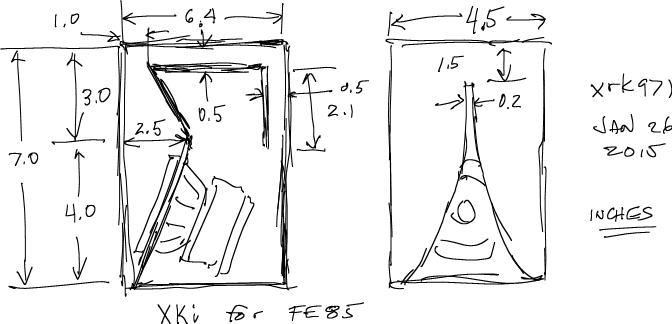

I really like this latest design and am wondering if the Fountek FE85 might be suitable? I have a set of four of them that need a project. The Qts, Vas, and motor strength seem to match the criteria - the xmax is on the low side though (https://solen.ca/pdf/fountek/fe85.pdf). If suitable, I'd like to use the design for a "boombox". Any thoughts would be greatly appreciated.

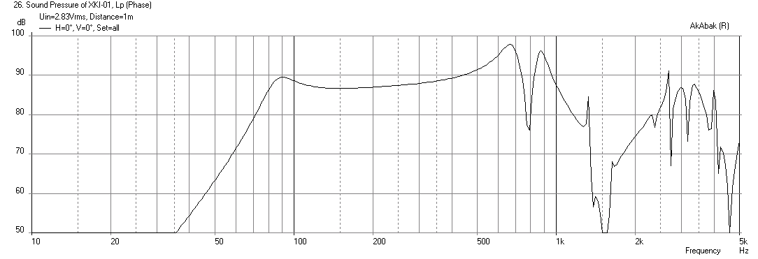

The FE85 makes for a very compact XKi but with 76Hz bass extension (f3). That is not bad for such a tiny driver - should sound quite good and is a tiny box that is only 4.5in wide x 7in tall x 6.4in deep (all internal dimensions). The vent is 4.5in wide x 0.5in high x 7.5in long (you can make it 8.5in if you want some more bass at expense of SPL).
Here is the plan:
Here is the predicted response using the 6th order band pass assumption before the Karlson aperture is in - disregard the HF's above 1kHz:
Good luck and let me know how it goes.

Freddi,
That looks like it should get you close. If you are good with HR, seems like a reasonable way to do it. There may be added effects of having exit aperture all the way on the end - it may take some TH action if the length is long enough.

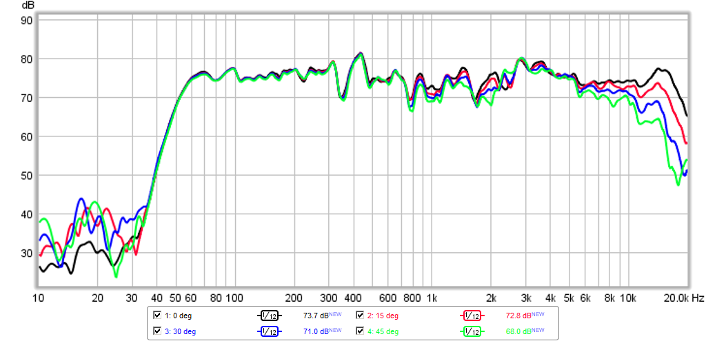

Polar of RS100-4 (w/ tape & EQ) in XKi
I repeated a polar measurement with the EQ'd XKi with the aluminum cone RS100 driver that has been treated with tape. Just wondering if the excellent polar response will still hold up. They still look great. Basically up to 10kHz there is a 5dB drop at up to 45 deg off axis.
I don't think I have see many speakers (or horns) do better than this.

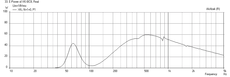

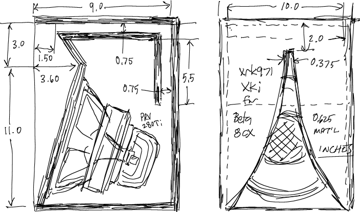

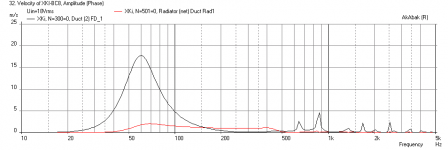

Revised design for Beta 8CX & PRV 280Ti
The ferrite magnet for the the Beta 8CX is pretty big and adding the compression driver makes the whole rear of the driver assembly stick back 5.75 inches deep. I had to add more volume to the Beta 8CX box to accommodate the extra stuff.
The new design is now 10in wide x 14in tall x 9in deep (internal dimensions) with an active volume of 17 liters. Using 5/8in thick material, this will result in a box with external dimensions of 11.25in Wide x 15.25in High x 10.3in Deep for an external volume of exactly 1.0 cubic foot. I tuned it for an f3 of 60Hz and it can hit 109dB at xmax.
Here is the sketch of the plan:

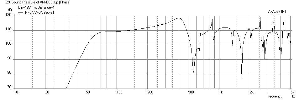

Here is the predicted max SPL at 17 volts drive to hit 3.5mm xmax:

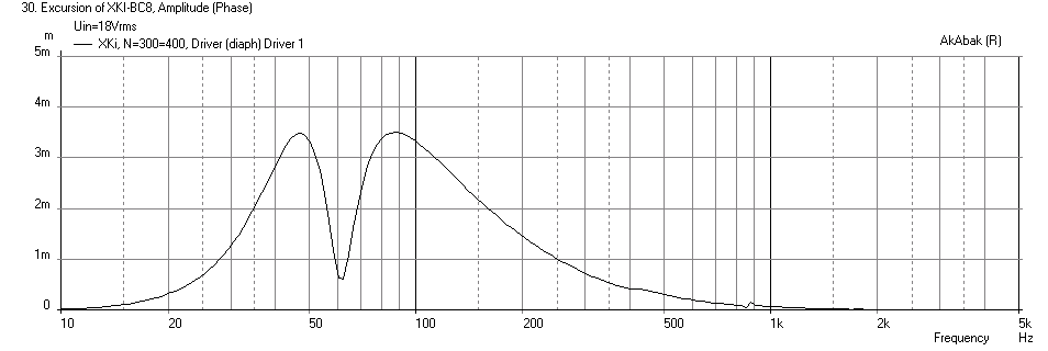

Here is the cone displacement with 51Hz -24dB/oct HPF:

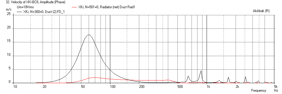

These are the velocities in the vent:

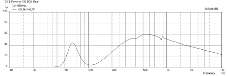

This is the predicted max electrical power - my TPA3116D2 can barely power this at the top end but I don't intend to use it near max SPL at home.
I think this may work out well, will build and report back (as usual, I plan to use active miniDSP bi amp setup rather than passive XO).
