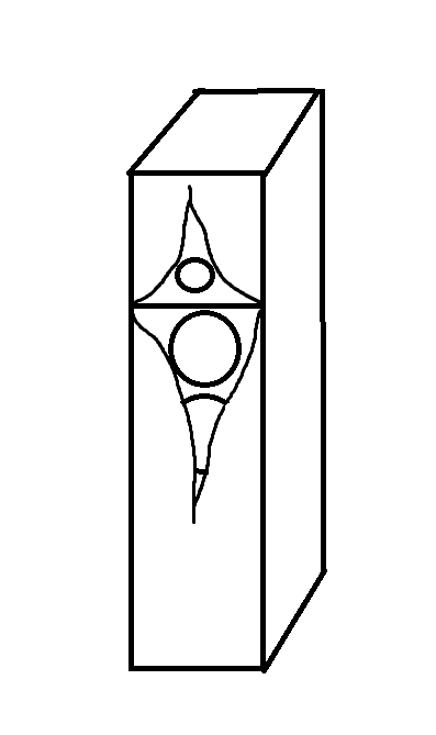

Do any of the Karlson based designs scale dimensionally? If the front/rear volumes and vent area stay they same could one design a taller narrower enclosure?
The XKi scales somewhat as it is based on volume and vent length and area. The K15 and Karlsonators require simulation to get the correct aspect ratio though and volume.

In a sense, most of Karlson's original designs were scaled from K15. In the January 1954 issues of Radio and Television News, he warned against scaling K15 by 0.8 (12/15) and at the HiFi fair of fall 1954 came out with the first Karlson Twelve (aka at the time as "Karlsonette" as the 8 inch model had another year to appear)
In reality a 0.8 scale K15 can work pretty well, but is a bit larger than the K12 series. Also, the front shelf may be shortened in a 0.8 scale K12 as that feature tends to deflect some highs from the upper regions of the front chamber.
The Karlsonette had a perpendicular port board. Also it had a unique feature of a movable 3-position "bar" on the inside of the back panel which was adjacent to the rear shelf. This made for subtle tuning adjustments of the chambers and the kind of thing to tune subjectively with drum transients.
Subsequent K12 used a 10 degree forwards tilt port board with distributive slit or hole array port. The full width rear shelf was split for most of the K12 series (that made a great rear panel brace) but made a comeback in a K12 kit enclosure.
Karlson with the regular lineup of K12, K8 and the X15 cabinet never used the front shelf again but suspect it was used in Karlson's 18 inch "console"
K12 are tuned around 62Hz small signal.
The distributed slit vent chokes up and produces high vent velocities and harmonic noise on sine input around tuning. With music transients, that doesn't seem to be much of a worry (-I might prefer a single vent for higher input power.)
With a higher Q speaker such as EV Wolverine, a K12 might sound overly warm mushy. With something like Kappa 12A, it will GRAB one's attention and beat some folded horn for focus and impact (not as loud but better pitch focus) - plus 3mm excursion (one way) speakers with good motor.will hold down 200 watt input peaks.
GragB's Karlsonator12 offset driver K-variant is tuned @37Hz way down from a K12 and should go as low as most K15 setups.
A K-tube with compression driver is a great way to have treble vs horn.. (See ReinoutDV's K-tube plus Field Coil thread in the Multi-Ways forum) XRK971's work with 3 inch drivers shows speakers of that size range can exhibit very wide horizontal dispersion - so a dedicated K- "Kone" tweeter is possible.
I think a little 6 inch K15 scaled by XRK971 for a particular driver plus a sub would make a nice system. The Karlsonator6 too as was very good with a modified Fostex FE164 and also with LCao F6. (the Fostex wins for attack as has a stronger motor)
