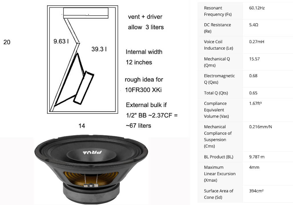

hey X. - I think PRV's 10FR300 could make a good bang for the buck fullrange XKi in a reasonable size box. 40 liter rear chamber
is larger than what lower Q could make but still not too big. What dimensions would you use for this approximate alignment ?

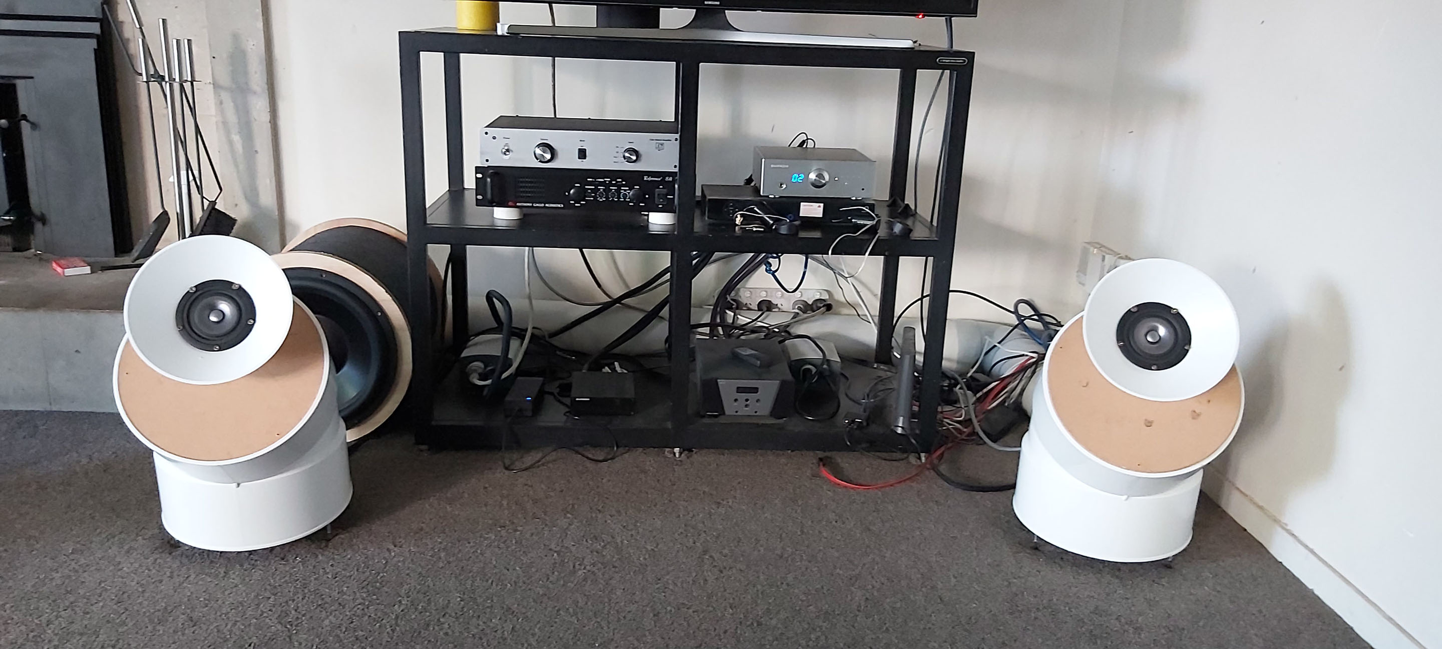

Back from our summer hols - we in the southern hemisphere have Xmas and New Year during the hottest months which is kind of nice, though I guess snow would be too - and I decided to try something a bit different from the Karlsonator, reverting to a woofer-assisted wideband design in a PVC cylinder bend but with homemade waveguides. I guess I just wasn't getting enough oomph from the W5 Tangband.
So this design just uses an inductor on the 10-inch RS270P-4 Dayton woofer and no crossover for the Mark Audio 7MS. The waveguides I constructed from lamp shades; just shave off their bottoms really with one of those multitool vibrating saws that nurses use to cut plasters off broken limbs.
Suffice to say the bass is back, though that's largely due to the fact that I can biamp these things, the Burson Bang for the 7MS and a 125wpc DIY audio design for the 10-inchers.
I like the improved staging with these too, there's real depth now and better imaging than with the Karlsonators. I'm not sure I have the right sized inductor which is set for around 250Hz but I figured start there and head back down. Might try 150Hz next; guess it is best to let the 7 MS do as much of the voice as possible. Any suggestions re optimal x-over point would be welcomed.
They're not quite as aesthetically pleasing as the Ks but they are certainly different. The Mrs hasn't seen them yet....

they look very pleasing to my eyes. The waveguide should work very well - what lampshade in particular did you employ?
here's a rough idea for a PRV 10FR300 XKi. I don't have hornresp so don't know what length the duct should be if 12 inches wide by say 1" tall (?)
10FR300 has 2mm xmax by overhang and "4mm" xmax including 0.25X its 8mm gap height. The other inexpensive FR would be Visaton's BG20. I'm not sure what it would require space wise.

The waveguides are just cheapy $4 lampshades 25cm in diameter.
They're surprisingly okay to work with; the plastic doesn't tear and they're quite flexible, easy to cut and sand. I used to make holes for the screws to pass through but now just cut out small squares with the inner side open because you don't see the holes anyway.
Today Im trying different inductors, to bring the upper level for the woofer no higher than 115Hz. I think a bit much voice is getting through to the woofers at 250Hz cutoff and they don't do voice that well seemingly. Hopefully the MA 7MS will delve down that low. They are in their own little enclosures within the cabinet, which is otherwise sealed.
Im quite enjoying these and they're very easy to make; will create some nicer circles for the baffle at some point as those were just ones that were hanging around.

The low pass cutoff fogure of 115hz sounds much better too. I just happened to have a pair of 5.6mh inductors on hand.

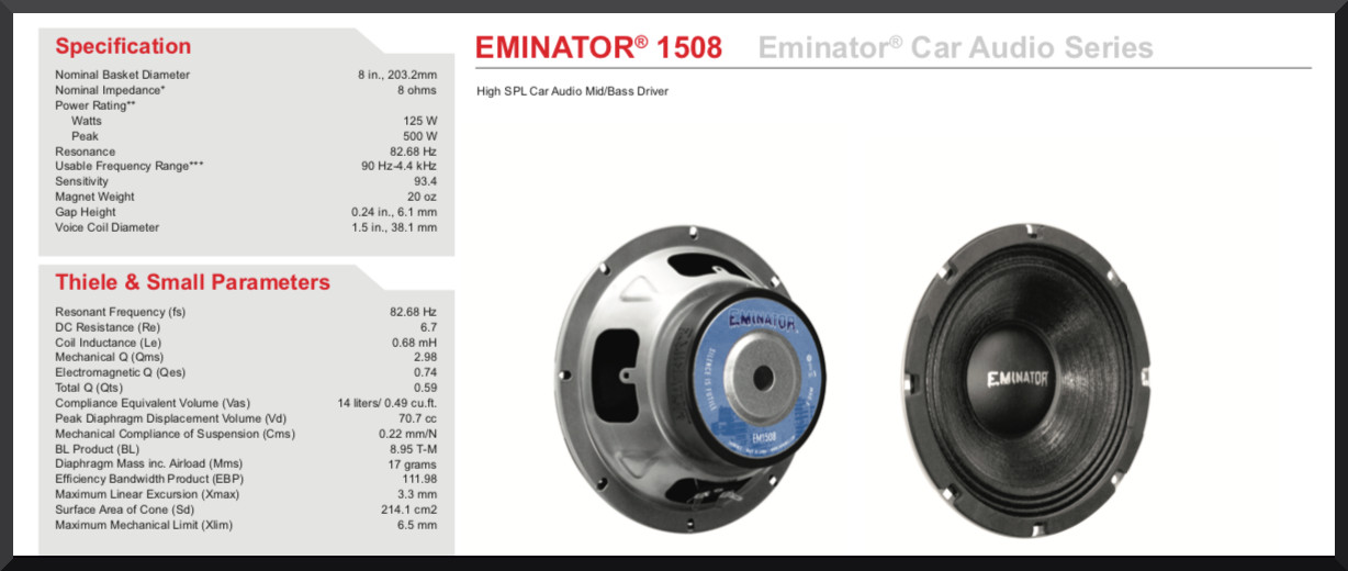

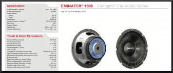

got a couple of Eminence 8 inch back when they were selling for $15 new each shipped.
Maybe one or two could make a punchy XKi boombox? Q is kinda high but
Vas is only 14 liters. It would not need to go "low" as a boombox - just low enough to give some semblance of bass and some punch in a reasonable to carry size.
