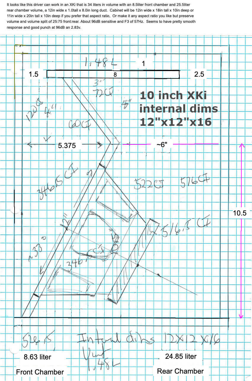

hey X - - regarding your suggestions of an XKi for my P-Audio SN10C does this sketch look close enough?
The suggestion was 12"x12"x16" internal
I think there's about 23 liters in the rear chamber after driver displacement so a bit undersized vs 25.5 liter. The front is about right.'
How far would you gap the front edge of the vent to the inside of the aperture?

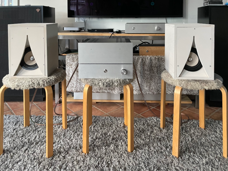

Finally completed my little K5 cabs modified to add an XKi style duct feeding the shelf vent already in the cabs. The drivers are PA130-8s fed from a 50w x2 Chinese Bluetooth amp. I am sitting here listening to Amy Levere who accompanies herself with a contra bass. The bass is incredible for a 5" speaker in a small cab. Evaluation is subjective as I don't have windows or test software.
I experienced an interesting illusion. Anxious to hear the K5s I just had them sitting near my feet and was listening as I read a book on-line. It seemed that the sound was coming from across the room and I really had to concentrate to place its origin at my feet.

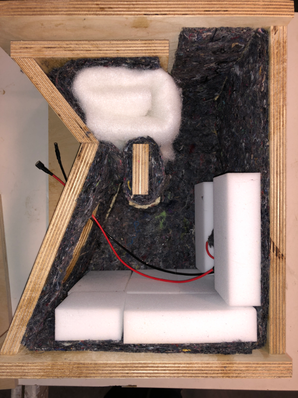

The only short screws I had on hand were ¾" flat head #4, not the best for easy driving or removal. I will pick up some ¾" Phiilips or square drive pan head #6 so that I can easily remove the rear panels for padding experimentation. I only lined the speaker chamber with felt (laminate floor underlay)for starters.
I tried to make my "sketch" of a 10 inch driver XKi more legible.
What do you think of the vent and front chamber shape? - it was suggested years back by XRK971 to use an 8 inch long vent for Delta10A. I might want to use this cabinet with the 10" "pro" Tymphany driver.
Besides the front chamber and vent, how would you do the taper panels and their starting gap?
With half inch material it should be about 13"x13"x17" tall
If you run a bass reflex calculator for the rear chamber and vent dimensions, that should work. No taper on vent, just straight parallel wall. One thing to be careful of is vent resonance frequency with longer vents. 8in long vent might cause a dip at 840Hz (1/2 wave). But usually not a problem as Karlson “W” is around there anyway.
might it help any to cut the duct length to say 6 inches - ? - - - cut a "V" or "K" notch on its back side. - ? Shelf vents often tune ~15% lower than some vent calculators show.

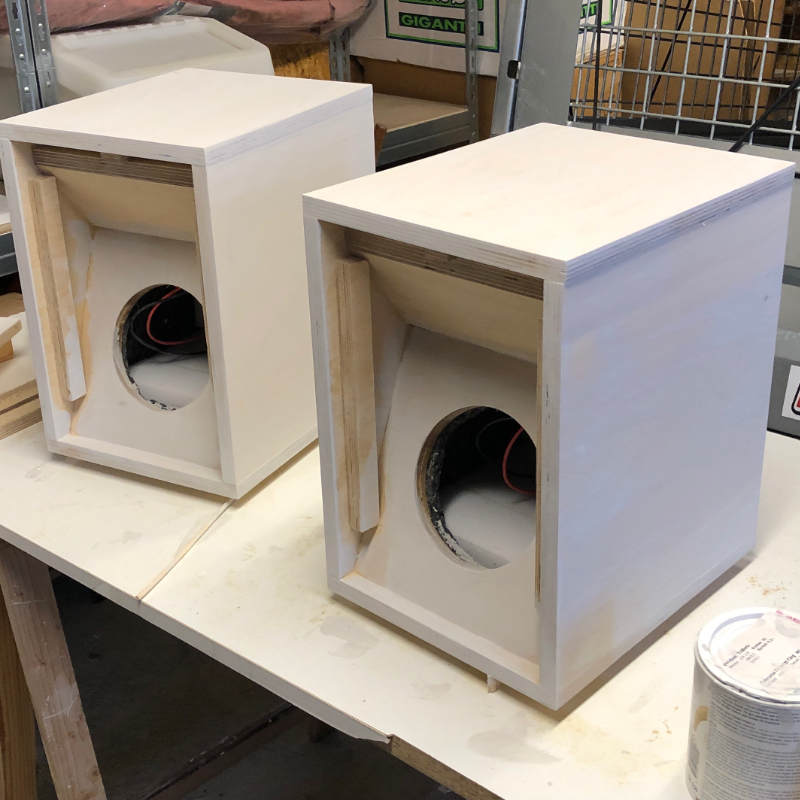

I had a listening session halfway through painting. The speakers have awesome bang and clarity for the buck. Here driven by B1K + ACA. I was surprised how well defined and low they get.
My woodworking skills have become better but need improvement. I had to do everything by hand without table saw.
I thought a report was in order for a thank you for a rewarding project.
Som pics in progress.
sov. that's a beautiful build - good idea for damping material placement in the upper rear cavity too.
- did you have a powered circular saw? - - or literally a hand saw?
