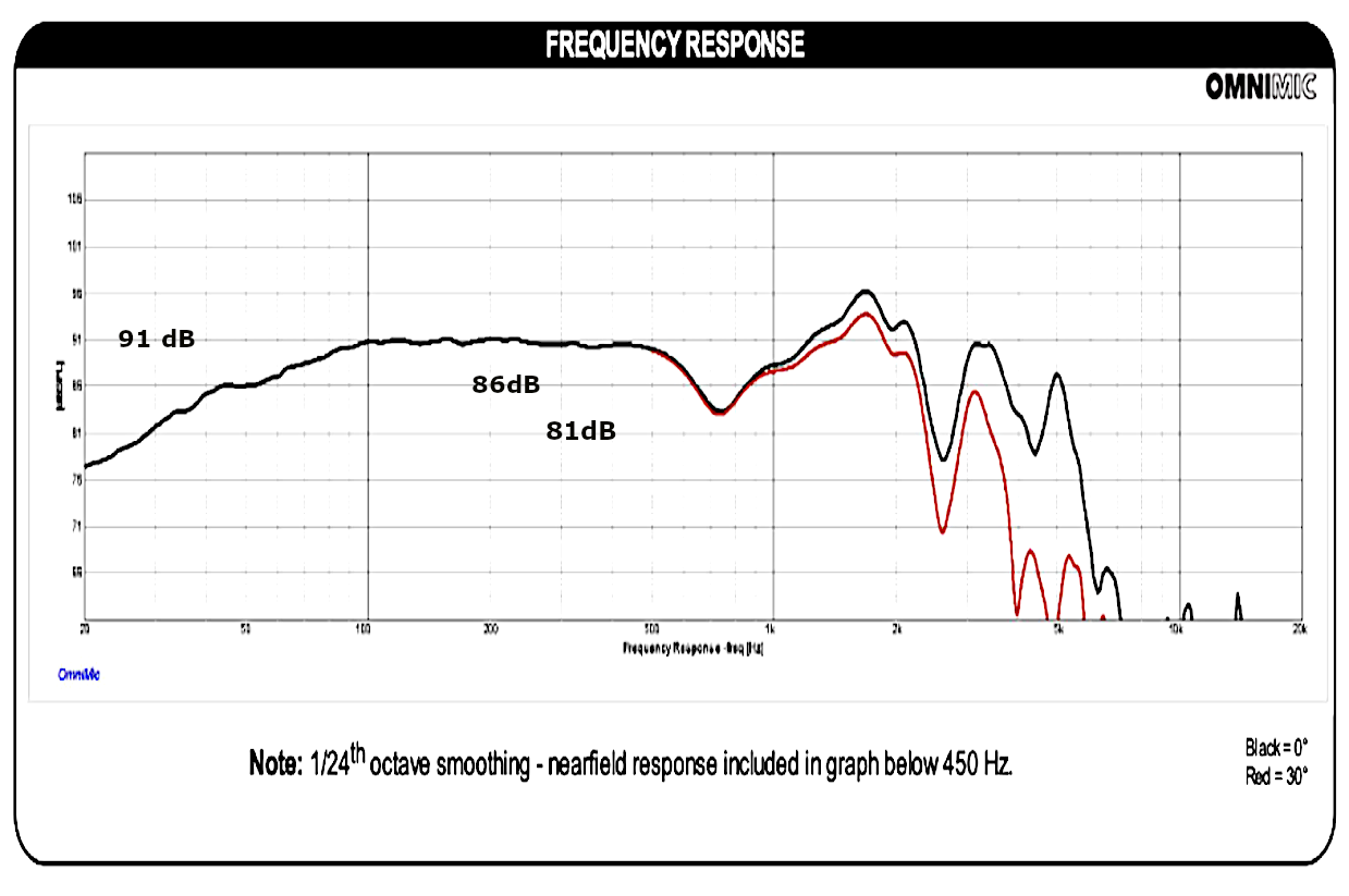

if maybe a "FAST" or a 3 way - - FWIW I don't like the looks of that ~7dB dip. PE's graphs are a PITA for my old eyes to read. It's 5mm xmax is attractive if pounding bass.
Beta 8A should be smoother. There might be better choices overall for the same money or less. PE also has a midrange version of similar motor used by Community,
That dip doesn't concern me as it's above 500hz and I would be crossing it over well below that. This would be more or less a party woofer to complement a full range driver without much extension below 150. I'm just looking for punch for dance music that would work well in both open and enclosed spaces. I have run cheap single reflex 8 inch PA speakers at outdoor receptions and garden parties and they gave me adequate thump for the situation, and I'm assuming an XKi would perform better in both spl and extension. Room acoustics indoors will only help I would think, and I will have the ability to EQ for either. My goal is a lightweight build that will hit the sweet spot between size and output. Tapped horn design like a Spud would be larger than I'd prefer and single reflex ported would be less efficient. XKi seems like the best compromise? The low Fs and High Xmax on that Eminence 8 pro along with the low qts and rms power handling near my limit all make it look like a good candidate but I'm open to other options. I didn't see any T/S parameters on the volt-8 woofer and the Fs and xmax on that delta 10 look high and low, respectively.
