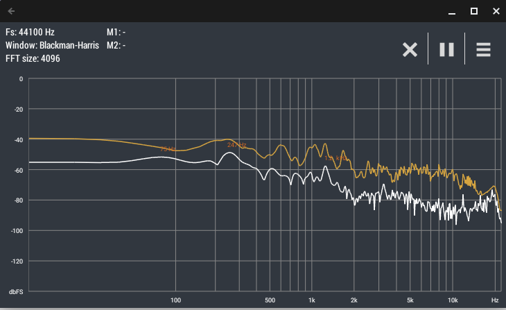

I could easily do that as my felt is vinyl backed and easy to cut w/electric scissors. Testing would be subjective. I down loaded a SA app but it looks strange on the low end. The pic is with a Sony boombox playing in the kitchen and I am in the den.
