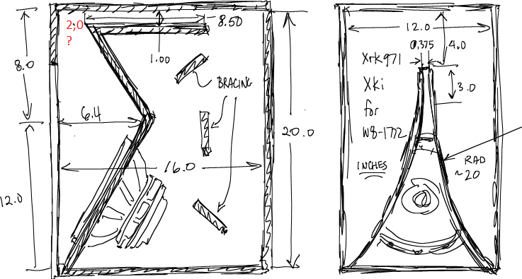

has someone already built an XKi with a TB W-1772 and there is a drawing about it.
Kind regards
Kind regards
- don't know if one has been built yet (?). XRK971 sketched details of a rather large version

thank you Freddi,
if I would build the larger version.
I want to come under 50 Hz, is that possible.
Here's X's post with sims of that 1772 cabinet from six years ago. He stated 43Hz - f3
https://www.diyaudio.com/forums/ful...-initio-karlson-6th-bandpass.html#post4198019

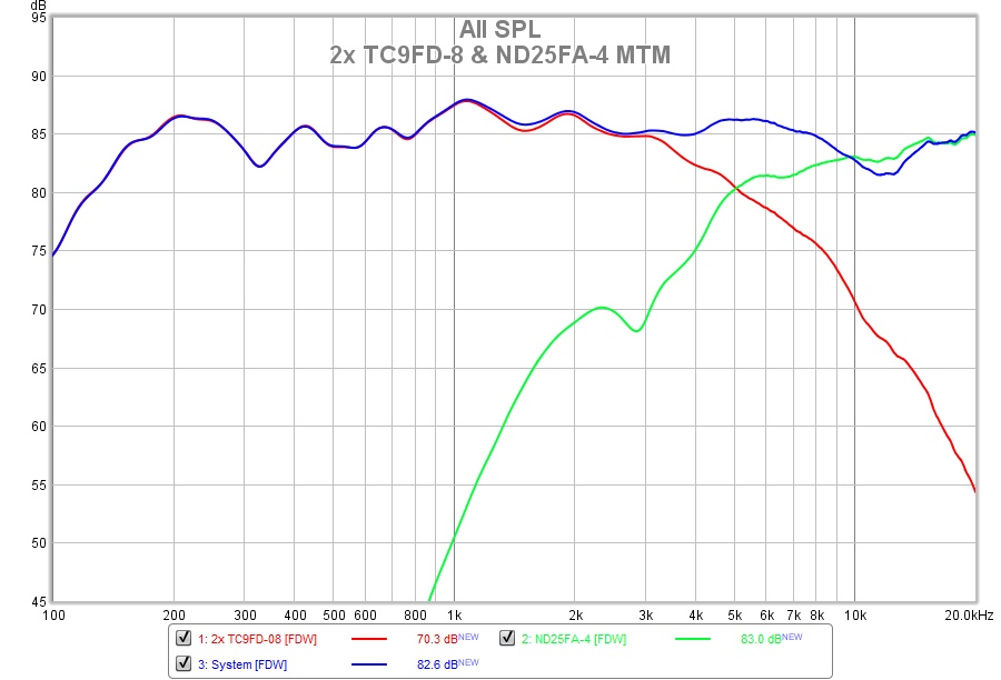

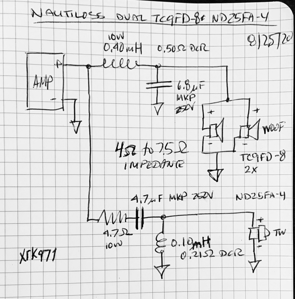

For the center channel I would do this as low profile and intelligibility is important.
Dual TC9FD and ND25FA-4 in MTM sideways sealed box. About 4 to 5 liters volume line walls with melamine foam and stuff with fiberglass. Use this XO:
Measures well and sounds great:
The Nautaloss Ref Monitor
