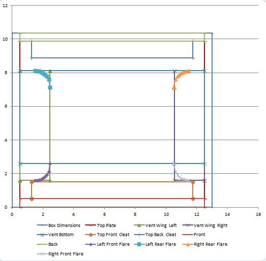

I cannot answer the question about smoothness. About all I can say is that the more or less cubical version has smaller panels and I would expect higher frequency panel and column resonances. The XRK design has some flexibility, but about the tallest that you could make the cabinet and maintain the tuning and volume ratios is about 20 inches tall, 13 inches wide, and 10.5 inches deep. Even that requires the flare radii to be reduced to 1 inch to fit in the top space. I got by with one side to side panel brace in the rear chamber in my short cabinet. This one would probably require 2, and perhaps one on the back. The speaker basket diameter limits the width. This cabinet design comes closer to golden mean ratios.

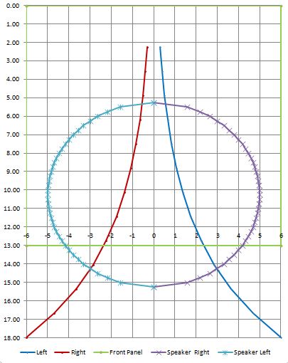

Regarding apertures, Karlson had them visually just over lap a speaker's surround and not the cone. Most of his cabinets had a radial arc swing to form the aperture. X15 deviated with a flare which opened faster - perhaps to accommodate the K-tube's output.
Below are two extremes I've tried for aperture. FE206EN was "bright" enough to play ok with the tighter aperture. Since the port was not at the top, I don't think there was a significant shift in Fb with the tight aperture vs the fast opening one. With a port towards the top, and aperture tight at the top, I would expect some downwards shift vs faster opening aperture (and wider starting gap)

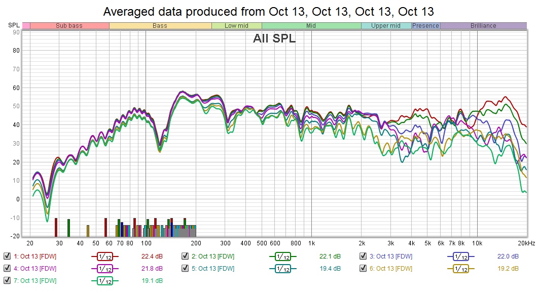

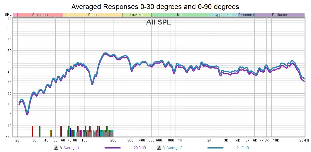

In response to Freddi's questions:
1) I do not do Akabak, and there is no need to simulate when you can just measure the existing speaker.
2) I have done the measurements at 15 degree increments from 0 to 90 degrees at 1 m from the centre front of the cabinet, posted below.
3) I have also calculated the averaged 0-90 and 0-30 degree average responses showing the total off axis and front listening window responses, which also show good response characteristics. This is borne out with listening experience.
4) I would conclude that the 5/8 inch minimum aperture is not too small, and there is no need for an additional tweeter.

that's an impressive set of measurements - - How would you describe those vs what a similar driver would do as a direct radiator? How do you like its sound presentation? Many folks seem leery of even a square edged direct radiator cabinet muchless the idea of a speaker sitting back in a cavity.
With the "heritage" Karlson, at least with K15, K12, I think the front cavity did some real work in the upper bass region.
yes--2 dB--as seen on the left axes on the graphs
not bad for in room measurements in a cluttered workshop.
the reverberant sound field listening experience is quite smooth
the direct speaker measurements are probably beamier - especially above 8 kHz
I also like the loo]k of K15.12 and 8's radial arc wings' aperture. Oldfi's aperture being smaller in proportion for a given driver diameter will do wider horizontal spreading than a traditional K-opening.
X15's aperture, at least mine with the large diameter K-tube, deviated from a a pure radius arc. In the poorly named BASIC routine below (with formula from Carl Neuser}, it would be described with P=1, Q=1.7
maybe someone eventually will make a stand alone routine. Using a flexible steel ruler would work and think that's the way Moray James did with his 1/4 wave K T-line boxes.
Subjectively, some experimentation may produce the best overall sound for a given driver. My little K18 with tight slot needed a larger starting gap to sound really good. There was very little difference in how it graphed. I think that's as the mic just doesn't deal well with the aperture's sound field.
if you can get a free version of BASIC to run and screenshots then that routine above will crank out an aperture's numbers given aperture height, starting width, final width, two parameters to enter, and vertical increment desired.
