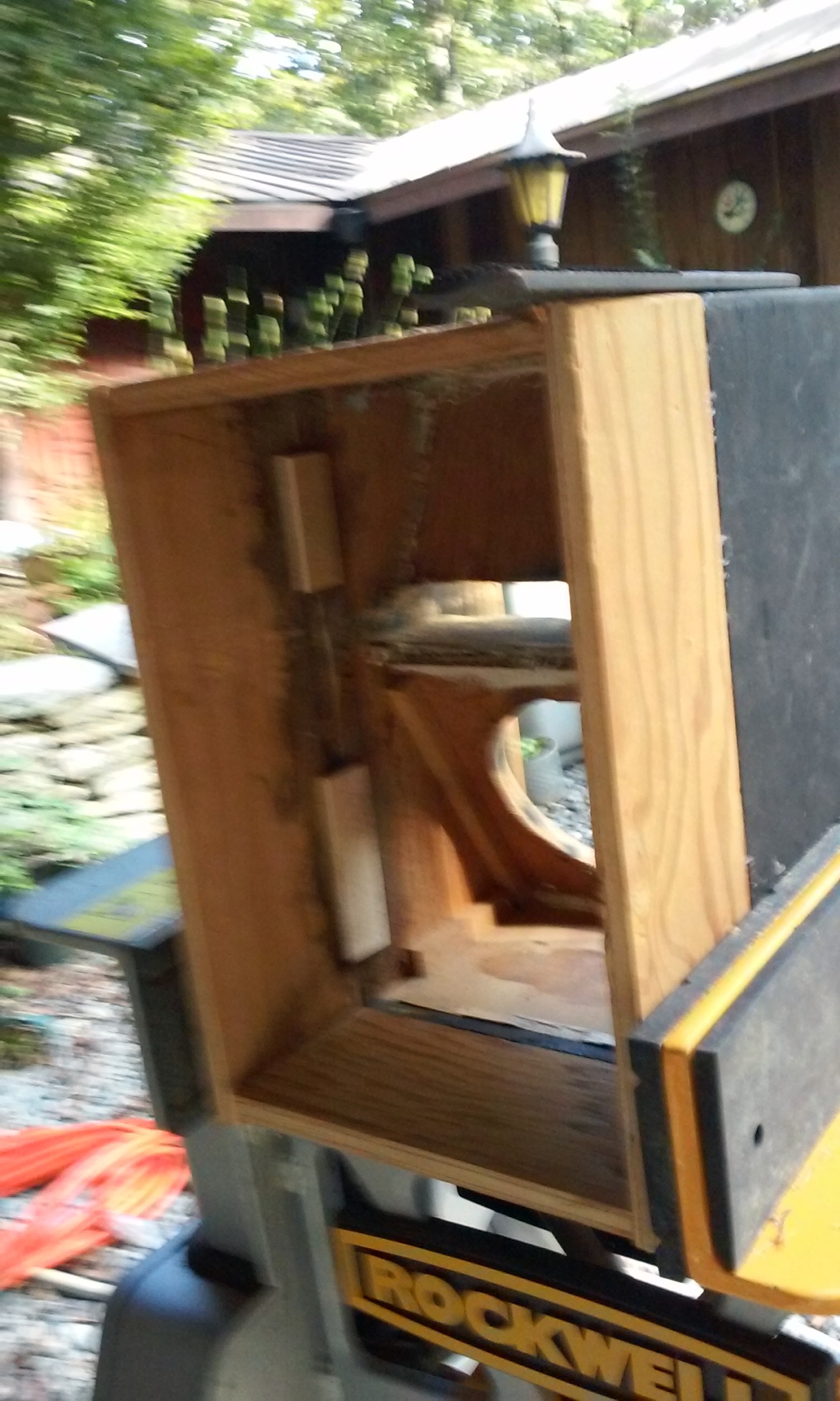

The Jaw Horse holding the box made it a lot easier. The slot vent is now ¾" high, next comes duct work and exterior filling, sanding and finishing.

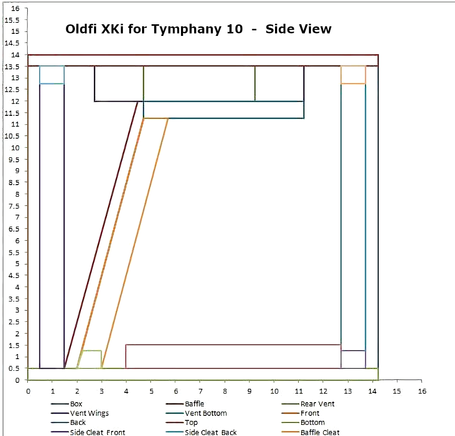

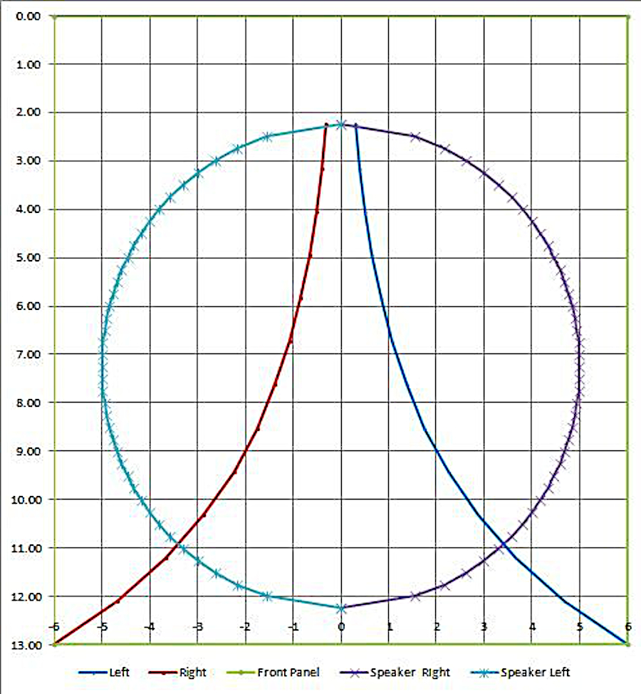

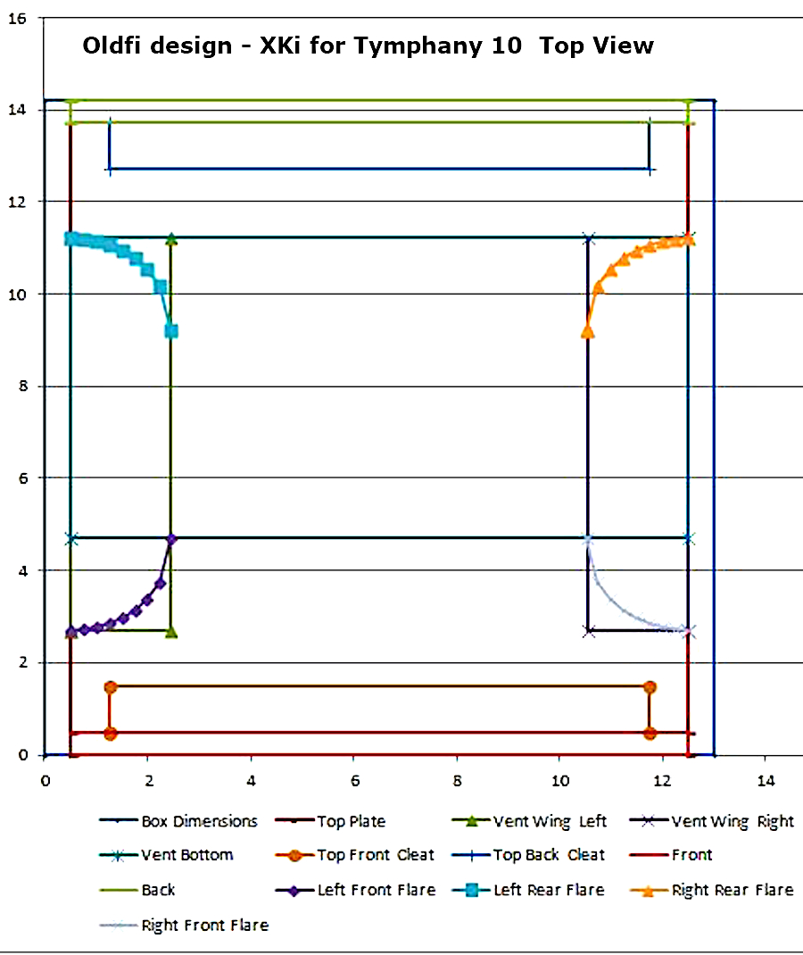

The XRK design method comes up with the best compromise to live with the restricted Xmax. The best I could come up with was a 25 l back chamber, with a 6.25 l front chamber, which requires an internal set of cabinet dimensions of about 12 by 12 by 12 inches. The front Karlson coupler is about 9.75 inches long - starting about 2.25 inches from the internal cabinet top. The front to back tuning port is 1.5 inches high and 8 inches wide by 4.5 inches long , with flared ends. The fit of the speaker on the baffle is tight, top to bottom, but could just work with these dimensions, otherwise the cabinet would have to be made slightly taller and less deep.
Many Thanks - That is pretty cool - would be thrilled if could get some "hit" and perhaps LF down to 80-ish Hz. A rough sketch (side and top views) could help on the port spacing, baffle, etc. I assume there's no "upper board" above the slanted baffle. (?)
The port is built into the top plate (1.5 inches = two thicknesses of 3/4 inch plywood, with a 3/4 inch plywood plate underneath, which forms the bottom of the port, and the top attachment point of the slanted baffle). You are correct, there is no vertical plate, the baffle just attaches, with the mouth of the top port above it. I could try to get a picture of the cabinet design out of the EXCEL spreadsheet. I will see what I can do.
MANY THANKS - fantastic work and programming
Here's the plan with images at 900p width
