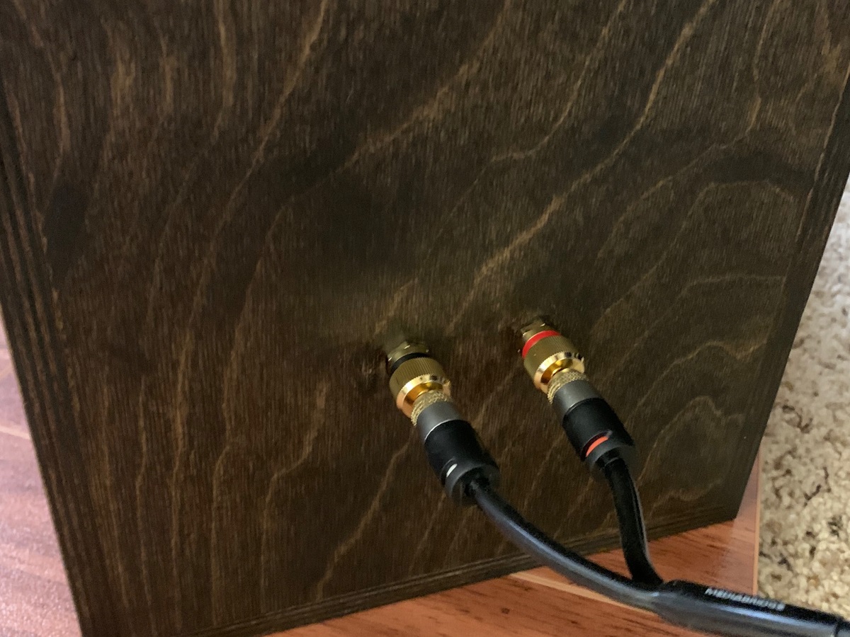

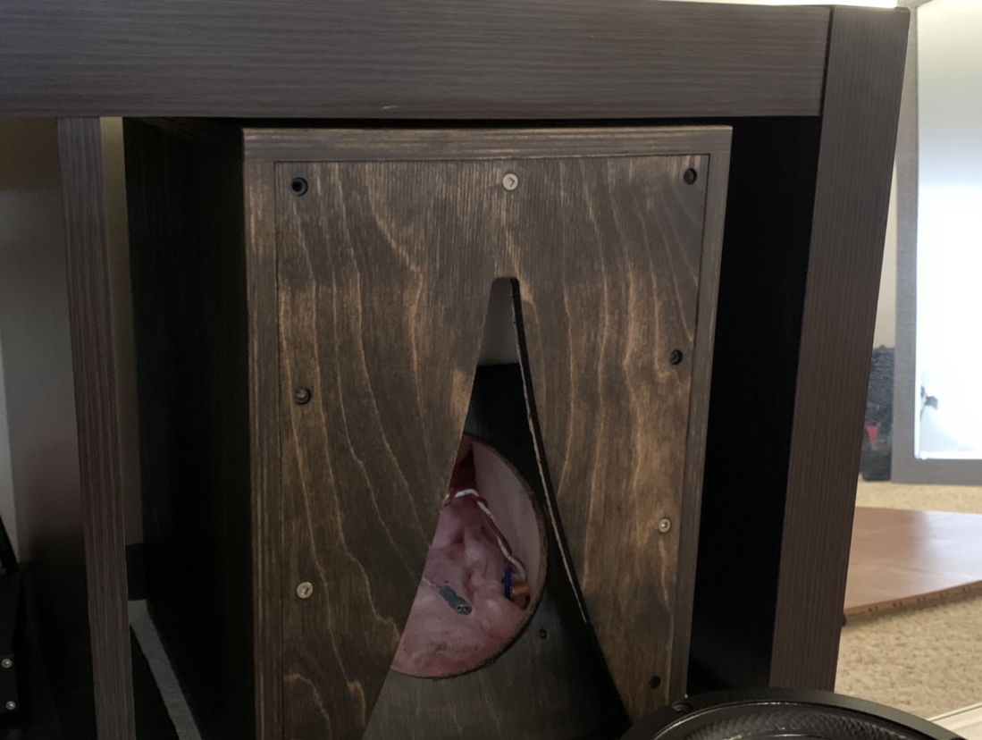

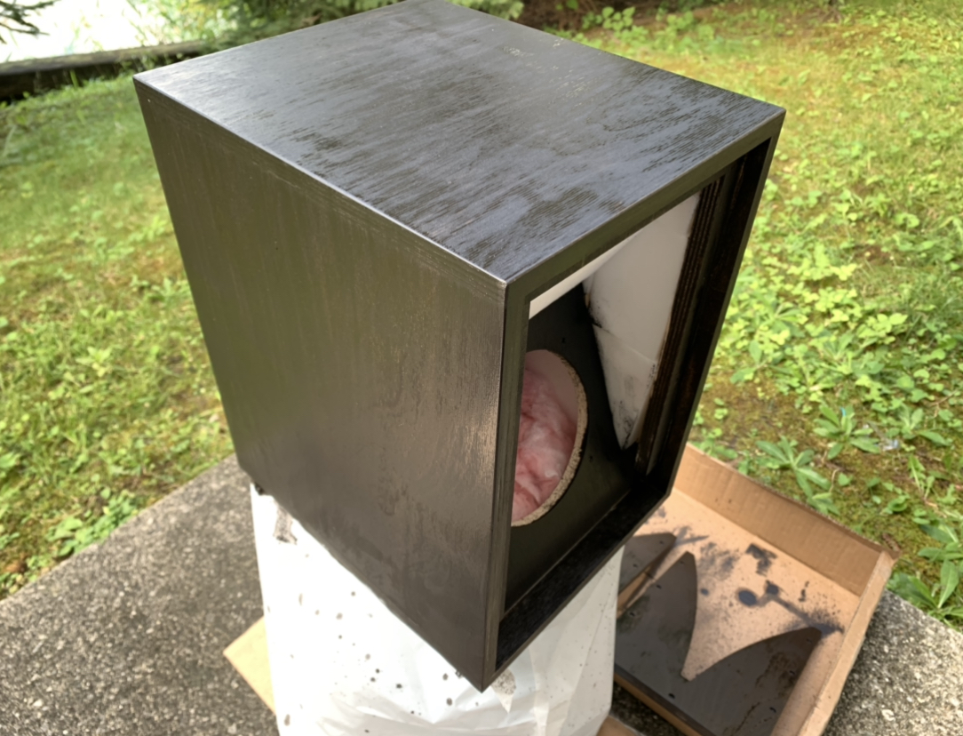

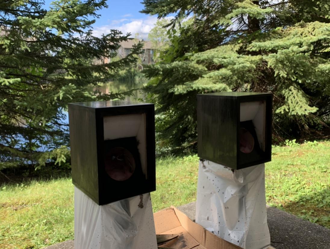

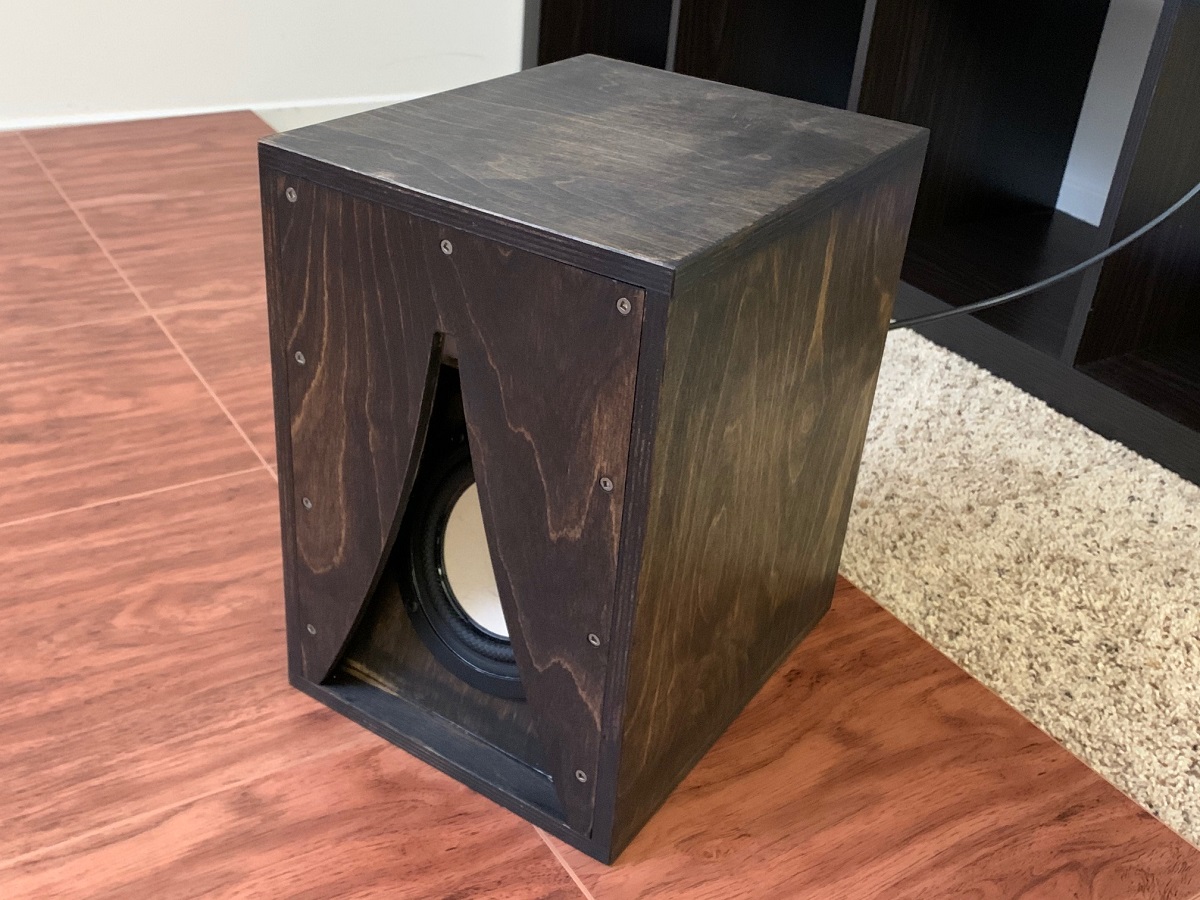

Some messy fun with stain today on my W5-2143’s. I applied “Espresso” on rather thick and let it soak for about 45min then wiped off. I might add a second stain coat on the front baffle tomorrow. Will seal the stain in BLO in a few days. This is a good sounding speaker. I assembled this a while ago and forgot that it has a 1mH and 4.7R BSC to balance the treble and bass.
Before wiping off stain:
Here is look after the wipe:
oh X. - I like that look - have you considered putting a clear coat over the stain ? - not sure how that would come out - ? I guess BLO will look better and safer

I have had espresso brown stain with satin (spray lacquer) clear coat before. Looks very nice. I am going to try boiled linseed oil this time. It usually brings out a deeper color. Sanding the BLO when it’s wet gives a nice satin finish.

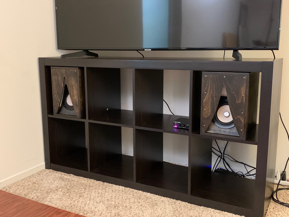

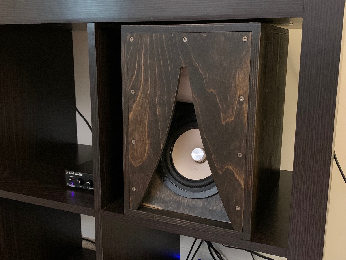

The W5-2143 XKi boxes are pretty much finished now with 1 coat of boiled linseed oil on them. I'll let it cure for a few weeks and then add a second coat. The espresso stain turned out nicely.
They fit nicely in the cubby hole for the TV stand so makes more room for the dance studio:

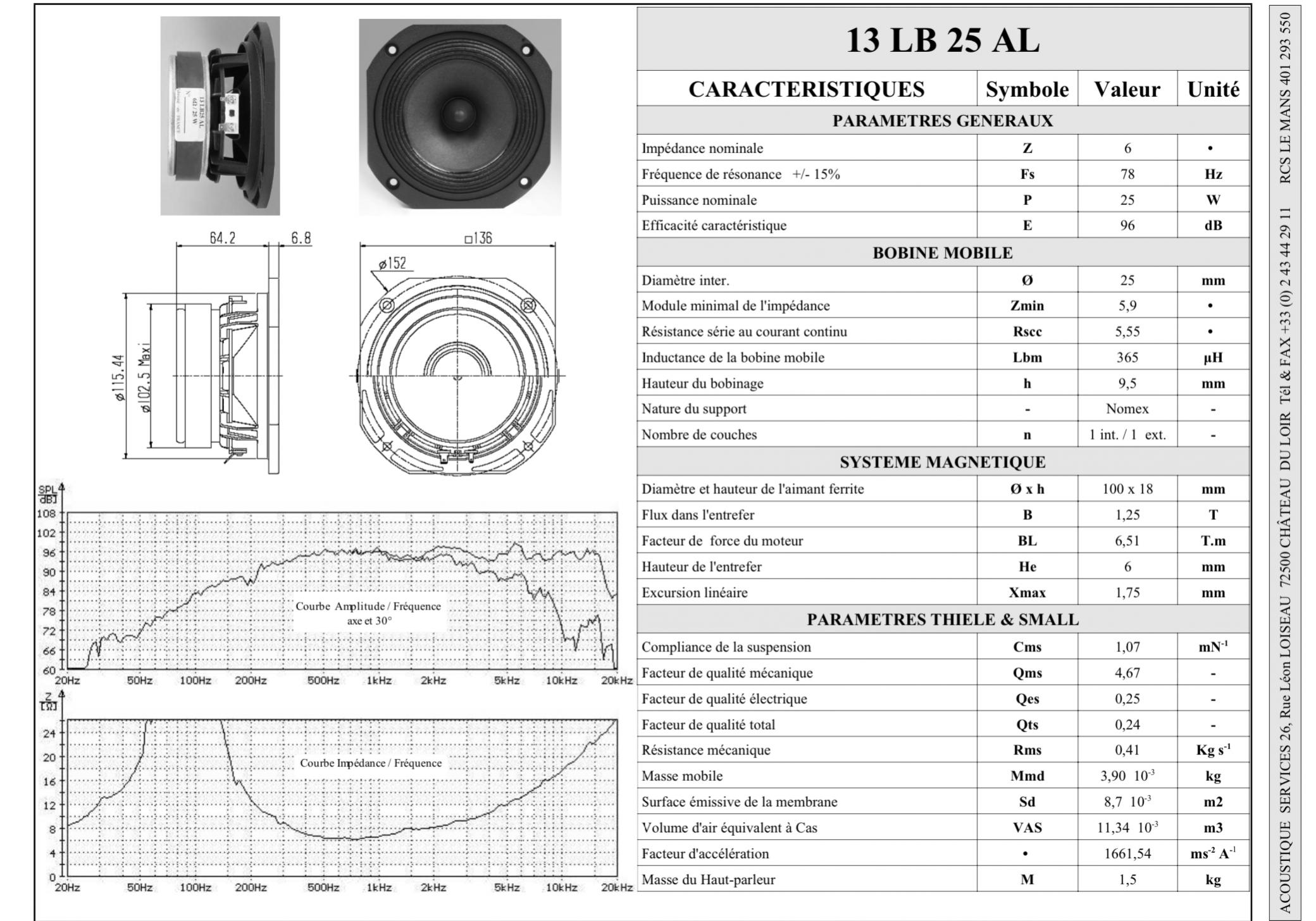

I have a couple of Audax 13LB25AL, courtesy of a very generous JoeHollis.
https://www.madisoundspeakerstore.com/pdf/13LB25AL.pdf
They are exceptionally well built, heavy, and may have the right stuff for an XKi.
I want to experiment with some XPS and foamcore for them.
xrk, could you please run a simulation with these TS parameters?
(- I lost windows so can't accurately input Mms)
here's those specs otherwise in Akabak form so X doesn't have to work as hard:
Def_Driver “13 LB 25 AL"
SD=87cm2
fs=78Hz
Mms=? (Mmd=3.9g)
Qms=4.67
Qes=0.25
Re=5.55ohm
Le=0.365mH
BL=6.51Tm
Vas=11.34L

Hi VonAh,
Sure, give me a few days. My virtual machine within Win 10 has been acting up lately and everything is very slow. I may have to try Akabak 3 soon but it’s a completely different interface. Graphical and not script anymore. Looks like a very nice driver.
X
X
Thanks, X! Good luck with the VM. I love it when Windows updates things that screw with software we rely on.
Thanks for transcribing, freddi.

Looking good! What's the little amp you are using?The W5-2143 XKi boxes are pretty much finished now with 1 coat of boiled linseed oil on them. I'll let it cure for a few weeks and then add a second coat. The espresso stain turned out nicely.
I used this BT enabled Class D amp:
BT30A Bluetooth 4.2 Stereo Audio Amplifier 2.1 Channel Receiver Class D Mini Hi-Fi Integrated Digital Amp with Bass and Treble Control 50Watt x 2 + 10 Amazon.com: Bluetooth 4.2 Stereo Audio Amplifier 2.1 Channel Receiver Class D Mini Hi-Fi Integrated Digital Wireless Amp with Bass and Treble Control 50Watt x2+100Watt x1 for Home Passive Speakers Subwoofer BT30A: Electronics
Thanks, Freddi. The espresso stain is a nice color on Baltic birch ply. I like how easy the BLO is to apply. Wipe on, wait 20 minutes, wipe off. Wait a few days, wipe on another coat, light sanding or rub with fine steel wool while oil is wet, wait 20min and wipe off. You get a deep rich satin finish.

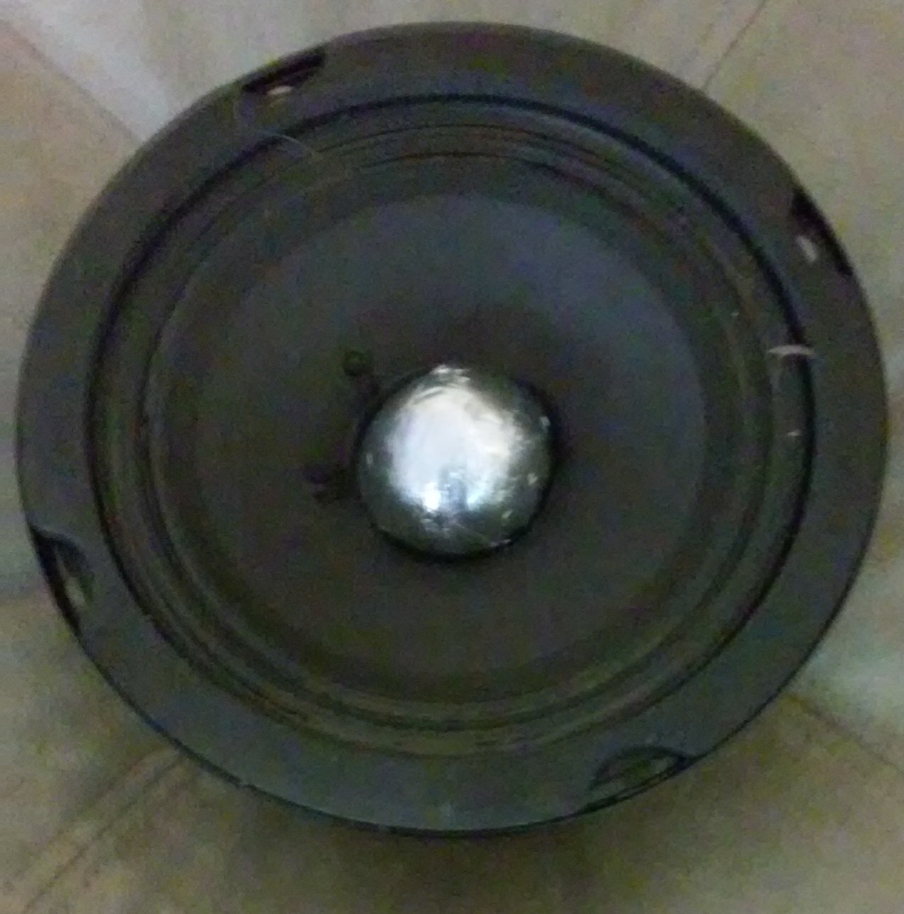

I have made aluminum dust caps to cover damaged ones by rubbing heavy weight foil with a pestle in a suitably radiused bowl to avoid wrinklesYo X, did you try any tweaks yet with your PA130?
I have a suggestion/idea: cut a disk from aluminum foil to cover the dustcap. Spray it with Super 77 and apply. It would be easily reversible by warming with a hair dryer etc and pulling it off. If you wanted to get fancy you could do it with a few pie slices to avoid wrinkles.
It's harder to make small aluminum domes. I have made them for larger speakers from aluminum pie pans. Some pans aren't malleable enough to form, seems like cheaper thinner pans work best. This pic is just from heavy weight foil and the size is about the size of the knob on my pestle. If I get serious about making a couple for my PA-130s I think I might use my wood lathe to turn a depression in a scrap of hardwood just the right size for forming a dome.
