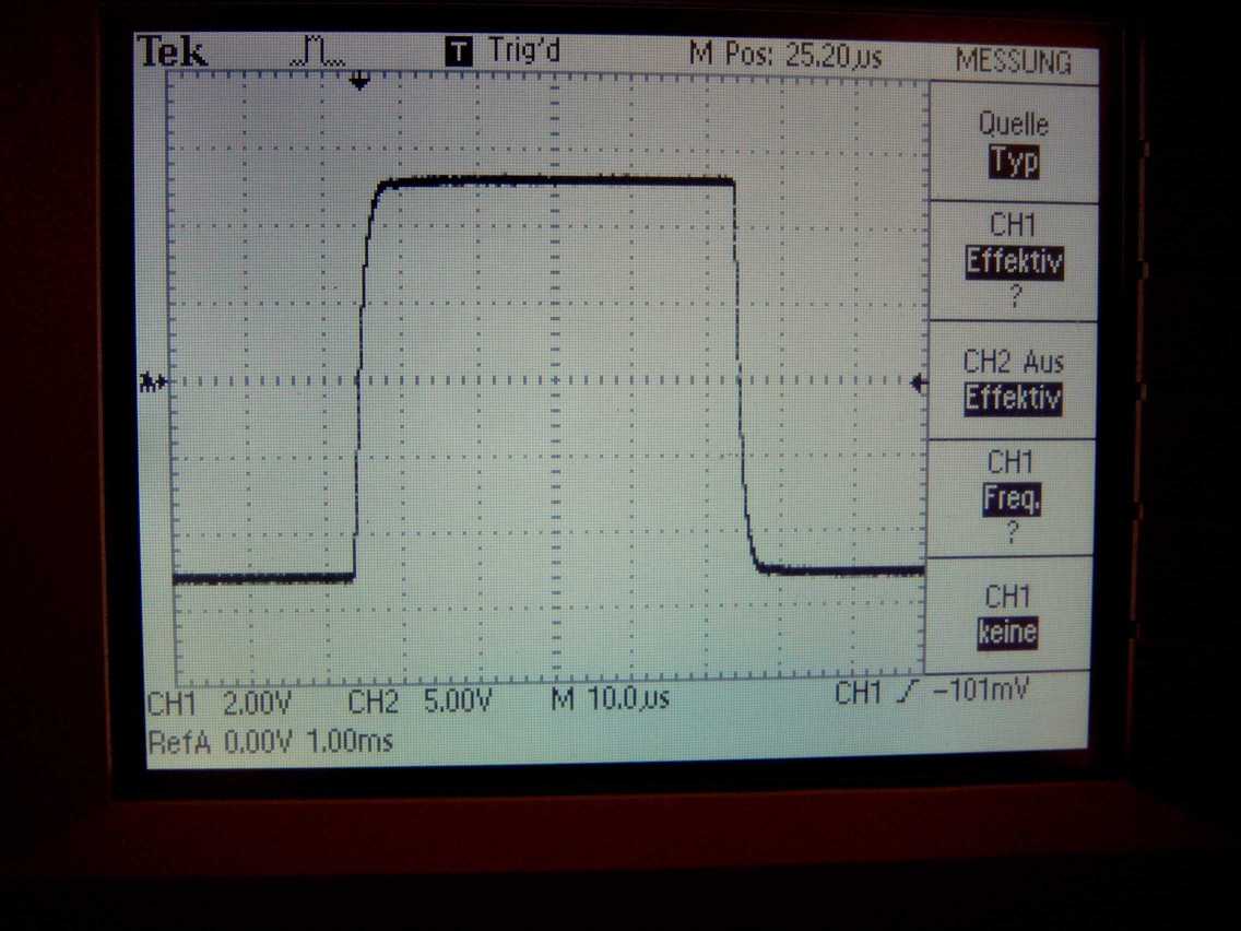

I tested the cascode version with different values for R1-R4. Measured with single ended input and single ended output:
R1=R2=248 Ohm
R3=R4=221 Ohm
freq.response -3dB at 144kHz
Gain 18,4dB, max. output voltage (no clipping) >11Veff
R1=R2=124 Ohm
R3=R4=100 Ohm
Gain 19,88dB, max. output voltage (no clipping) >11Veff
R1=R2=55 Ohm
R3=R4=50 Ohm
freq.response -3dB at 140kHz
Gain 20,36dB, max. output voltage (no clipping) 7Veff
R1=R2=22 Ohm
R3=R4=0 Ohm
freq.response -3dB at 95kHz
Gain 20,00dB, max. output voltage (no clipping) 6Veff
My favorite (now) is 124/100 Ohm.
Adam
Pic: square wave at 10 khz (124/100 Ohm)

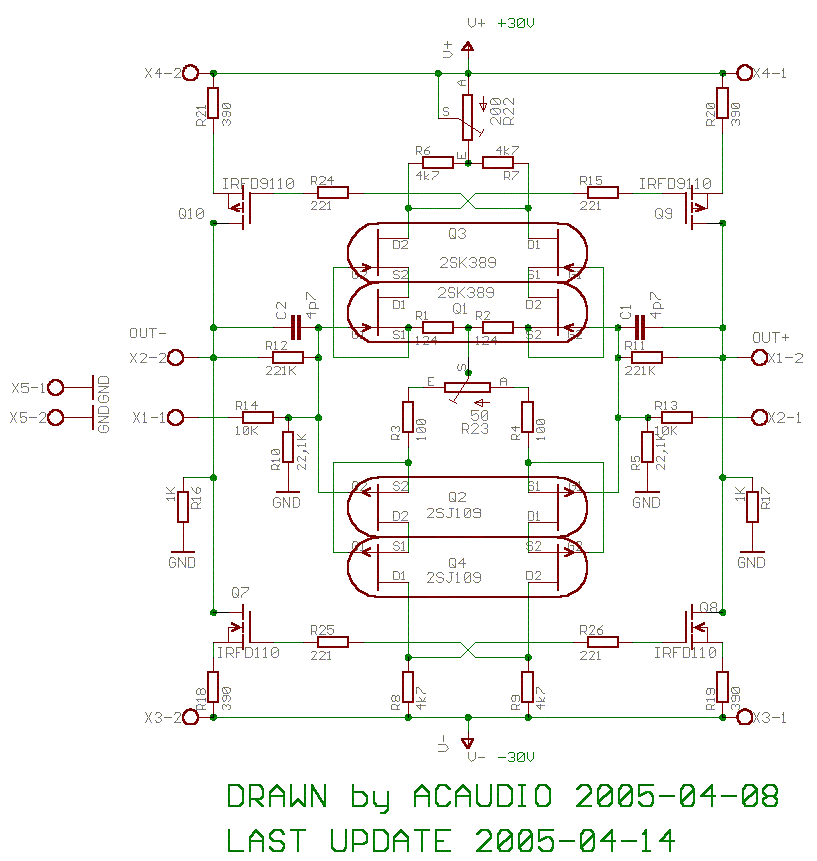

I´m no sure, whether we should lower the values of R1-R4 as aprox. 100 Ohm. Lower values gives higher open loop gain, but a higher input capacitance and higher distortion.
Lower values of R6-R8 gives more voltage loss at Q1-Q4 and more power dissipation at each JFET, we should have a look at.
In my opinion, for biasing of Q7-Q10 we should have a voltage loss across R6-R9 aprox. 10V, the value of output stage bias is then adjustable with value of R18-R21. I would mean, a power dissipation at Q7-Q10 by using of IRFD110/9110 should be lower than 0,6W each. I think 1k as value for R16/R17 is low enough.
In the true, I was a little confused, than Mr.Pass wrote to me:
"...and we run them at very low values, so as to mostly create level translation." For me -> high open loop gain. I thought, a lower open loop gain are better for susy?
Mr. Pass, what is right?

I tested a higher output stage bias, circuit with 100/124 Ohm and R18-R21=221 Ohm, and R18-R21=390Ohm
with 390 Ohm the square wave at 10 khz is more "square" as with 470 Ohm, with 221 Ohm is less "square" as the both.
New favorite -> R18-R21=390Ohm 😉

I changed the offset adjustment (thanks Metalman). It works now perfect. I tested too the stage with IRF610/9610, but it works not so good as with IRF110/9110, bandwidth only 100kHz...
I received today the 389 BL types, so a stereo version may be built.
Here the actually schematic.
With this values it should work good.
Input should be AC coupled, capacitors at output are not needed.
Regards
Adam
Regards
Adam
