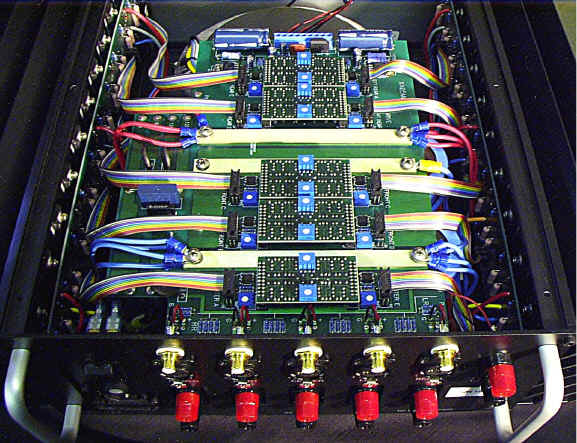

Hello Thomas,
I mean a good pre. I have an Aleph P1.7 clone to compare, the new sounds different to them. It sounds "straight forward", very good dynamics, deep bass and good top end. The middle are, so my first impression better on Aleph. I listended for first Jaques Loussier Trio , Oscar Peterson and as contrast Joss Stone .
For a really comparison I need a lot of time.
I listen further...
I used for my first listening with "fly" connections a Alps pot 100k and reduced the value of feedback resistor to 100k such in X2 for lower gain (more feedback) . So I can turn on the input pot a little more. One nice side effect: much wider freq. response >200kHz (I measured my second module before listening).
The test setup was DC coupled (only Cap at output CD player- T+A CD1000AC), single ended in- and output.
Best regards
Adam
My first impression is confirmed, it sounds good.
Probably also because DC coupled. The dynamic range is very good. It is detailed at the top end, but no nervous.
Ok, my AP1.7 is more tempered and smooth at the middle...
Maybe would someone build it too, and share his impression?
I´m curious.

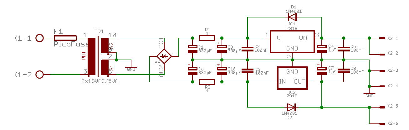

Final question for connecting
1. How to use potentiometer for conncet with UGS 3,4 .Does it use 5K, 10K, 20K or 100K (volume in or out ?)
2. What's version completely , with power supply rails +/- ?
3.Do I use capacitor for input/output or don't use both them ?
AHT
AHT
Re: Final question for connecting
Hello Aht,
if my calculation is correct the right value for pot should be 10k (service manual 10,75k). I tested it too with 100k, but if you use input cap, you should have a look at low pass effect
the supply rails are +/-33 V in the manual. 30...35V should be ok.
I would say, you can omit the caps, but in case of output stage failure....?
Regards
Adam

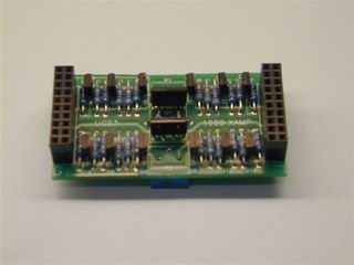

Mr.Pass & Mr.Borbely you are master of JFET
Could anybody post originally schematic (non cascode 2sk389 & 2sj109) I'll be compare with my UGS 3,4 in this picture. (I don't have a free time to clone it)
I think all X, XA and preamp series use UGS 3,4 for in put differential, Why ?
Ps : ZTX450, ZTX550, ZVP3310, ZVN3310, 2SK389, 2SJ109 they are correct choice

I really don't see why there is so much curiosity in the UGS modules. They are current production (and protected IP) and as surface mount technology not particularly a diy frendly project.
The X'd Bosoz has proven an admirable match to the X Aleph for the diy home constructor in imho.
macka
macka
