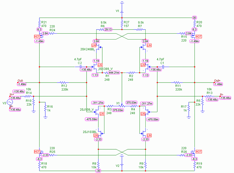

Why would one choose for a lower Idss in this particular circuit?acaudio said:
Actually I use a mix 2SK389V +2SJ109BL, I looking for 389BL...,
but no problem... it works
/Hugo
/Hugo
In fact, you should have a look for max. power dissipation of the JFETs. It´s the limiting factor. By voltage loss of ~15V at DS and 10mA saturation current (for V instead BL) you go in dangerous region. For biasing the mosfet stage are needed aprox.10-15V across R6-R9.
Adam
From simulation (have no real devices at hand) I’ve got 26,29V over R6 and 27,67V over R9. This results in a bias current of 2,77mA through the fet stages.
I read somewhere that ideally the fets should be biased at Idss for best performance.
If this is correct we should aim for 6-12mA for the BL version.
Lowering the supply resistors to 5k results in saturation of the cascode fets although the current rises to 3.27mA.
I’m I way out of track here? Bear with me, I’m horrible with maths. 🙂
/Hugo

Netlist said:From simulation (have no real devices at hand) I’ve got 26,29V over R6 and 27,67V over R9. This results in a bias current of 2,77mA through the fet stages.
/Hugo
Sorry Hugo, your simulation is no similar with real life.
Here the measured voltages (circuit without cascode):
across R6-R9 each ~ 15V
across R18-R21 each ~11,5V
across R1-R4 each ~380-390mV
Uds Q1-Q2 each ~ 14,6V
Uds Q7-Q10 each ~18,5V
Ijfet ~1,5mA
Imosfet~24mA
Lowering the R9-R21 alone gives no mentioned changes, my first circuit had 4,75k.
Idss from datasheet is range of available. The highest value is at Ugs=0V. With R1-R4 you stabilize the bias point to a small range of Idss in relation to Uds variation, lowering the value of R1-R4 gives a higher current, but gives more distortion and noise (in theory?). In figure of my circuit lowering down to 100 Ohm should be good. (with lowering R9-R21 too) The first values are intuitive, I´ll try the lower values.
Regards
Adam
Ijfet ~1,5mA
Imosfet~24mA
Just changed:
R1=R2=124 Ohm
R3=R4=100 Ohm
R18-R21=4,7k
Here the actually measured voltages :
across R6-R9 each ~ 12,8V
across R18-R21 each ~9,1V
across R1-R4 each ~340mV
Uds Q1-Q2 each ~ 16,8V
Uds Q7-Q10 each ~20,9
Ijfet ~2,75mA
Imosfet~19mA
Power dissipation Jfet~46mW (Pd=200mW)
Effect: Square wave at 10kHz is a little more "square" 🙂
Edit: Just compared: the square form is the same than from generator direct.
Should we go down?
Adam

Cascode version works,
I built it different to my previous schematic with two 2SK389 and two 2SJ109. (I had the components at hand)
The freq. response is now -3dB at ~140kHz, the circuit without cascode had -3dB at ~66kHz. It seems to work better😎

Hello,
for first, here the actually schematic , I try at present lower values for R1-R4 (R6-R9 and R18-R21 too).
Tino,
I believe more to statement from really developers , which use fets since more tens of years, they should know it. Such as Mr.Pass or Mr. Borbely. At the moment I have no really good idea, which would be so simple and good as cascoding jfet by jfet. In figure of noise anyway. I´m open for any good example.
For measurements, wait please a moment, I have today an better oscilloscope from my work... 🙂
Adam

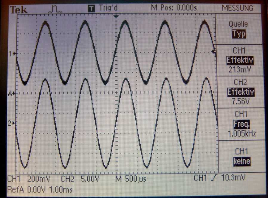

zinsula said:Did you measure open loop gain on your circuit? I am curious...
Hi Tino,
just measured:
open loop gain is 31dB (only R11/R12 removed) see pic, and 34dB if input signal measured after R13/R14 (not divided). Removing or higher value of R16/R17 should giving higher open loop gain, but this low value is helpful to stabilise this circuit.
Adam
