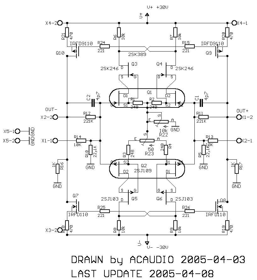

Your deleting of one of the adjustment pots gets back to my earlier post. The pots on the Pass Labs UGS are still a puzzle in my mind. The attached schematic fragment is not yet built and tested but it shows my best guess concerning the pots when I was working on the assumption that the Pass Labs UGS was based on Fig. 2 of 5,376,899. Since this is a folded cascode circuit the source degeneration was kept to a minmum by using 50 or 100 ohm pots.
NP has stated that on the Pass Labs UGS one pot adjusts absolute offset and the other adjusts differential offset. My intent was that adjusting the pots in the same direction adjusts one of these and adjusting them in opposite directions adjusts the other. Resistor R2 represents element 76 in the patent drawing and the value shown is from the patent text. It can be any reasonable value down to zero (highest gain).
In my schematic both pots adjust both factors symmetrically. NP implies that one pot does one thing and the other the other. On the other hand it could just be one of those semantic things......?

GL,
I guess you will have to become a member then................😀.........you could see the evolution of the circuit.
Looking at your solution to adjust differential offset I suspect that both pots will interact with each other and hence you would have to go back and fourth between the pots to zero the offset.......just a hunch, but I could be wrong.

Hi Jam,
You're right on both counts. First, I really should join and I have been intending to.
I think you're also right about the two pots, but I don't think you would need to go back and forth more than a couple of times to reach a final setting. To me this circuit does several things in a simple way and that appears to be worth the hassle of a certain amount of added tweekyness. Assuming the circuit works - which I don't yet.

GL,
your version for adjustment should work, but the wide range of adjustment make (maybe) the circuit a little unstable.
The source resistors gives a local feedback to stabilize the bias point. Increasing the value decrease the gain ,input capacitance and noise. The common point between the both halfs should have a (virtual) ground potential. R22 (10K) pot in my last update helps here a little.
Cascode Friends,
The addition of cascode around 2SK389/2SJ109 with 2SK246/2SJ103 should give a again decreasing of input capacitance and THD, and gives a wider frequency range. Unfortunately, I haven´t actually the devices here to trying. See my cascode circuit. I´m very sure this would work pretty.

The pots on the UGS are not the same, and are not arranged
symmetrically. No problem doing it another way.
The UGS is cascoded primarily because we wish to have the
circuit operate at higher voltages than allowed by the breakdown
voltages of the input JFETs. There is a slight performance
improvement that comes with cascoding, which is always
welcome.

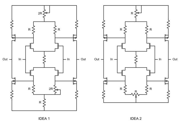

On the adjustment issue, I kept thinking last night about the adjustments on the AlephX, where absolute offset is primarily controlled by adjusting the differential pair's CCS. So I put the pot for adjusting absolute offset at the +ve rail where it feeds the top diff. pair, and put a resistor with half the pot value connecting the bottom diff. pair to the -ve rail. Except that does nothing for differential offset.
So I have been mulling today (to the detriment of my job performance), where and how to put a second pot to get the right effect, which is adjusting the current division between the two legs of the differential pair to vary the voltage output difference between the two sides. I came up with two ideas which are attached below. Just general concepts, I didn't bother to put in any input, output or feedback networks.

metalman,
I played too in my mind around circuit like your IDEA2,
from your both, this is my favorite.

I think with IDEA2 that adjusting the relative offset will have a lesser effect on change to the absolute offset.
Cheers, Terry

this would give a low value of Rs (R1-R4 in my circuit) ~25 Ohm, hmm...
acaudio said:this would give a low value of Rs (R1-R4 in my circuit) ~25 Ohm, hmm...![]()
From what I understand, the SUSY effect is better with not too high degeneration (=source resistors).
What dual 2SJ / 2SK IDSS ratings are you using? BL?
And, IDEA 2 seems very good to me. Will think about.
