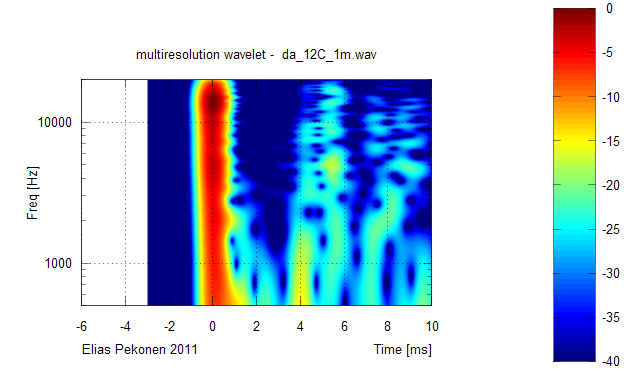

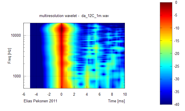

WTF!? Wavelet TransForm for audio measurements - What-is? and How-to?

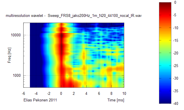

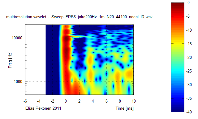

Here's before-after for a small box speaker in a room:
212915d1299432427-wtf-wavelet-transform-audio-measurements-what-how-wavelet_multireso_1_12c.png
212916d1299432427-wtf-wavelet-transform-audio-measurements-what-how-wavelet_multireso_12c.png
- Elias
Ok. As can be seen the most notable differences are:
1) More sharply focused locations for amplitude maximas
2) Individual reflections/diffractions have increased temporal resolution and are more clearly visible as vertical lines
3) In the frequency domain the comb filtering is more consistent and organized as horisontal lines

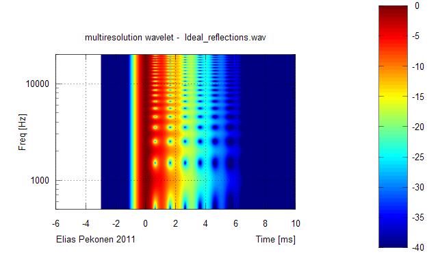

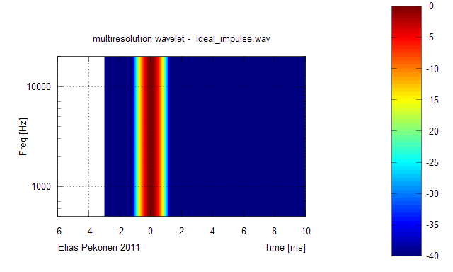

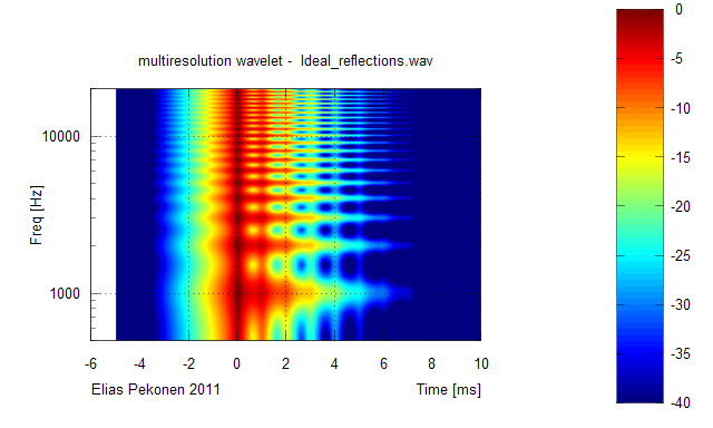

Here is before-after for my ideal reflections impulse response:
212913d1299432292-wtf-wavelet-transform-audio-measurements-what-how-wavelet_multireso_1_ideal-reflections.png
212914d1299432292-wtf-wavelet-transform-audio-measurements-what-how-wavelet_multireso_ideal-reflections.png
- Elias
Well, I'm thinking about this difficulty quite some time now - but - I'm not sure if this can be solved by wavelet analysis at all - or more precisely - by any time / frequency analysis / spectrogram.
The problem that arises IMO is that - as most clearly seen with the new plot - one very important aspect does not come out clearly enough.
This is the basic fact that comb filter effects can happen *not any earlier* than when the second impulse happens.
This means that for the time slot between 0 and 1ms (in above case) there should be no comb filtering plotted.
Obviously this is possibly not achievable no matter how far we stretch display options.

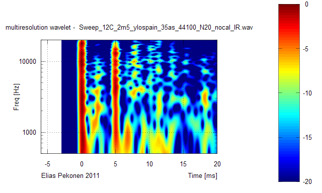

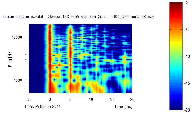

There is no problem! 😀
With the constant Q step one has what is required for your case. Here for ideal reflections. (Time scale a bit too long but can see that for the first 1ms no combing, first reflection arrives at 1ms)
For a real life measurement here. (Time axis vertical this time, and freq only up to 2kHz). See, before 3ms (time of first reflection) no comb filtering. Between 3ms and 7ms comb filtering pattern is constant. At 7ms is second major reflection and comb pattern changes completely. Here interesting things happen: a peak is split to two, and a notch is changed to peak, etc.
One question though, when this step signal should stop, as now it remains forever? 🙂
- Elias

honestly speaking I have problems to interprete the pictures of your message #360 (based on the ideal reflections pulse impulse response):
the (attenuated) reflections are following the main pulse in a distance of 1 ms. Thus IMO in reality at e.g. 10 kHz the single pulses do not interfere. There is no such combing effect as shown by the pictures.
I would expect something like this:
I guess that the constant Q wavelet gives also more realistic pictures ?
Best, Uli

Hello Uli,
See post #359 that specific plot for only one impulse. While yours is constant Q, I took some liberties to adapt the wavelet for a specific purpose: to improve resolution of a CSD (posts #360-363).
For a constant Q type of wavelet multiresolution would look like this:
Really the comb filtering effect, or the overlap, depends on the chosen length of the wavelet. In a resolution vise it depends which space you choose from the resolution domain.

Hello Uli,
- Elias
