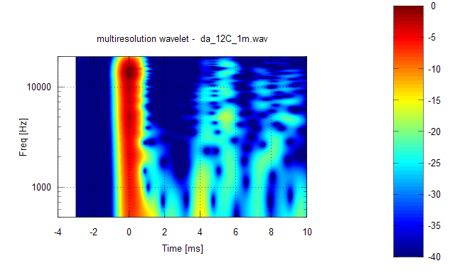

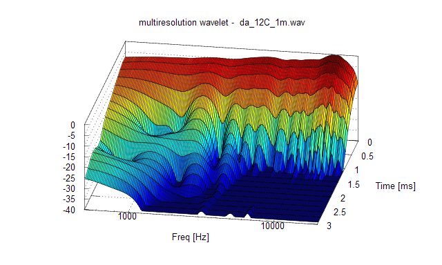

Here's the updated Octave script to calculate multiresolution wavelet from the impulse response file.
It plots wavelet and normalised wavelet in spectrogram and 3D format.
http://dl.dropbox.com/u/2400456/html/Elias%20Pekonen/main.html
go to wavelets
I hope to add more scripts for other types of wavelets.
Note that this 3D multiresolution wavelet is equivalent to cumulative spectral display with gaussian window 🙂
Enjoy!
- Elias

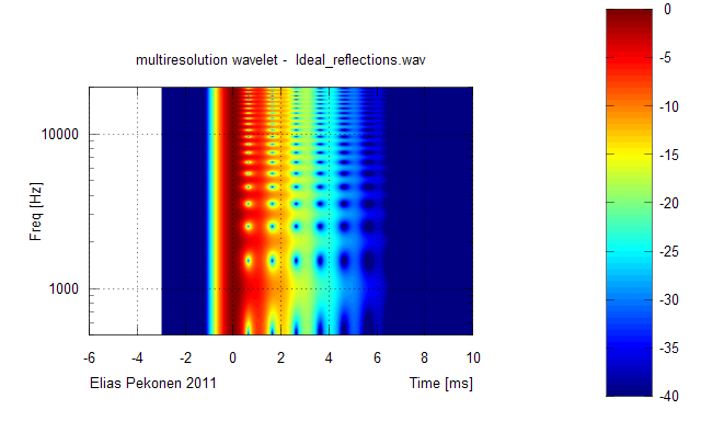

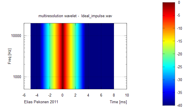

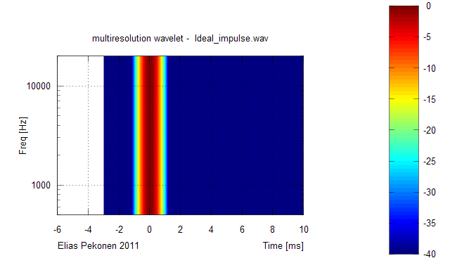

Welcome to the TV shop channel! We have a remedy for all of your problems :checked: Look at this ideal impulse response before and after the new method is applied.
212911d1299432117-wtf-wavelet-transform-audio-measurements-what-how-wavelet_multireso_1_ideal-impulse.png
212912d1299432117-wtf-wavelet-transform-audio-measurements-what-how-wavelet_multireso_ideal-impulse.png
Ok, this is boring lets move on..
- Elias
