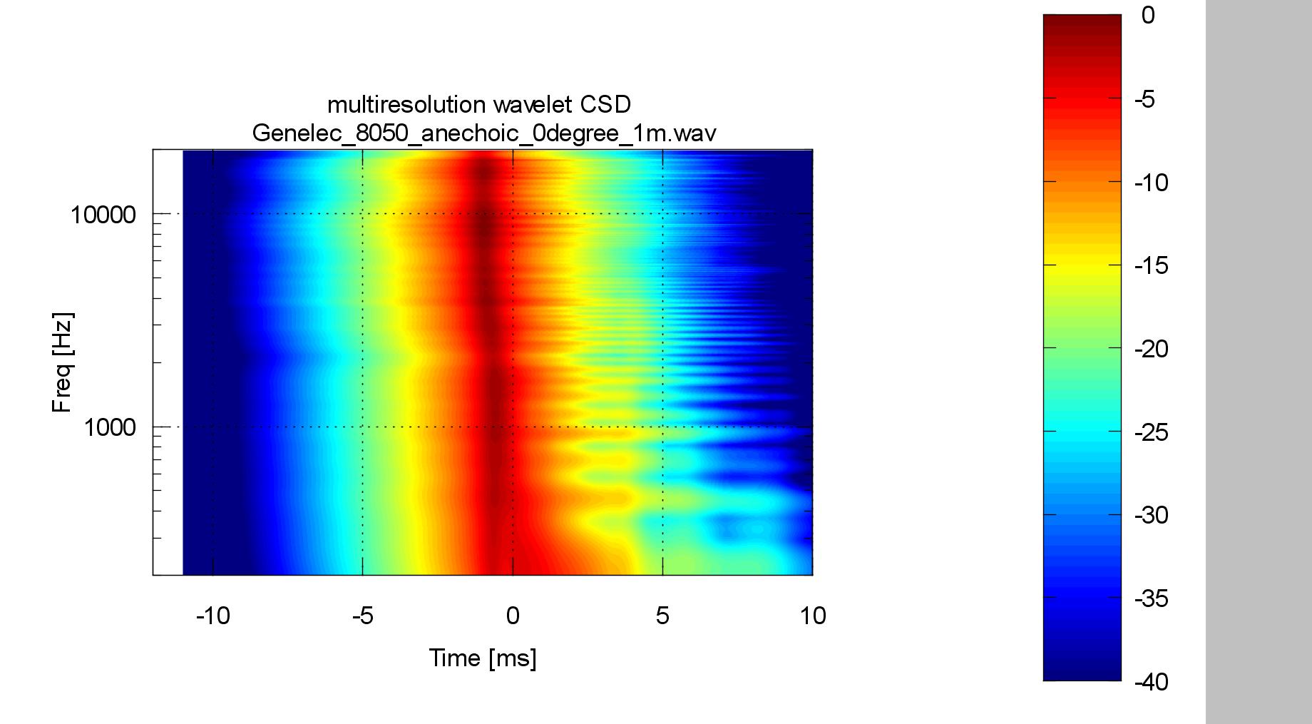

Hi all,
first of all I would like to thank you for making this very nice tool available!
I am playing with it, feeding it some of my IR's and have some questions:
1 - please see the attached picture, the measurement of one of my Genelec 8050 studio monitors. http://www.genelec.com/pdf/DS8050a.pdf . This measurement was performed in a fully anechoic room (at least above 40Hz) at 1m distance.
I would like your opinion on the wavelet, what do you think it says about the speaker?
I know that the phase response can be seen in the first arrival, but what do all the resonance peaks up to 5ms tell me? This cabinet is know for it's low diffraction design and stiff cabinet, so is it all still driver/cabinet resonances or a processing artefact of some kind?
2 - Would it be possible to extent the analysis down to 20Hz? I understand that this takes bigger FFT filters and thus calculation time but... Or is it a limitation in the time domain?
3 - I am a professional acoustical consultant and studio designer and I feel that this could also be a great tool for analysing room IR's, because it will show you the amount of energy per frequency which is absorbed with a reflection AND the phase of the reflection (which is changed if it is caused by a panel absorber such as all walls) this is vital for making a good LF wavefront throuhgout the room.
I have tried some measurements with the wavelet but the frequency limits and time limits are now a constraint to do this, do you have any plans to make them bigger?
again, many thanks for making this available!

Seems you show us here a comb filter effect at around a delta-f of 250-350Hz.
This - to me - seems too low in this case to be caused by the chassis, internal cabinet refections (standing waves) or cabinet diffraction.
Also, those ripples do not show up in the data sheet.
If you have the chance repeat your measurements and possibly do a second measurement under identical conditions with the port closed or heavily stuffed.
Possibly do a further measurement with the mic placed directly at the port (no anechoic room required for that one).
Did/ do you use omni mic ?
Best
Michael
Hi Michael,
Yes, I did use an omni-directional type1 meas mic.
It won't be easy to replycate the meas in the anechoic room, since it was during a testing session that I made these. I'll have to wait for the next session to pop it in.
Do you think the port resonance would be in the length of the port or in the width?(this speaker has a very large port which is expanding along it's way.
Kees
