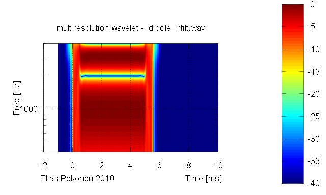

For a filtered ideal dipole impulse response having secondary impulse at 500us and filtered with low-pass filter of 4kHz:
the frequency response looks like this:
And a wavelet can be constructed like this:
Now one can see that there is no dipole notch within the first 500us that is before the secondary impulse arrives.
Even at 1kHz which is well below first dipole notch frequency there is 6dB step at 500us.
- Elias
- Elias

- basically it looks veeeery good but wavelet analysis usually digs deeper.

Actually no. It doesn't. It just looks at the impulse response differently than FR or CSD. As I pointed out months ago, wavelet analyis is noting more than convolution of the impulse with what ever the mother wavelet is.
I only have the demo version of ARTA so I can not export the impulse.
... There are small secondary "glitches" in my impulse which arise from reflections/diffraction from other sources. But these are generally more than 30 to 35 dB below the peak of the burst.
Most likely reflections from the mic stand for the one around 1ms. I am suspicious of the little glitch in the impulse though. Wonder if that changes with angle.
Most of the data processing considers the total data as system response. wavelet analysis looks at the response over time. This is valuable for evaluating what is effecting the response by looking at different time window intervals. From the spectrum content of each window segment, it's more convenient to figure out what is causing problems than pure impulse data.

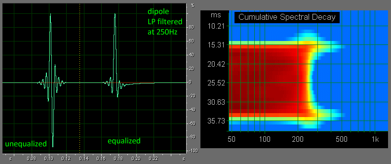

Hello,
Starting from my last "simulation" of the low pass filtered dipole (using a delay rear wave / front wave = 2ms) I equalized the response using a +6dB filter.
You'll see in attached file that the shape of the Impulse Response has been improved by the equalization. Additionally, the CSD from ARTA doesnt' show pathological beahaviour .
There is only one minor thing that I eventually could regret is that the duration of the Impulse of the equalized dipole is something like 10 times the duration of the IR of the (not shown) monopole having the same frequency response (min phase equalized).
Best regards from Paris, France
Jean-Michel Le Cléac'h

No that is not the case. If the frequency response is identical then so in the impulse. Any differences int he impulse are due to differences between the response of the monopole and the eq'ed dipole.
Hello,
I don't think so,
min phase equalizing with a -6dB slope is the difference here. (-6dB equalizing being equivalent to an additional low pass filter having a cut-off lower than 10Hz e.g. ).
I can show for the same treatment (except -6dB equalization) the simulations for the monopole case and the dipole case... (but as you seem to deny what I say I would prefer someone else does the simulation...)

Hello,
You'll find in attached file a 48kHz 16bits wave file (in txt format) with 2 pulse responses of simulated monopole and dipole.
Both IR responses receive the same treatment (except -6dB /octave equalization of the dipole).
( 20Hz HP 2nd order Butterworth + 200Hz LP 3rd order Butterworth were applied to simulate the filtered loudspeaker)
You'll see that the duration of the dipole is 4518 samples when the duration of the monopole is 2200 so the ratio is a liitle more than 2 (a first estimation without HP filter leads me to a ratio = 10).
( is it related to the long tail of the IR of the NaO ?...)
