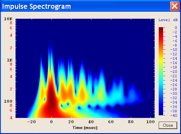

Hello,
The spectrogram in Hornresp has been improved.
The new calculation runs faster and the quality of the spectrogram is much better due to the use of a new Fourier window equivalent to a gaussian window.
See David McBean's message:
http://www.diyaudio.com/forums/subwoofers/119854-hornresp-128.html#post2223790
A test spectrogram is attached to this message
Best regards from Paris, France

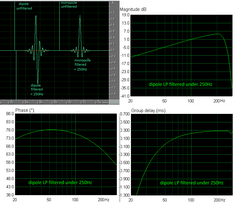

Hello,
To illustrate John's sentence, I generated using Adobe audition a signal made of a first positive impulse and a delayed negative pulse (delay around 2 ms).
The (first) peak visible on the FFT spectrum of that signal is at 250Hz.
Then I filtered with a brickwall lowpass at Fc = 250Hz.
The result is marked dipole filterd on the screen copy (see attached graph). The height of the pulse is something like 1.4% of the height of the unfiltered original signal.
We can compare it to the filtered monopole (same process but on a single positive pulse).
Then I used Arta to import the filtered dipole signal and you'll see the frequency response curve (unequalized), the phase curve and the group delay curve.

The equalized dipole is not a double impulse system when the bandwidth is limited to below the dipole peak, a point I have made over and over.
