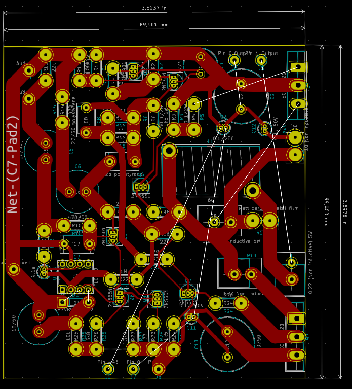

I have added my latest but not finished pcb, but I am thinking of redusing the 4mm traces in most of the board, except in the audio in/out. It will reduce the size of the board, and may not give much more impedance?

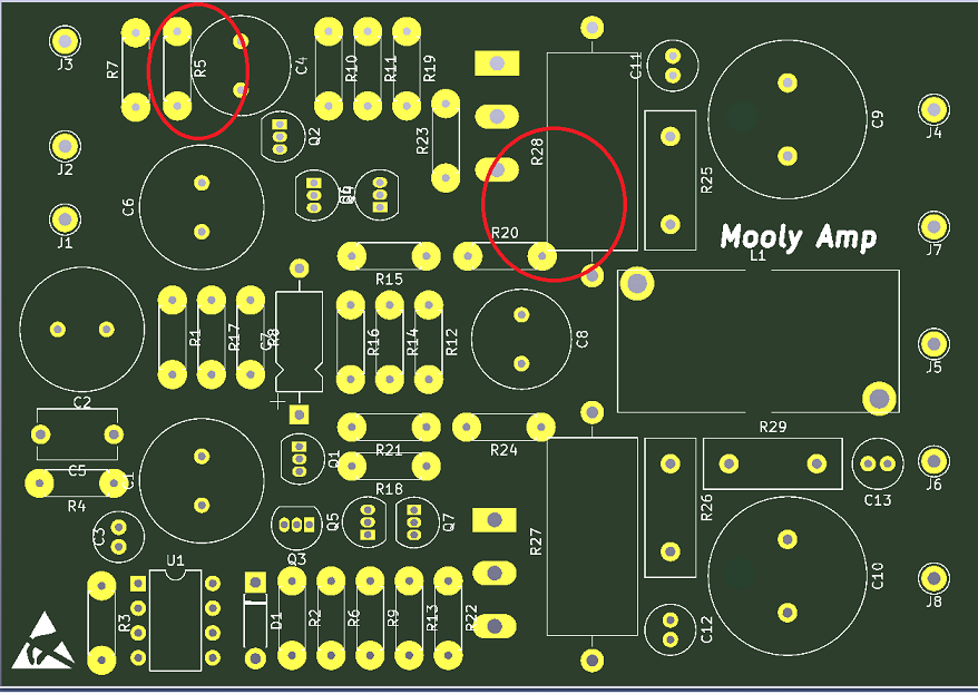

Not really tidied up and optimized but just another example, to show how to better make use of your two layers and maximize copper use.
The mosfet go "under" the pcb, in between the pcb and the heatsink, the leads bent upwards and the whole pcb is attached to the heatsink.

I see no mount holes on your PCB. You also need them for the MOSFETs to tighten them to the heat sink. I would recommend to use standard 0.1" or 0.2" spacing for the input and output pads. You can use a standard connector footprint for this even if you do not plan to use it.
Note: when you show the PCB design without showing traces it is impossible to see the quality of routing.

Looking much more orderly.
You should start placing tracks before spending too much time on the physical component layouts - often the physical placement will be determined by how the traces can traverse the board underneath other components.
Still need to give more space to a couple of the components at the top that are touching or overlapping. R5 and R28 for instance.
But you are making good progress :)
R5 and C4, R20 and R28 are quite close if using the full size.
attachment.php
Check if any of the larger resistors are dissipating much power (heat) and make sure C9 / C10 aren't too close.
You don't have to do the tracks first, but it tends to be a progression between placing components, running traces, placing more, moving some of the components, etc.. It is an evolution of both processes together rather than a sequential process ('components first' then 'traces next').

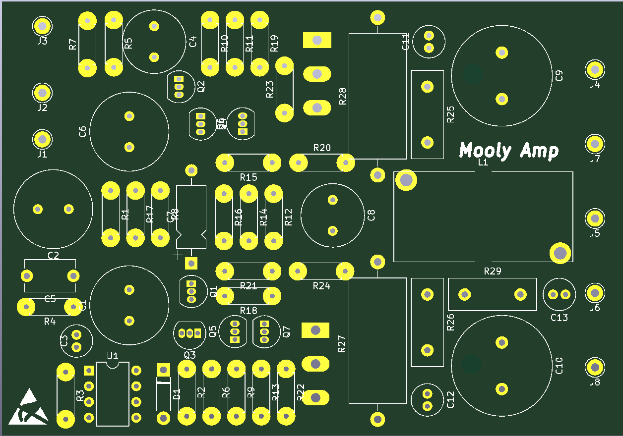

- in your board, what kind of capacitors do you plan on using for c11-12-13 ? You have footprints for small electrolytics but they really should be film. These tend to come in boxy packages.
- what kind of connectors do you plan on using ? The holes all seem to be the same size. You might want something smaller at the input ?
- one thing I wasn't too happy with in my tentative layout are the tracks between r13-q6 and r16-q7 (Mooly's schematic numbers). They could be made tighter.
- I second Oleg's comment: the way you placed components above the mosfet will make it difficult to access the screws. The hole in the pcb above the mosfet need to be quite big : if you use M3 screws with 6mm diameter heads, I'd use a 8mm hole, to have some wiggle room. You could in theory first attach the mosfet to the heatsink and them solder to the pcb, in which case you don't need such holes, but I really don't recommend it.

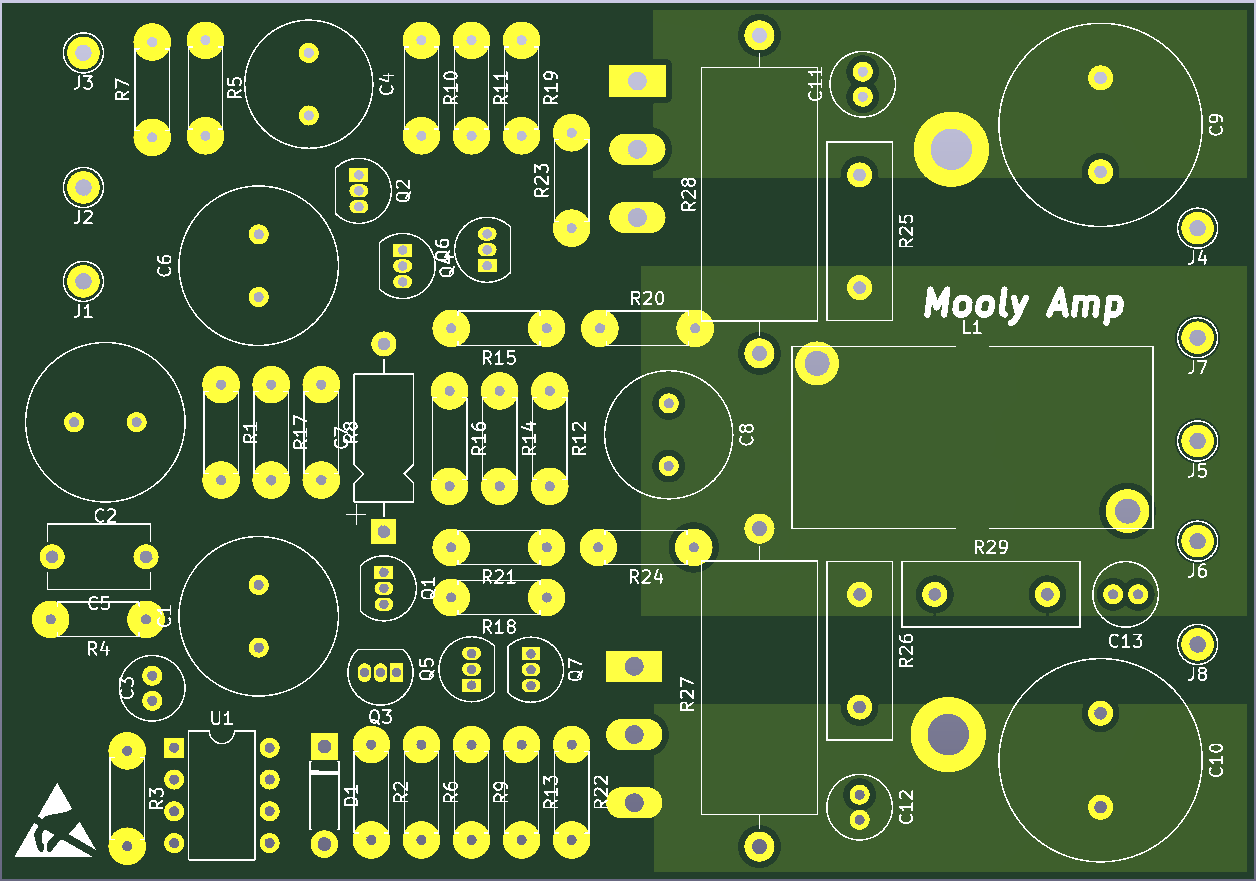

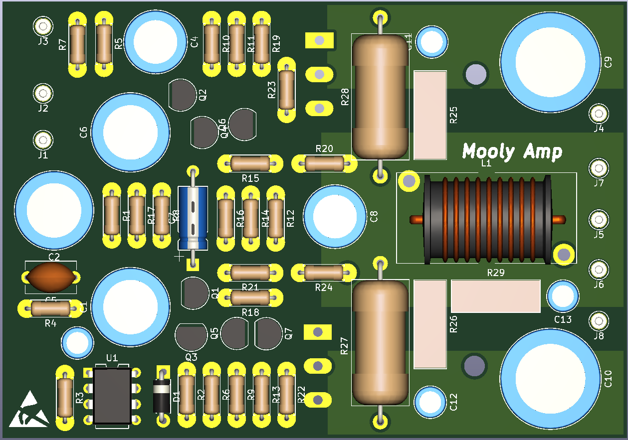

I have tried to rearrange some of the components, out from what you avtech23 and you 00940 have advised me. I have made a picture where there are "components" mounted, I am not sure on how much heat they will produce.
By the way, thanks for making the picture, it was a great help!
avtech23 sorry, I did not write in the right way what I mend about making the traces first. I did understand your advice clearly and as you write now, do I start by placing an important component where I do want it. Then do I make traces, add components, traces and so on:)
00940 All components are one pole electrolytic caps, as the schematic is showing it should be, I am glad that you do ask and correct that error, as you properly know, do I have about no idea on what I am doing. :)
Instead of connectors, did I think of just soldering the wires, directly to the board.
About the tighter layout, i.e. R16-Q7, this point was helpful for me, sins it was easier to locate, because it had "a bit of room" :)
I have tried to redesign those places to accommodate for your changes.
