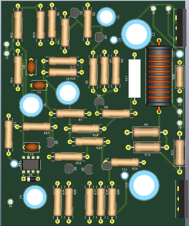

Thanks a lot for your advice, I have done something a bit like that, I have looked for other members version of the Mooly amplifier. About other amplifier designs, I did thought that it would be a bad idea to look at other amplifier designs, because I thought it could confuse more then help. But I'll 100% follow your advice and search google thin🙂
I know I may not express it in any good manner, but know that every answer I get, make me super happy!! Without your all, I have never been able to start this fantastic journey!
Lets take a look at prasi's fantastic design, it's beautiful!!
Unfortunately am I looking at that design with several noob questions.
prasi do use 4 mosfets (in parallel for higher current capability), these mosfets is flat against the pcb, what about heat?
I can't locate the inductor?
If I try to copy most of that fantastic design, is there things I have to be careful of, mandatory rules?

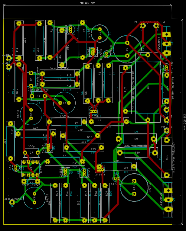

I had some trouble sleeping yesterday so...
Not really tidied up and optimized but just another example, to show how to better make use of your two layers and maximize copper use.
The mosfet go "under" the pcb, in between the pcb and the heatsink, the leads bent upwards and the whole pcb is attached to the heatsink.

Thanks for all that wealth of great knowledge. I know this sound crazy and will put up a lot of questions of the type: "how could you sped that much time,?", "You know that it is almost useless?" and so on, but I have just spend over 10 hours in KiCad to make a sort of copy of prasi's design. And then asked FreeRouting to connect tre traces, as avtech23 did advice me🙂
FreeRouting do a strange job, but it tells me that everything connects, no via's.
avtech23 I do also like your design, simple and with a great seperation and wide traces.
I am trying to design so that the board can be connected to some side mounted heatsinks.
10 hours is slower then a snail, but 10 hours of fun and learning is, in my opinion, a great usage of time! 🙂
What I about to do now, is to manual rout the traces as avtech23 is recommending, and to make cirtain do I check on the calculator 00940 linked to.
Any comment before trying to trace the board?
I am aiming for getting something like prasi have done.
Thanks to you all!!! 🙂

You are doing very well 🙂
You might want to look at making the resistors smaller. Only the 0.22 ohm and 10 ohm are large. I would also make the tracks thicker and pads larger.
Its good to print out a board layout and then it suddenly all looks more real and you will see how fine those traces really are 🙂
But you are doing great.

Pew great, that make me a happier. 🙂
I know that the resistors are big, I'll try to find smaller once🙂
How many wattage should I go for if into 45V as you write on the board, connected to 4 Ohm speakers?
What size of pads and tracks? Tracks are 3 mm now.
0.6 watt metal film are perfect. Most of the resistors dissipate under 5 millwatts and many dissipate only a few microwatts.
Only the 0.22 ohm and 10 ohm are bigger higher wattage parts.

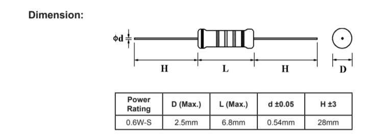

You are certain about that ? 3 mm is about 120mil, your tracks look to be about 24mil at first sight. 120mil is already pretty good in terms of width btw.
I would use the typical 0207 0.6W metal film resistors (6.3mm long, 2.4mm wide) for most places. In terms of layout, that translates best in pads spaced 10mm apart (or usually 0.4"), so that you don't bend the legs too close to the body of the resistor (you risk stressing them).
Btw, you'll quickly find out that most specs for pcb layout are expressed in mil (1/1000th of an inch) and the typical "grid" will be based on a 0.1" spacing. Old convention 😉
edit: beaten to it by Mooly 😉
Thank you a lot, I'll correct that... in some way🙂
By the way, I have tried 5 mm pads but that looks totally insane.
Am I missing something here: The pad has to be so big that solder is connecting perfect, but also not so big you have to use large amount of solder. That a 1 inch pad is not giving better connection then a i.e. 5 mm pad. That the only reason for bigger pads is to make space for larger tracks?
A visible improvement already FM.
You need to increase your track separation in the design rules. Look at the gap between the tracks at c11 for example. In reality that distance is going to be very small and cause issues .
Give the components some space - Q7 and R24 are overlapping. You need to ensure there is enough space to solder.
Try to use symmetry to your advantage - if your circuit has 2 channels, you can mirror most parts.
Aesthetically, try to line up components where possible or use the same offsets to make it easier to place tracks that traverse under a component. Plus a board that looks good often takes more thought and planning than one that is an autorouter jumble - it is more likely to be a better laid out board.
