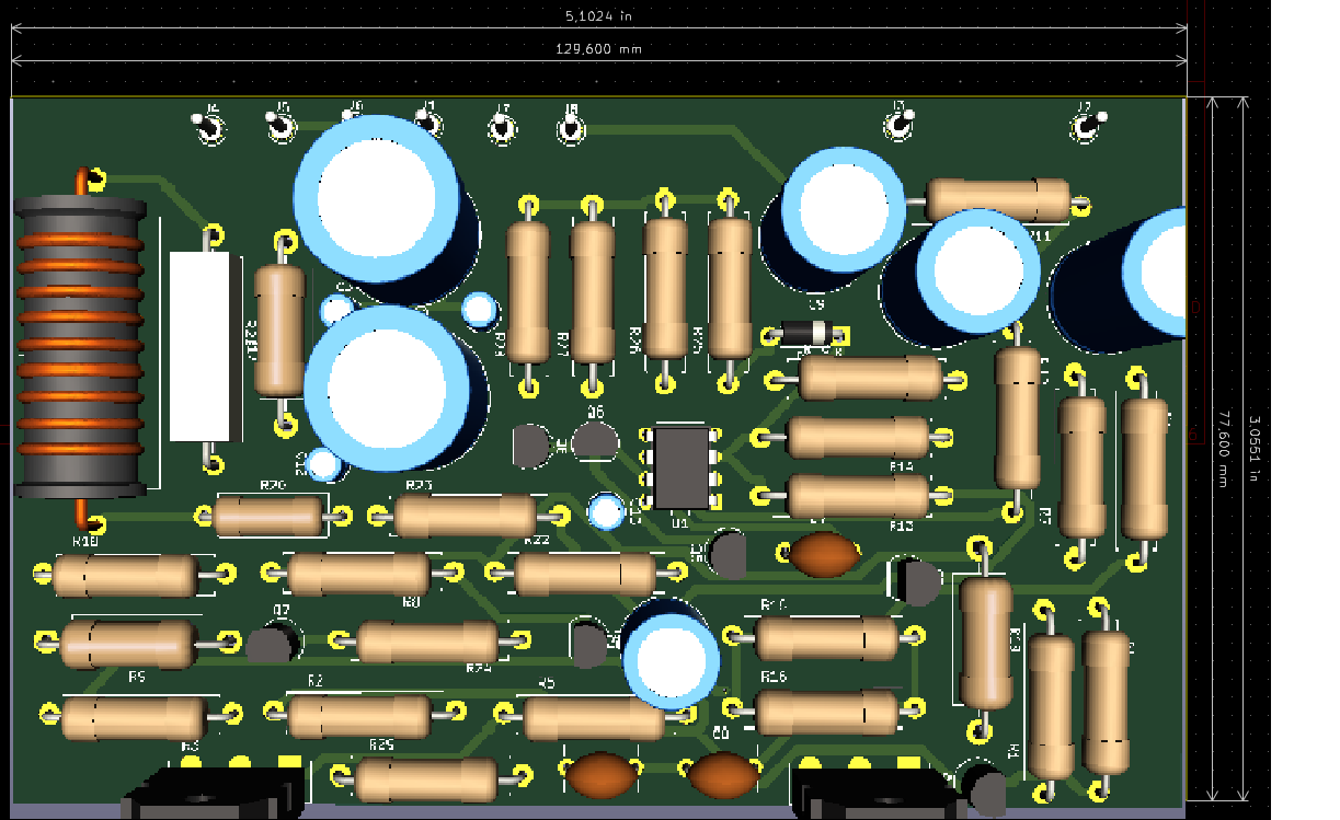

In post 9 did I show a PCB design, but to make that, do the tracks have to go in all sorts of directions and do get fairly long. But how would that effect the amplifier? I think I have heard several times that traces have to be as short as possible, but what if the traces is wider?

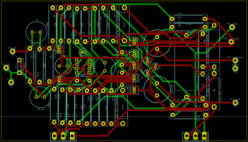

First, this is fairly quick bodged together, so it's uneven and unpolished, but I did make this layout, to ask you if this layout is not a bad idea? Each track is 1mm (0.04 inch)

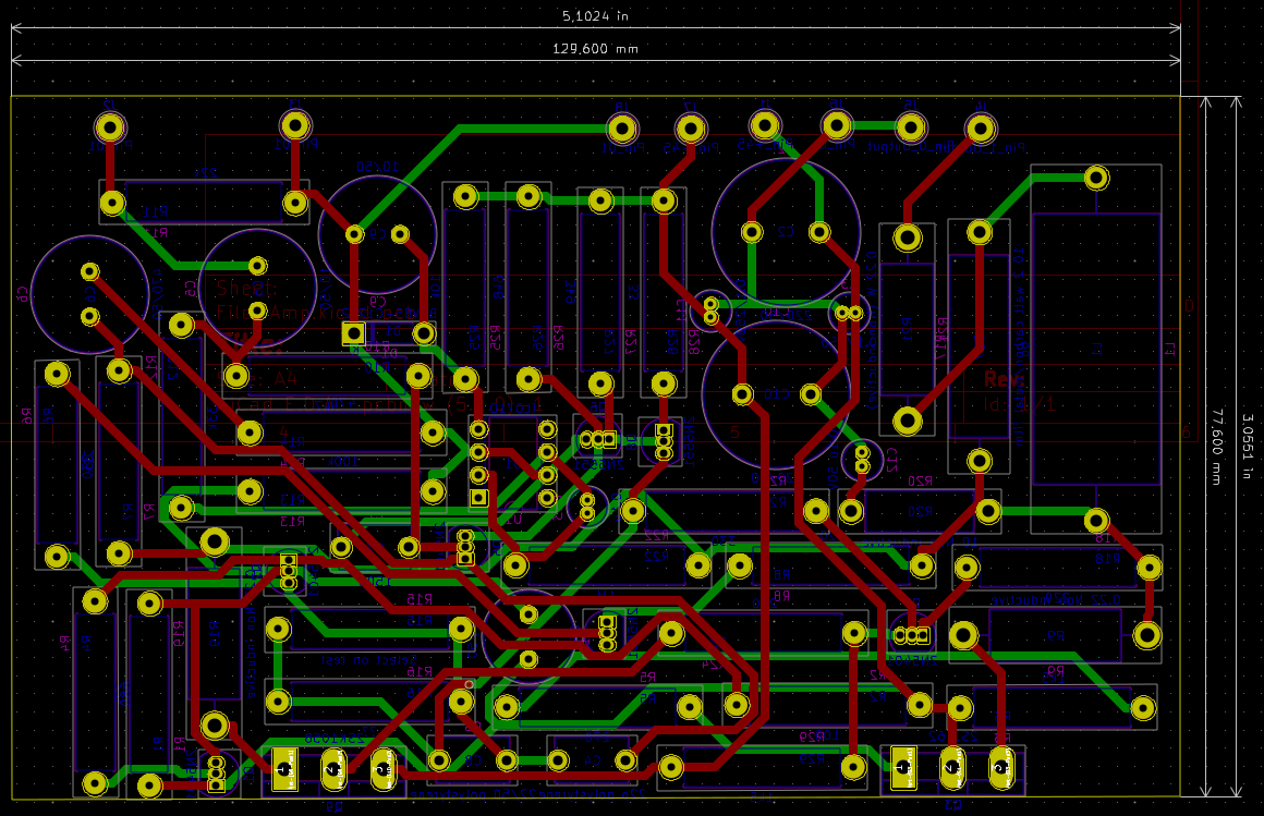

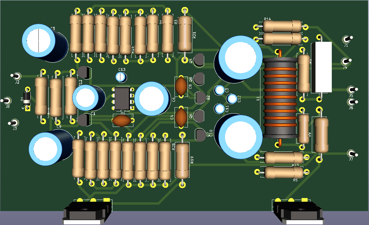

Thanks to your advice about swapping, using FreeRouting and lot other, have I tried to make a board where I totally ignores how it looks, only thinking of minimizing vias and track length.

....I have absolutely now idea on what I am doing ....connected in a random order....
Then learn from the people who have gone down this road before. Find a dozen or a hundred laid-out amplifier boards and get a sense of what looks good and works good.
They do not have to be the same basic amplifier, because all audio amplifiers have similarities.There's big power devices and little control devices. In a chip-amp they are all in one, but even then the wiring divides into big and little currents. And there are many discrete (or discrete+IC) amplifiers around.
You have the internet. Use It! Back when I got started we could only find about one design a month to study. (Which did mean I had some of them memorized.)
