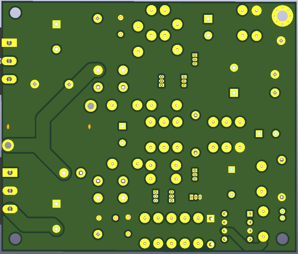

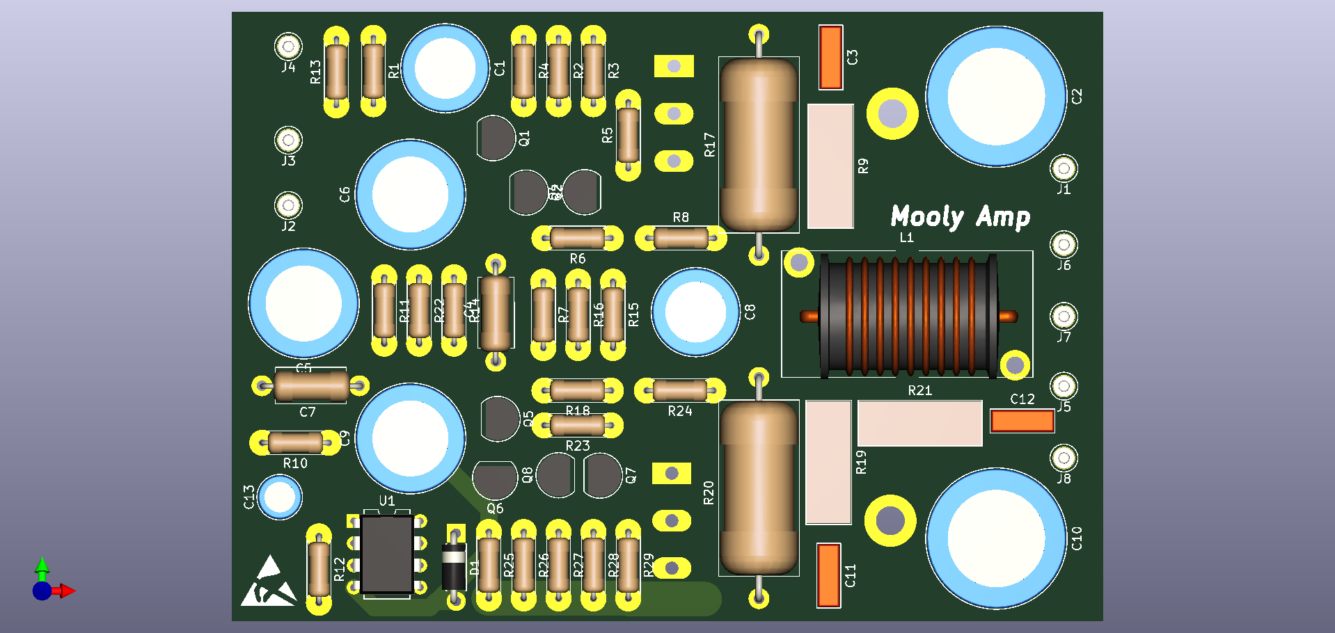

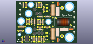

Ok, so now I'm really lost. The layout in post 82 seems to match that schematic, in terms of positions and size of most parts. But the layout in posts 89 or 99 don't make any sense. 😕
As an example, let's take r25-r26. They are small resistors in post 82 but are now big ones in post 89/99 ? And why are they near the mosfets ?
Maybe this can help, but first, I am not sure I do completely understand.

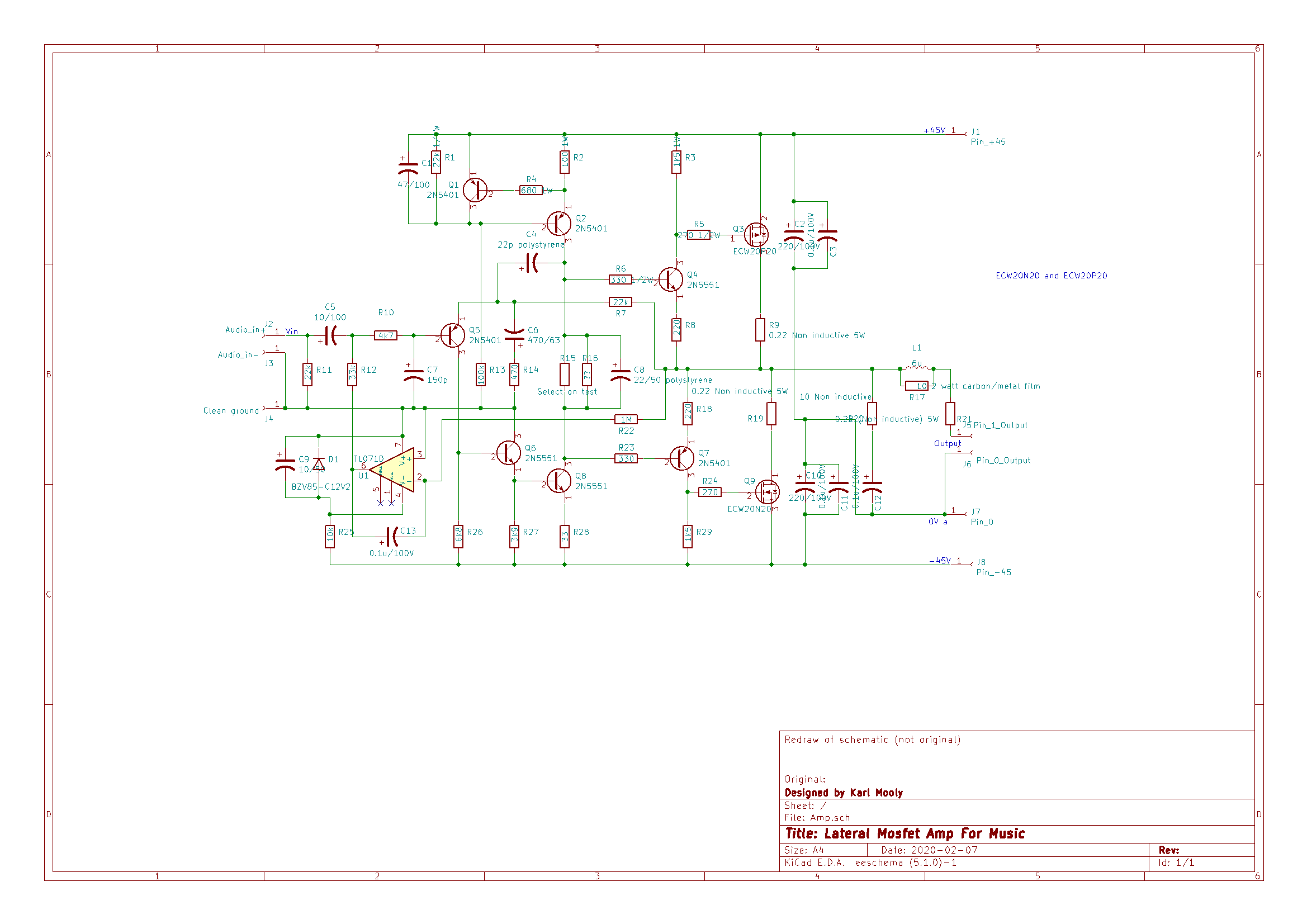

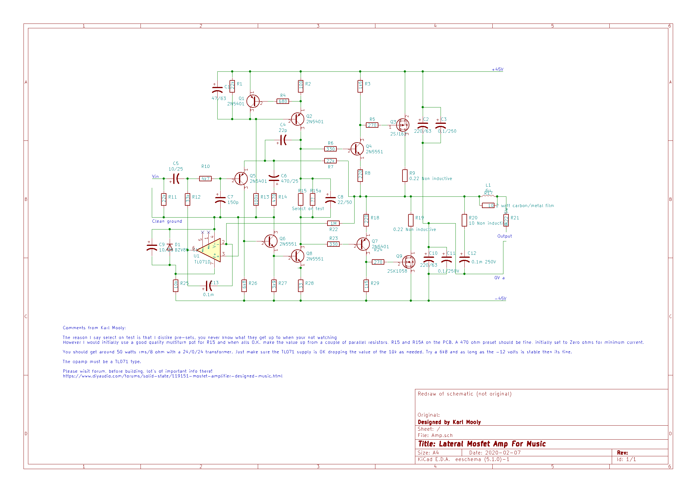

I did to a start, draw the schematic and Mooly was so very kind to check it for errors and he found one error.
After that did I chose some components and did try to make a layout. I was advised to select some smaller components and try again.
Any reason for any placement, is almost alone from me guessing what is what on your great layout. 🙂
Ok... to go forward, I would suggest you to establish a simple bill of material (BOM). Simply:
C5 - 10uF/25VDC - electrolytic cap - 2mm/5mm (lead spacing/diam)
R11 - 22K - 0.6W metal film resistor - 6.3mm/2.4mm (length/diam)
C13 - 100nF/100VDC- MKT cap - 5mm/2.5mm/7.2mm (lead spacing/width/length)
and so on. Then we will check together if all these make sense with regard to the schematic. Then you will be able to complete your schematic with the correct footprint for each part. Then only can you start the layout.
PCB doesn't match schematics, as I see.
There are several mistakes.
For example, C13 has to be a film cap near the opamp. Or no?
C9-D1: where is C9?
C1-R1: where is C1?
Something strange with R8 on the PCB.
And so on.

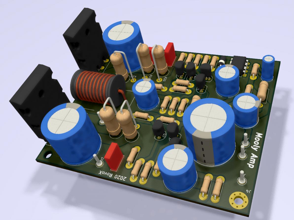

So pew, what a task and what fun!!
I have now ended up with a pcb I think is fine🙂

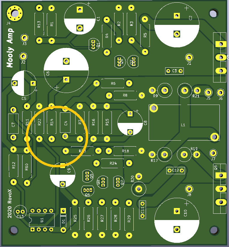

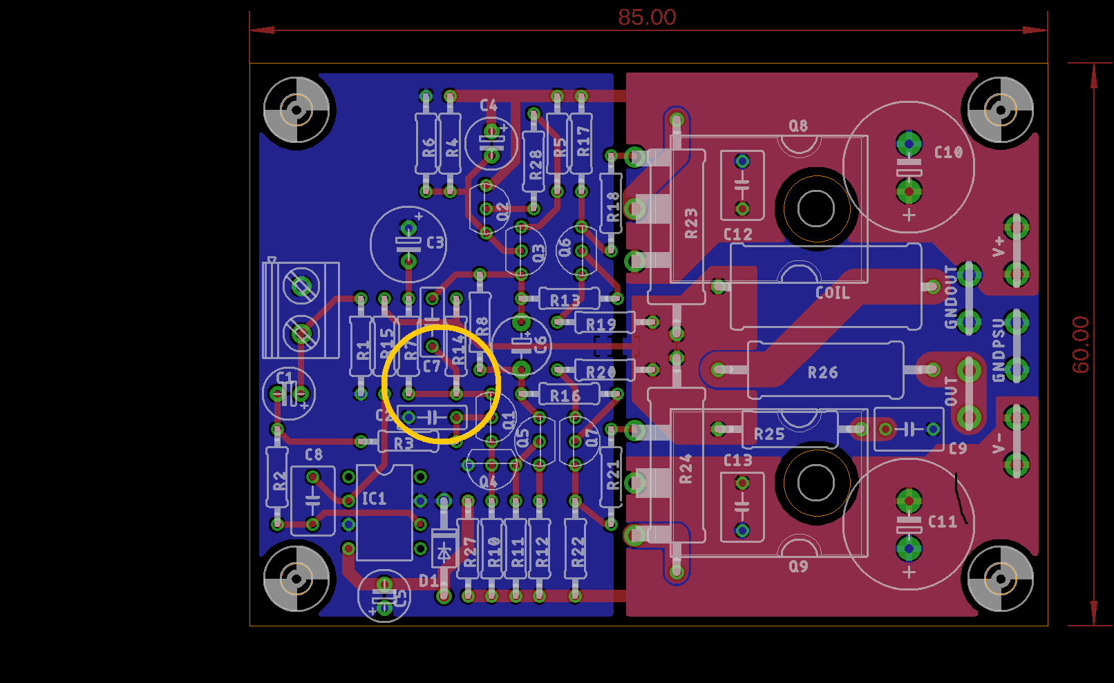

Major error?
I have just found out I may have an giant error in my PCB!
00940 did kindly share his fantastic layout and I did try to do my best to "steel" it, but it looks like I have made a huge error while trying to copy it.
I did use the KiCad schematic as foundation for my try, but as you can see in the orange circle, do 00940's layout (red and blue) have two resistors go in parallel, while in my try, do they not connect.
