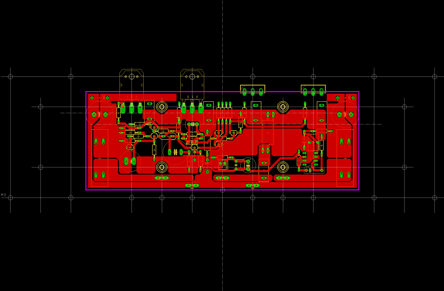

Oh thanks, that helped a lot, I did try to run a DRC on the schematic and it pointed at the spot with a missing connection thingy🙂
Originally had I used a standard (is there such a thing?) Mosfet component and when I changed to the right component, did I only rotate the component clockwise one time, move the lines a bit and did though I did reconnect them, but noooo, FAIL🙂

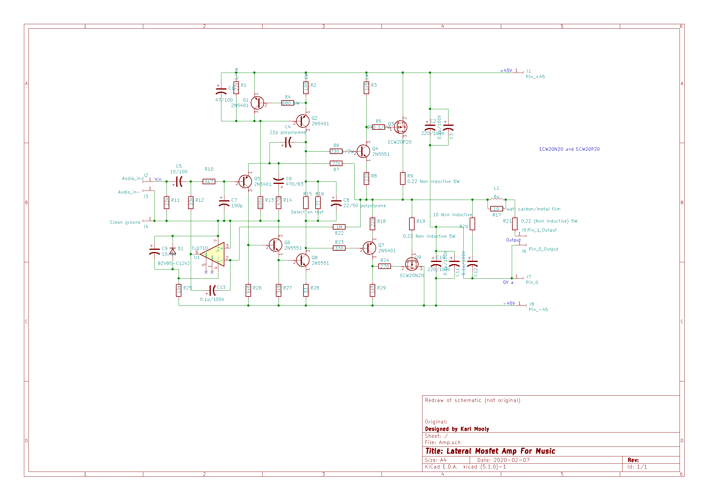

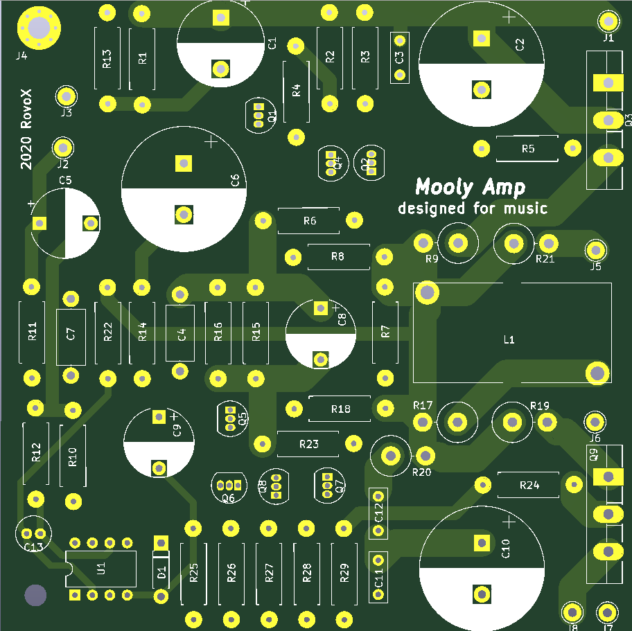

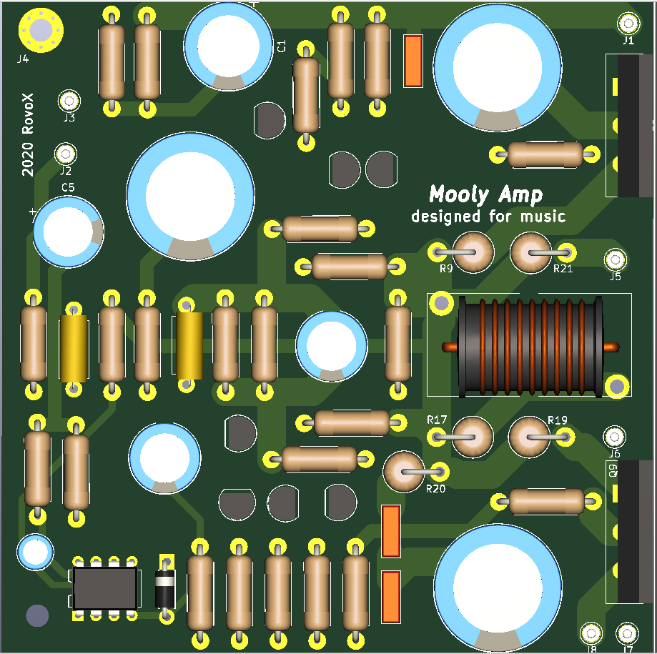

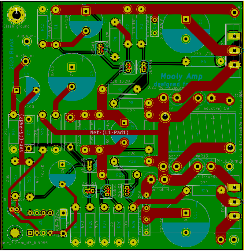

So finally do I think I have followed every of your advice's, hints and tips🙂
Until now has this been a lot's of fun and work, but I think I have reached the finish line. May I please ask you if you think that everything ok?

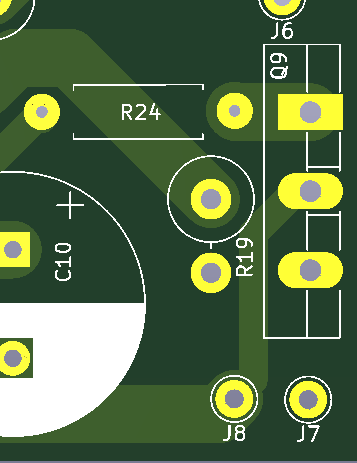

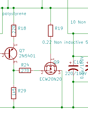

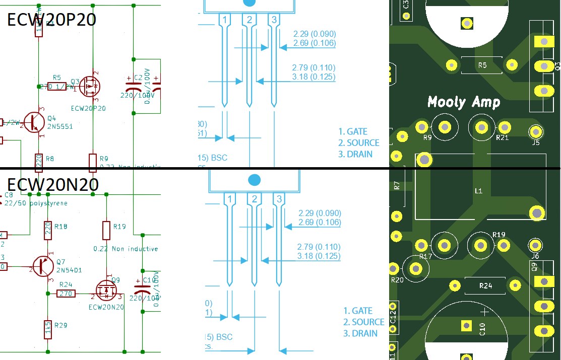

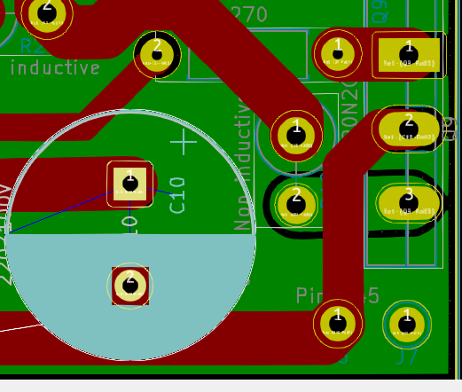

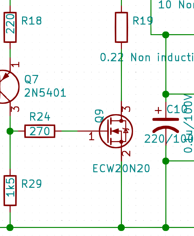

Q9, the lower N Channel FET needs to have pin 1 as the gate (correct), pin 2 which is the source should go to the negative rail (incorrect) and pin 3 which is the Drain going to the 0.22 ohm. So that pin is incorrect also.
Q3 which is the upper P Channel FET looks correct.
Great so pin 1 shall point upward.
So pin 2 and 3 shall be switched.
Ehm so eh so... pin 1 that was correct is not correct, because pin 3 shall be connected to the resistor that pin 1 is connected to?
Sorry but I am now confused🙂
Glad that Q3 looks correct🙂

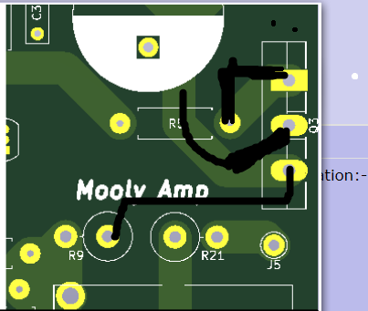

The board layout looks wrong for Q3 (the diagram was OK).
I'm assuming in all these that we are looking down on the board and so the gate (pin 1) is the top connection. The print is under the board.
It's easy to go cross eyed working with images... make sure they are correct 🙂

Wow! You've come so far in such a short time! :cheers:

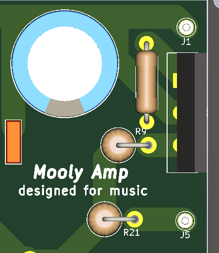

Just a couple bits, maybe 'for the next iteration' would be plenty soon enough:
The new position of R9 will probably be just fine. But as a general policy, having a little more space between Gate and Drain connections is better. The driven end (lower in the pic) of R9 is relatively low impedance so it'll be OK in this instance. The other end - connected to the Gate - is the trace that Mooly suggested to shorten -- the high impedance of a MOSFET input makes it too eager to receive signals capacitively coupled. Even though the 270R R9 will control it, the Drain pad can swing almost rail to rail.
While most electrolytic capacitors are polarized, most others are not. C13 could be either, by the value (larger values are more likely to be electrolytic), but the pics look more like an electrolytic has been specified. If so, the polarity is backwards: The inverting input of the opamp will be very close to ground; the other end (connected to the opamp output) will live a few volts below ground depending on the gains of Q6 and Q8.
You might also want to remove the polarity symbol from C7, C4, C3, C11 and C12. C8 is a special case: Having the '/50' voltage rating suggests electrolytic, which would be more likely for that spot in the circuit than 22 pF polystyrene. (22 uF / 50V electrolytic instead.) I read the earlier posts, but I don't remember -- worth checking?
Still, I am really impressed with how you've sunk your teeth into this -- an admirable undertaking -- and its looking darn fine!
