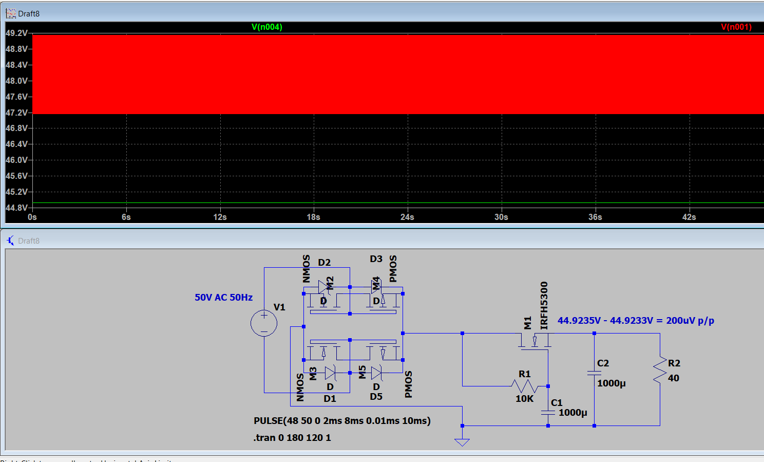

OOPS yes the negative rail do have the caps in wrong polarity.
About the D1 and D2 I meant to put them in the wrong direction, so the power goes trough the inductiors but let power run back when power is shut off, to avoid high kick back voltage.
Hmm yes the voltage drop is very high, but is it worth it? I am thinking more stable DC gives better "working condition" for the amplifier?
I did experiment with the FET bridge and have not tried it before, pleas tell the "story" 🙂
Thanks to Mooly did I find an error where Q8 were wrongly placed and I "stole" his configuration of the LT Spice schematic.
Since I am a noob I am of cause stumbled upon an thing I do not understand.
When the load is a 40 Ohm resistor, the Voltage output is nearly 45 +/- 200uV p/p, but if I replace the resistor with a LED 45V 10A, the output drops to 40V +/- 300uV p/p.
Why that voltage drop?

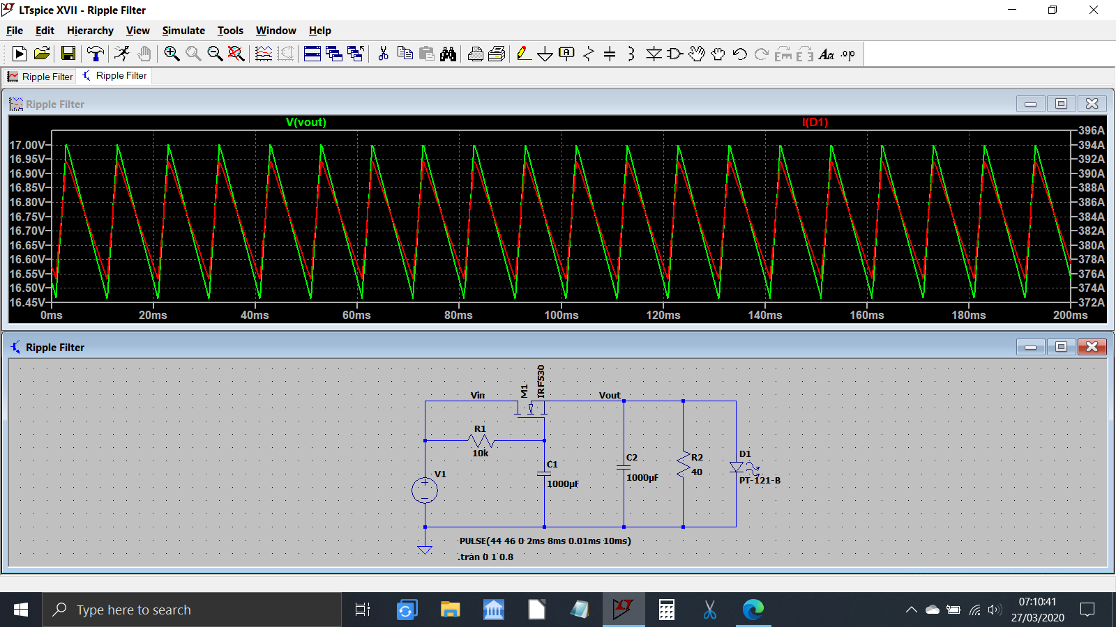

You can't just place an LED across a voltage source because LED's are not really voltage driven but current driven. This means it will effectively load the supply very heavily. A real LED would just get hot and fail, the LT model might not reflect reality under those conditions.
This shows an LED pulling the supply down to 17 volts, but look at the current on the right hand scale 😉
The FET bridge as you have it drawn is relying on the parasitic diodes within each FET. These are an unavoidable artefact of the manufacturing process and are not really intended to be used as rectifiers.
Some bjt devices do actually have intended reverse biased diodes across C and E and these were often found in line output stages of old TV's and the like where they handled and clamped the high energy negative going flyback pulse from the LOPTX (line output transformer).
Just use ordinary diodes for the PSU plus a snubber either across each diode or a single snubber across each secondary winding. Use something like a 0.1uF 250V film cap and a series 2.2 ohm 1 watt metal or carbon film resistor.

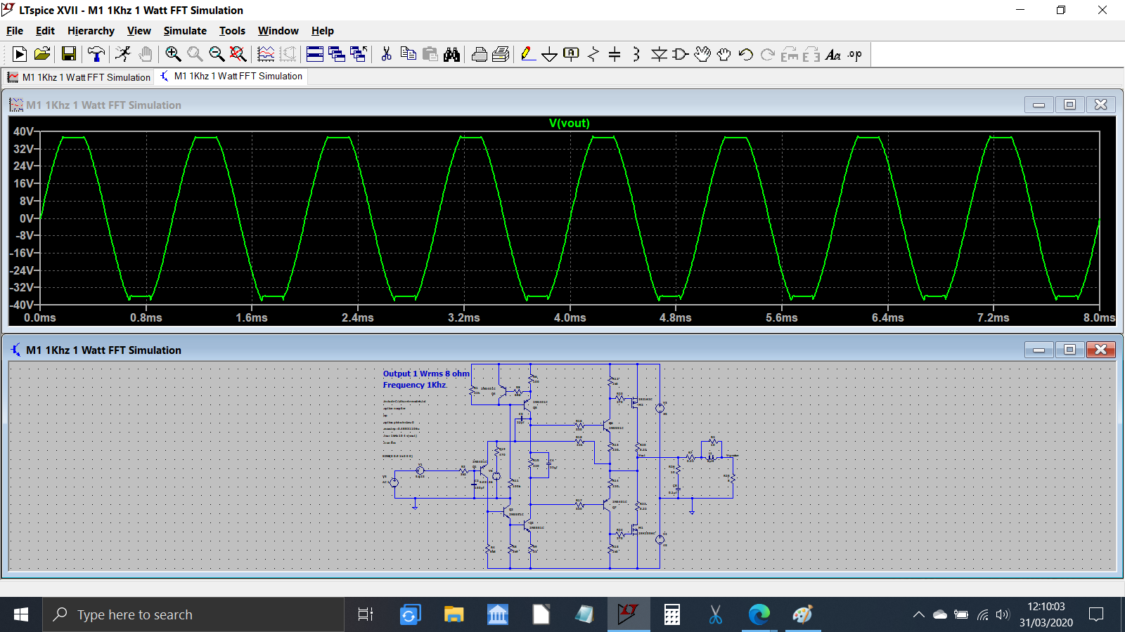

The voltage rails determine the maximum voltage that can be developed across the load.
So we start with -/+45 volts DC which means that a grounded load (the speaker or test resistor) could never see more than +45V or -45V across it at any given moment in time.
(The speaker can not see +45 at one end and -45 at the same time because it is a grounded load. It is one or the other).
So if a sine wave peaks at +45 volt at the top and -45 at the bottom we have a voltage across the speaker of -/+45 volts peak to peak or we can say a singular 45 volts peak.
Both are taken to mean the same thing.
So 45 volts peak multiplied by 0.707 gives a voltage of 31.8 volts and that is the rms voltage.
So we can deliver 31.8 volts rms to a load.
If the load is an 8 ohm resistor we get a power of (31.8*31.8)/8 which is 126.5 watts rms.
If the load is 4 ohm that doubles to 253 watts rms and so on.
The practical amplifier of course can not deliver that power because of a few limitations. One of the main ones is that the FET's have a relatively high 'on' resistance and so they 'loose' some of the 45 volts available across the FET, even when fully on. That reduces the available output quite a bit.
The simulation shows it clips at around -/+36 volts output when running into 8 ohm loading. That gives a power of (36*0.707)/8 which is 81 watts rms. I would say in practice you could say it is a 70 watt rms/8 ohm capable design.
The 0.707 multiplication factor is the same as saying divide by root 2 (which is 1.414)
This shows clipping point of the amp.
