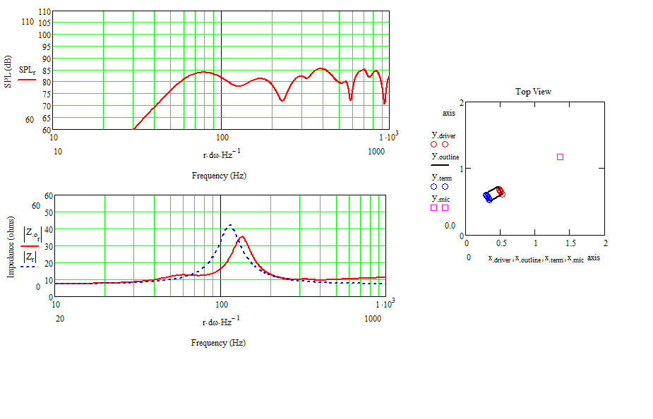

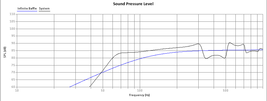

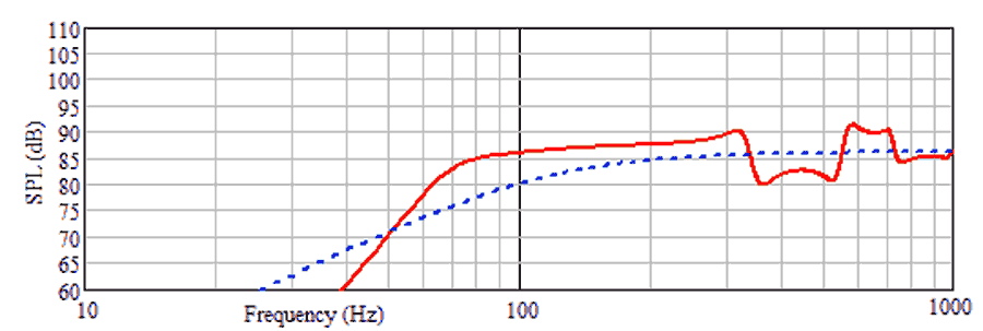

sure, here is the original sim from mathcad and the one I've done in the new software. Not 100% identical but pretty much the same.
One of the nice features of the Leonard audio software is the ability to save driver files and enclosure designs allowing easy sharing of designs for others to play with.

There's always going to be some variation, especially when it comes to damping & the differences between types &c.
One point I should mention that you don't necessarily pick up from the graphs etc. is that the alignments I use are usually related to the driver's inherent response (as separate from the T/S curve) which is one of the many reasons I don't like shoe-horning drivers into boxes designed for something else. In this case, it's quite forgiving, fortunately, and the unwanted harmonic modes in practice will be rather less due to the folds.
I like Pete's software -very impressive so far. Shame Martin felt he had to call it a day, but what with the changes to MathCAD & other wider issues, I don't blame him.

Pete's stuffing assumptions are grossly different from Martin's. If you are looking for a 1-1 comparison, set stuffing to zero.
General comment about both models: Modeling BR's produces quite different results from the T/S box modeler's. They tend to ring at cut-off. I have not attempted any investigation, just saying....

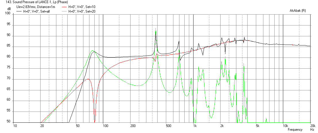

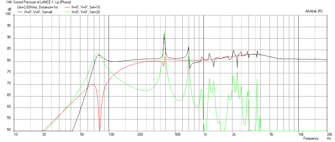

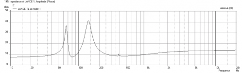

Here is what I get with Akabak - it seems to differ with respect to where the resonance dip and bass peak is and also the falloff in the LF. I wonder if it is because I am treating the actual vent radiator as located in the back offset vertically and rear firing? There is a baffle step loss as expected for a narrow 5in wide baffle that if compensated for, results in about an 80dB sensitive speaker. The results are very flat and IMO, an excellent design for the FF85WK. Sticking other drivers in such as 3FE25, and random Tang Bands will not result in as nice of a flat profile.
Here is response without BSC in 4 pi space:
Here is response with 6ohm and 0,8mH BSC circuit:

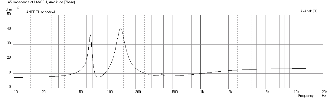

Here is Impedance:

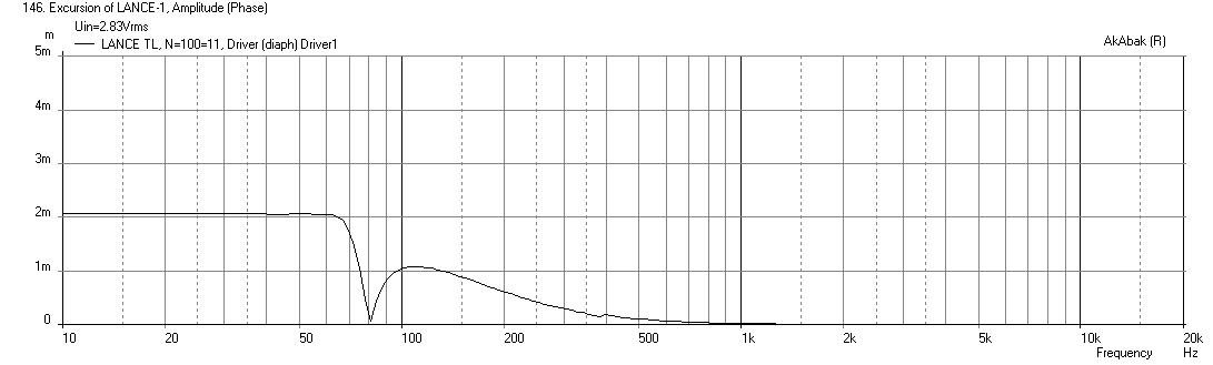

Hers is cone excursion:

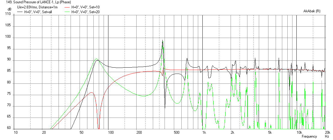

Edit - Here is the response modeled without any consideration for physical locations of driver relative to vent, or reflections or baffle diffraction/losses:

Possibly; also the fact that there's no damping in the AkAbak sim.
I usually only post co-incident plots on the forum to save time; for simple boxes they're ~'good enough' for an anechoic representation. Under practical conditions a shelving filter for step loss shouldn't be needed and I do not recommend adding one. It's a micro-monitor intended for use on desks or relatively close to boundaries; for e.g. as shown. The null at ~225Hz is floor-bounce; you can also see the effects of the higher harmonics that are killed by the two major bends (I haven't shown the effect to save time) and the specified damping -Martin's worksheets tend to understate the effects on higher frequencies in my experience / measurements -most likely due to variations in damping materials. As always, you can make this look pretty much however you want via placement, angle, furnishings etc., so YMMV as ever. To be honest, I'm rather fond of this little box -it's a nice performer for what it is (if I do say so myself) & the feedback has been positive.

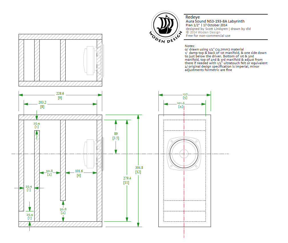

Has anyone designed a TL cabinet for the Aura NS3-193-8A1. Something for a bookshelf application like the Lance or Harpoon.
I have a pair that are looking for a home and unfortunately I can't get my poor worn out old brain around all the math and sims that your guys are so good at. 😱
Since I was feeling benevolent (and already had a design roughed out which was in the ballpark for the Aura, so it didn't need much in the way of changing 😉 ): Redeye. The drawing is not to scale BTW; for simplicity & to save time, I simply used the Lance drawing Dave created & changed some of the text to suit.
As a general note, I favour the Lance design. In my opinion, the 85 is currently the pick of the drivers in this size bracket. Doesn't have quite as much on the bottom end as some, but these are 3in drivers we're talking about, so these things are relative. 😉 Not the cheapest to be sure, but it's worth it.
