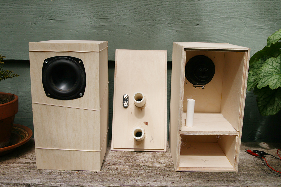

Yes. They sound great! Unfortunately, I have removed the drivers so I can finish the varnish on the cabinets.
This is my first set of DIY speakers. The other set I have in the house is an old Epicure 14 pair from my father-in-law. The Epicures obviously have more bass "oomph." The Lances sound noticable better everywhere else (significantly more clarity in the high-mids and highs).
They also go loud enough for computer/bedroom speakers. They would certainly struggle in a large room.
All told, fantastic sound and surprisingly good bass from a wee little driver.
Currently I am using Fostex's little 5 watt amp to drive them. I also have the Fostex grills on them. I have five children ages 0-8 and do not want them poking on the cones and dust caps.
I can post a finished picture once the finish is finished.

They sound great! Thanks so much for the plans. These are my first diy speaker so I cheaped out bt buying 11mm poplar plywood because I wanted to practice my woodworking skills. I had to make the sides slightly smaller. I dont know how different would it be from the 12.7mm but it sounds great to me. All in all turned out not bad.
I am surprised by the bass quantity from a small driver. Really tight bass too. I will get much enjoyment out of these. Next I think I will build another set and then after the practice build the Valiants.
Thanks again to you and Dave. Highly recommended speaker and easy build for starters! 🙂

I really like the looks of this cabinet. Does a similar but larger version exist for the FF105WK?
Indeed, with appropriate dimensions the labyrinth topology avails itself to a wide range of drivers, the 105 among them. I just have trouble remembering the names of each, or whether the drawings for the expanding range of drivers have been collected and posted in common library.
