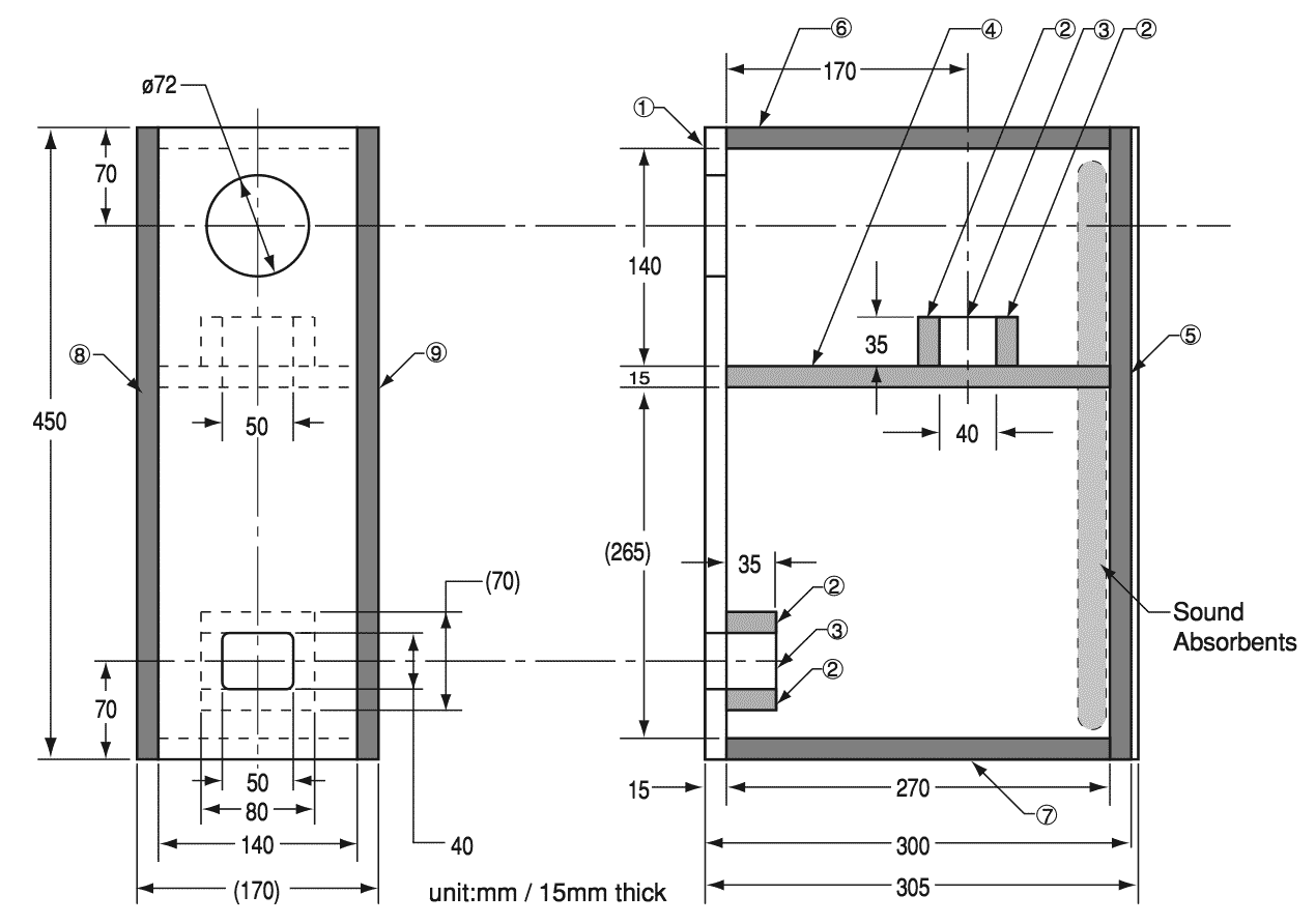

... maybe a play on the pretty darned decent Fostex FE83En DBR
The Fostex box has the smaller chamber 1st with 2 vents total so quite a different box.

Well, sweet. Of course 3"ers making low bass does have a soft place in my heart... that the harpoon design in particular pierced. I'm pretty intrigued. The low bass control of the ff85k is awesome with the symmetric voice coil lead wires. So by comparison to the old Fostex FE83 DBR (for what was actually the FE83E), I bet that this harpoon design has alot more to offer for low bass control from those old days. So add a decently powerful amp to drive the low frequencies out from the 89db eff FF85k cone and you've got something there.

Yes, the driver position on the "Lance" family of TLs is rather important - Dave should have by now have drawings that indicate such
My own working shop drawings certainly do, but they're on PC at work
Hey Chris or Dave,
Can you please post what the vertical position is for the driver. I used the mighty pen and ruler and I believe it would be 2 1/4" but want to make sure of this value since it is important
This looks like a nice simple build for present. Thanks!...dave

I couldn't find my own as-built drawings, but that sounds about right - of course it wouldn't take much for Dave to put a tape measure on them and subtract the thickness of construction material
The same format design for Alpair 6 and FF105WK would of course have several different dimensions.
