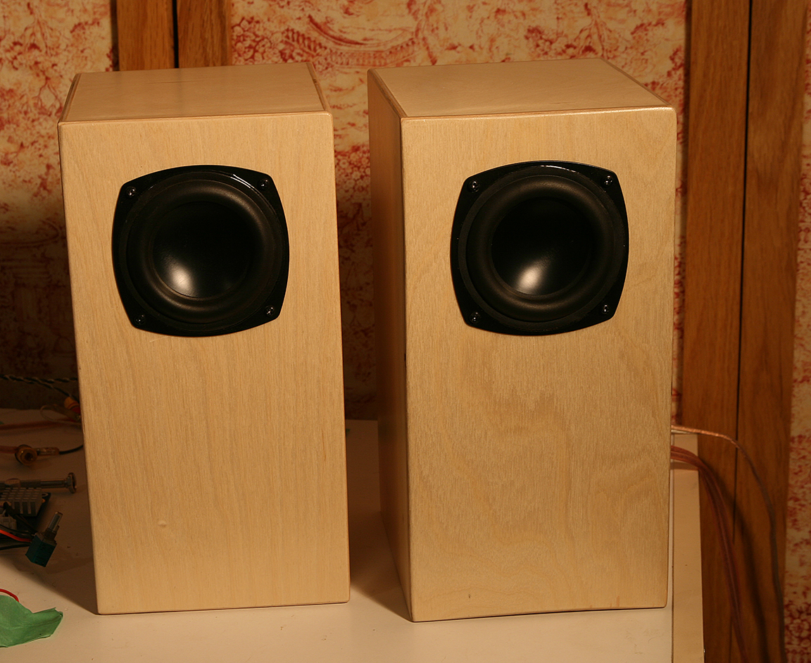

Hi Scott- First let me say that I would never blame you for any of my poor build attempts. I have far too much respect and admiration for guys like you and Dave who give your time to help guys like me with my retirement hobby.
The harpoons are completed with the Aura NS3-193-8A drivers. To my poor old ears they sound great. I have been playing them with a couple TPA3116 amps and am very happy.

Thanks guys. Baltic birch ply is great material to work with. I can get it here in 15x30" pieces in every thickness from 1/8 to 3/4"

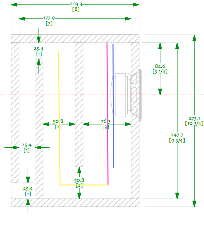

Hi All,
I'm trying to model the lance for a couple of different drivers. Currently trying the Leonard audio software but may switch to the MJK worksheets in due course.
Anyway, I have a basic question about how to measure the length of the different sections from the diagram.
For the first section (the 76.3mm section) in the attached image should the length of the section extend to the bottom end of the blue or the pink line?
I assume probably the pink line and then the next section length would match that shown by the yellow line.
Can anyone confirm this for me?

I've always taken it that you measure the length of any line / horn at the center of each section / fold. So by my quick cocktail napkin calculation, the total length of the 6 sections (assuming 1/2" material and including port) would be approx 805mm = 31.7"
Keep in mind that Scott's designs are specifically modeled for each driver's TSP, and that regardless of the software used, there may be special / propriety factors and targets in his calculus which some folks might overlook.

Thanks Chris, your total line length matches my calculations so that's a good start 🙂
Unless someone else chimes in I'm therefore going to go with the length of the first section as being approx 222.3mm long (the pink line in my drawing) with the 2nd and 3rd sections being 285.1mm and 297.8mm - assuming 3 sections with differing areas.
