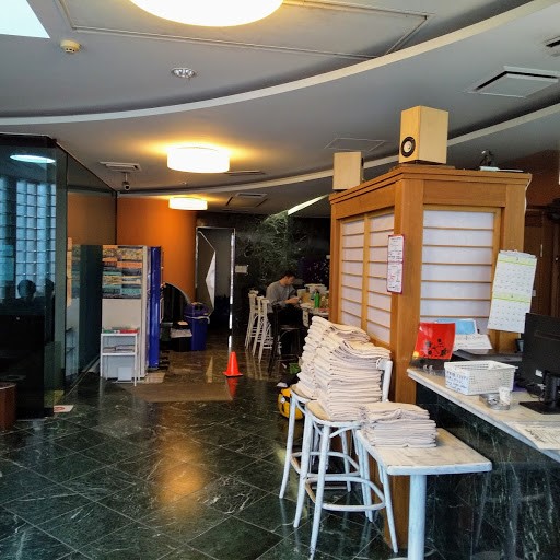

I put my speaker at backpackers hostel lobby but there are no bass.
There are not much space for speaker so I would like to build Lance TL enclosure. I only understand how to decide total length but no idea for width,volume.

tamra,
A few points:
- The position you have placed the speakers in - you are unlikely to get bass. Try placing them on the desk and closer to the walls, with drivers closer to ear level when you are seated
- The FE88-Sol cone area is not large, so it is unlikely that you will get a lot of bass out of the driver. A better designed cabinet can add some more bass performance, but do not expect too much powerful bass from a modestly sized driver.

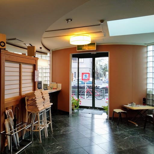

I know there is not good place for speaker. But there are only place I have got.
This is for back ground music like coffee shop so
I dont really expect big bass sound. I just want little more bass,also I would like to try something TL speaker. And I want to put speaker upsidedown and make port head to upside.

In that room and with those speaker positions, I don't think you will get much bass.
Probably something like one or two W6-1139SIF ported or PR subwoofer cabinets alongside the existing speakers. Or build something with the Dayton SD215A-88 or a similar dual voice coil or 4 ohm subwoofer. Would probably need a TDA7498 subwoofer amp to run it sensibly..... Or just a 2 channel TDA7498 if you run two 1139s.

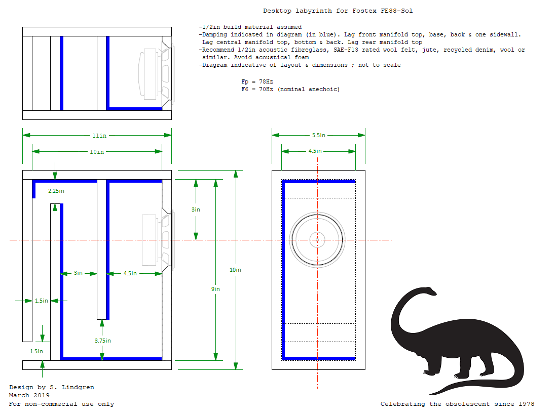

FE88-Sol… so I would like to build Lance TL enclosure.
A lovely driver. I did up a pair in blue with white spots. Client put them in FH-Lite IIRC/
Lance is for FF85wk. I’ll poke Scott to see if he can whip up a baby lab for the SOL.
dave
Still snowed under with work, but a one off for the FE88-Sol. Note that a QW variation does not automatically equate to more LF output or extension than a different form of vented enclosure. Diagram is a bowdlerised one of Dave's; dimensions are accurate, scale isn't.
