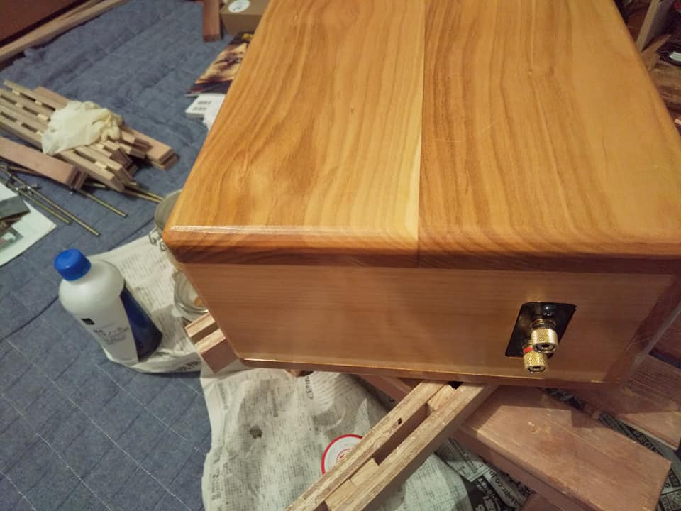

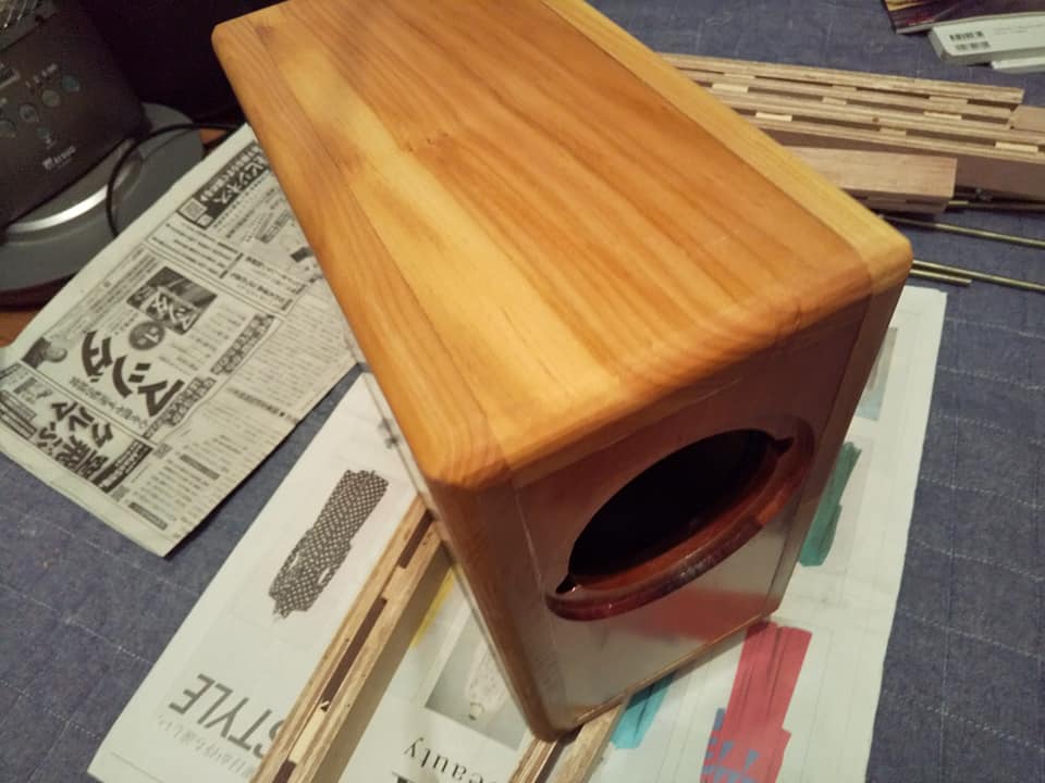

Tamra, you can also use linseed or Tung oil for great results. I use wax and polish them after the application of oil.
Thanks stormfrontier.
Oil and wax looks nice.
But I afraid that solid wood warps for dry and humid air condition.
So I am thinking to seal them.
Make sure you seal both sides of the boards to avoid warping. If you do it before assembly make sure you tape off any edges that will be glued prior to applying finish. If possible, wait until the cabinet is almost together and then apply finish. Either way, you don’t want finish interfering with an edge that will be glued; otherwise the glue joint will be weak.
Wipe on polyurethane is a pretty good varnish and what I generally use. You can wipe it on with a rag, it goes on thin so it shouldn't leave brush marks like standard polyurethane or other non-wiping varnishes. Wiping varnishes have been thinned to make them easier to work with, which means you will need to apply many coats. About 3 coats of wipe on is equivalent to 1 coat of standard. Usually you can apply 3 coats of wide on poly in about a day though, and 3-6 coats should be enough for something like a speaker (you pay want 9-18 coats for a high use piece of furniture like a kitchen table). Be sure to get a good mask (with a gas vapor filter) to wear when applying poly/varnish, and do it in a well ventilated area of course.
With poly or most other varnishes, they cure hard so you can build up a film. This protects and seals the wood much better than oil finishes.
Linseed/tung oil based finishes are easier and more pleasant work with, but they cure soft so they do little to protect the wood and let more moisture in. Limseed/tung oil are poor finishes on their own, so most products that claim to be some sort of oil finish (like Watco Danish Oil), are a mix of tung/linseed oil, varnish, and chemicals to make it dry faster.
As mentioned, be sure to finish the inside of the cabinet as well, this will prevent moisture transfer from happening at different rates, which tends to warp wood. It's a good idea to do all the cutting, gluing, and sanding before applying any finish. Make sure that if there is excess glue, that it is scraped off and sanded down to the point where it no longer makes a stain on the wood's surface, even a small amount of glue stain left on the surface will show up when you put the finish on.

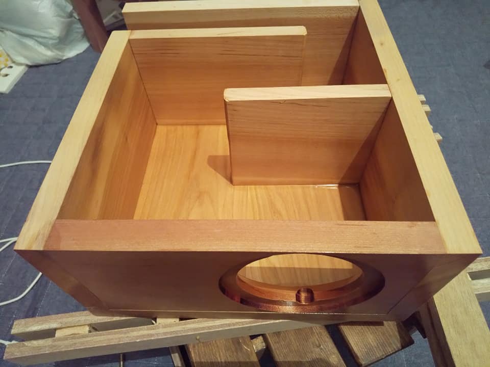

Tamra my biggest concern building all solid would be the 2 panels glued cross grain . A good idea would be to choose the more quarter sawen panels here to reduce the constant stress on these joints.
Shellac is my go to finish for such as interior finish it has good properties regarding moisture transfer and goes on and dries fast.

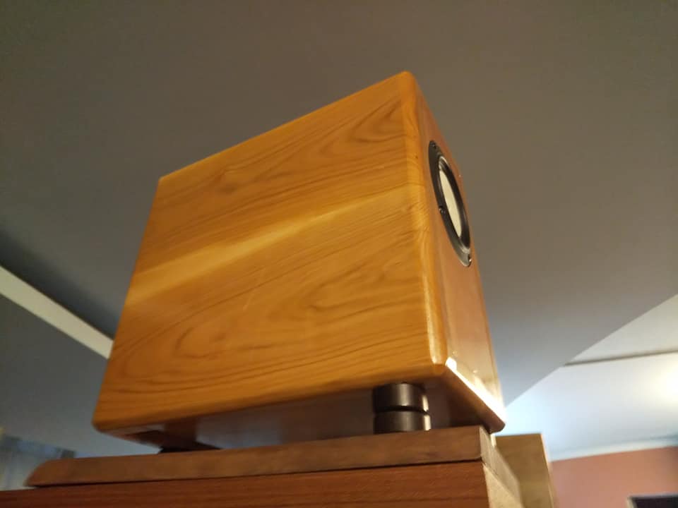

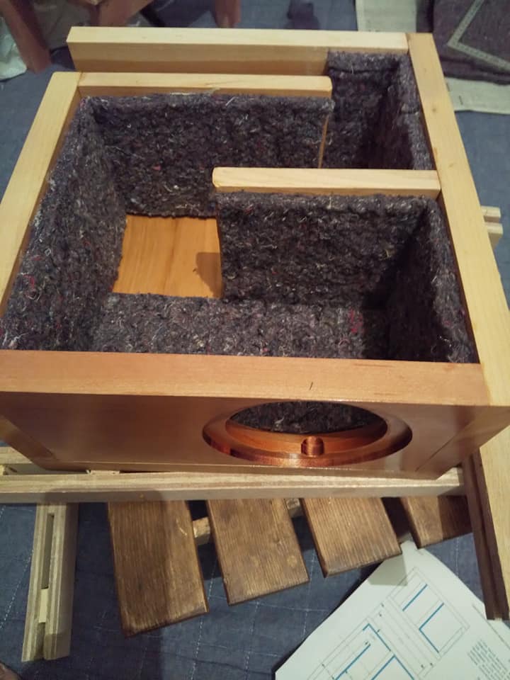

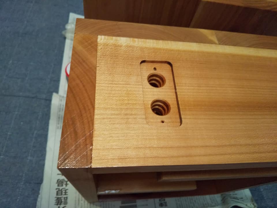

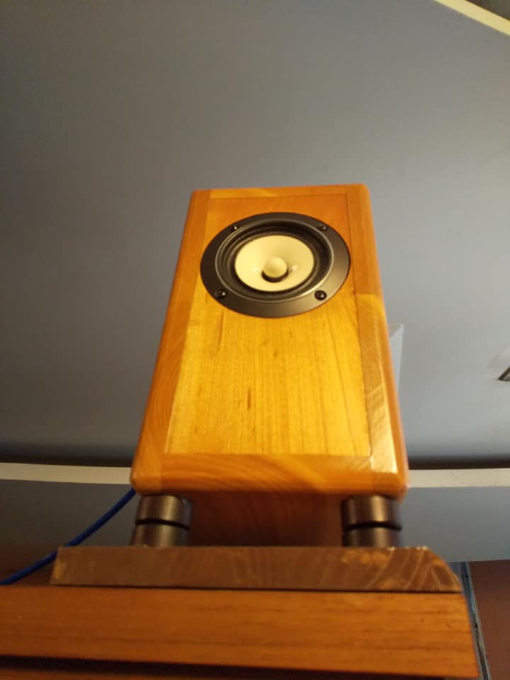

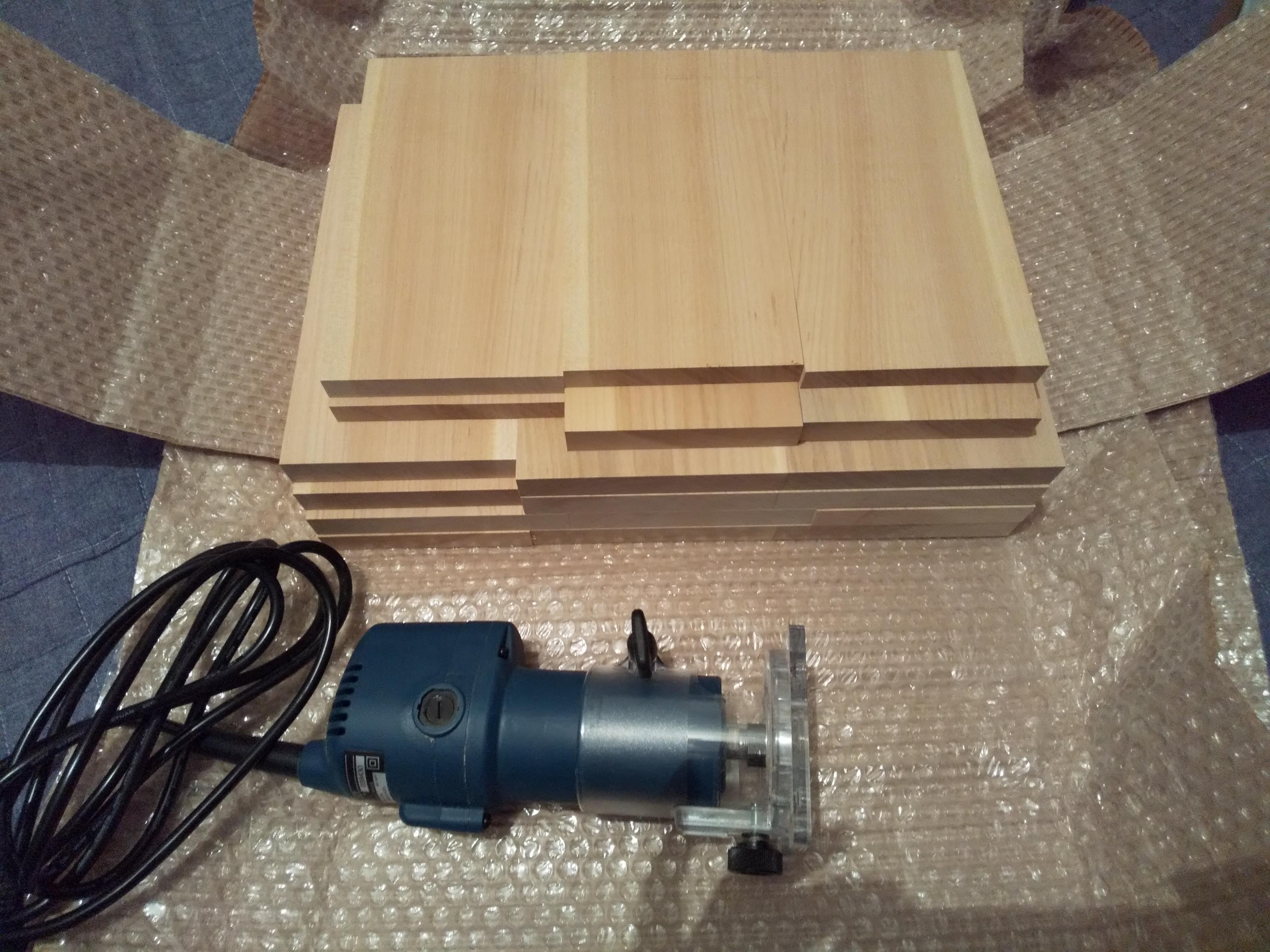

Thanks for advice Joe and Paul. Actuallyi I just noticed.
And Big thanks Scott!!
The sound is amazing😀
I don't have garage so I used shellac.
Painted 5 times both side. I think its thick enough.
I have met Danish carpenter then he taught me proper french polish
so Its beautifully done.
Glue is "Tightbond genuine hide glue".
Longer assembly time for beginner.
But always I get gaps...Its not easy.
After few hours listening, Why this speaker sound so good?
Because good design? Solid wood?
Oh I need one more speaker for my room.
